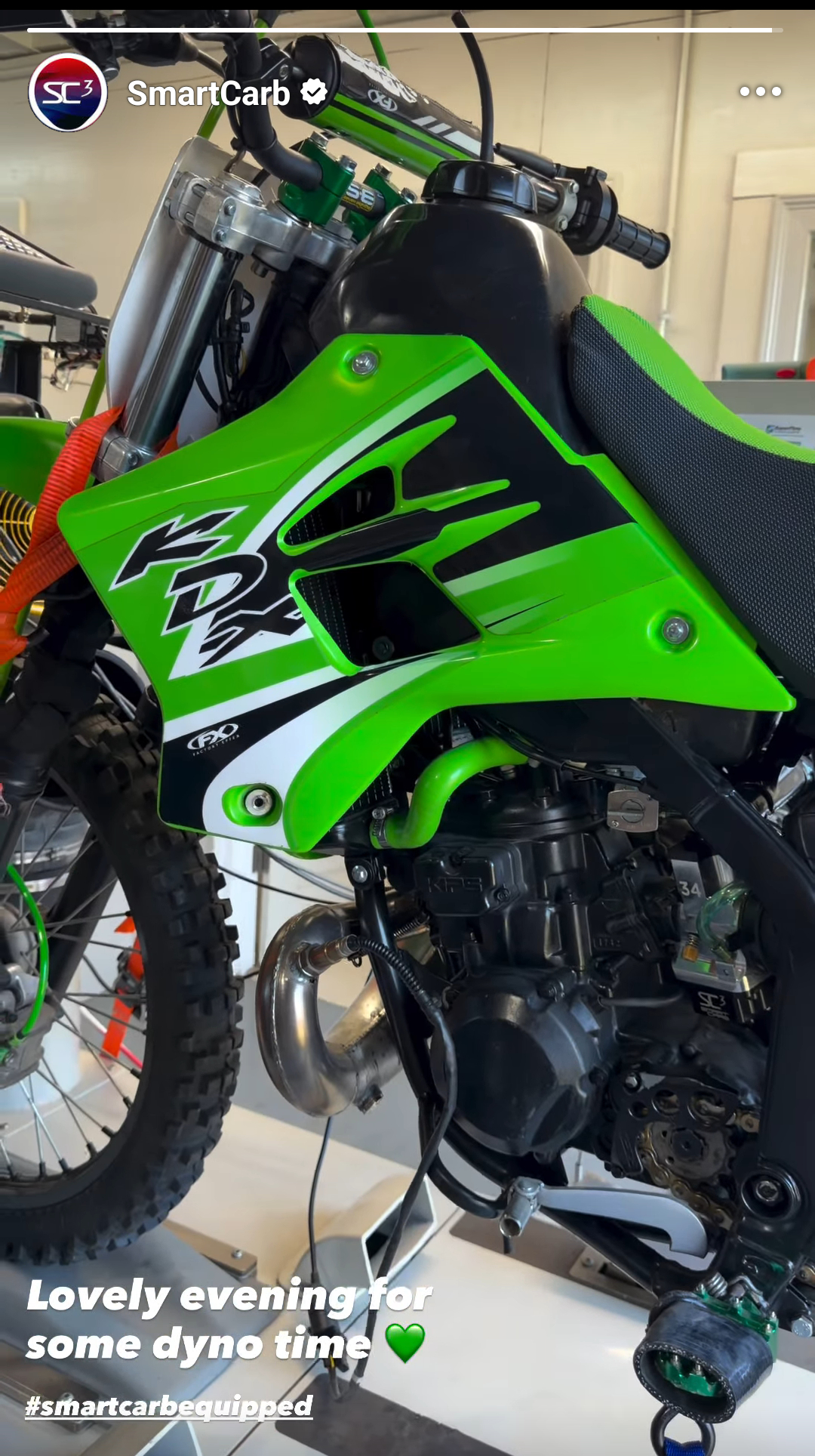

Update - these carbs should be available for our KDX200 & KDX220 applications by the end of January 2026, just a few weeks away!
They are dyno testing them currently, to get their settings dialed in just right...
Nathan Dyess - info@SmartCarb.com wrote: "We are within a few short weeks of having a SmartCarb kit ready for both KDX bikes, 200 and 220. As you know, the issue hasn't historically been the metering rods but rather the fitment - our best seller, the 36mm, is physically too large to fit without hard frame contact. As such, we've been waiting until the release of our 30, 32, and 34mm model SC3s - the 34mm size being targeted toward the KDXs to replace the stock 35mm Keihin.
That Keihin is an odd carb as far as external dimensions, but we've designed our 34mm to fit the exact same as it along with the VM and TM 34mm carbs in other applications.
See attached pic of a KDX 200 we have in-house for dyno validation these last few days.
We'll reach back out to you in the next few weeks once we're ready to launch the new sizes with solid tuning baselines.
Best,
Nathan Dyess
Information | SmartCarb Fuel Systems
Office: (816) 255 2328"
It looks like they're using a Yamaha WR250 4-stroke fuel petcock on that KDX200, although that may be unrelated and may have already been a prior upgrade done by the bike's owner, however, the Lectron Billetron Pro Series carb that's similar size did not play well with the massive stock KDX OEM petcock, and the bottom outlet Yamaha YZ250X 2016 petcock allows the aftermarket carbs to fit far better with no petcock issues. The WR 4-stroke 2000's model, NOT the WR250Z 2-stroke petcock which is actually the same as the 2016 YZ250X petcock) , may work well on KX125 / KDX200/220 hybrid builds with the rearward facing side outlet vs the YZ250X bottom outlet.

Teaser vid scrrenshots on SmartCarb's social media stories mid-week:
