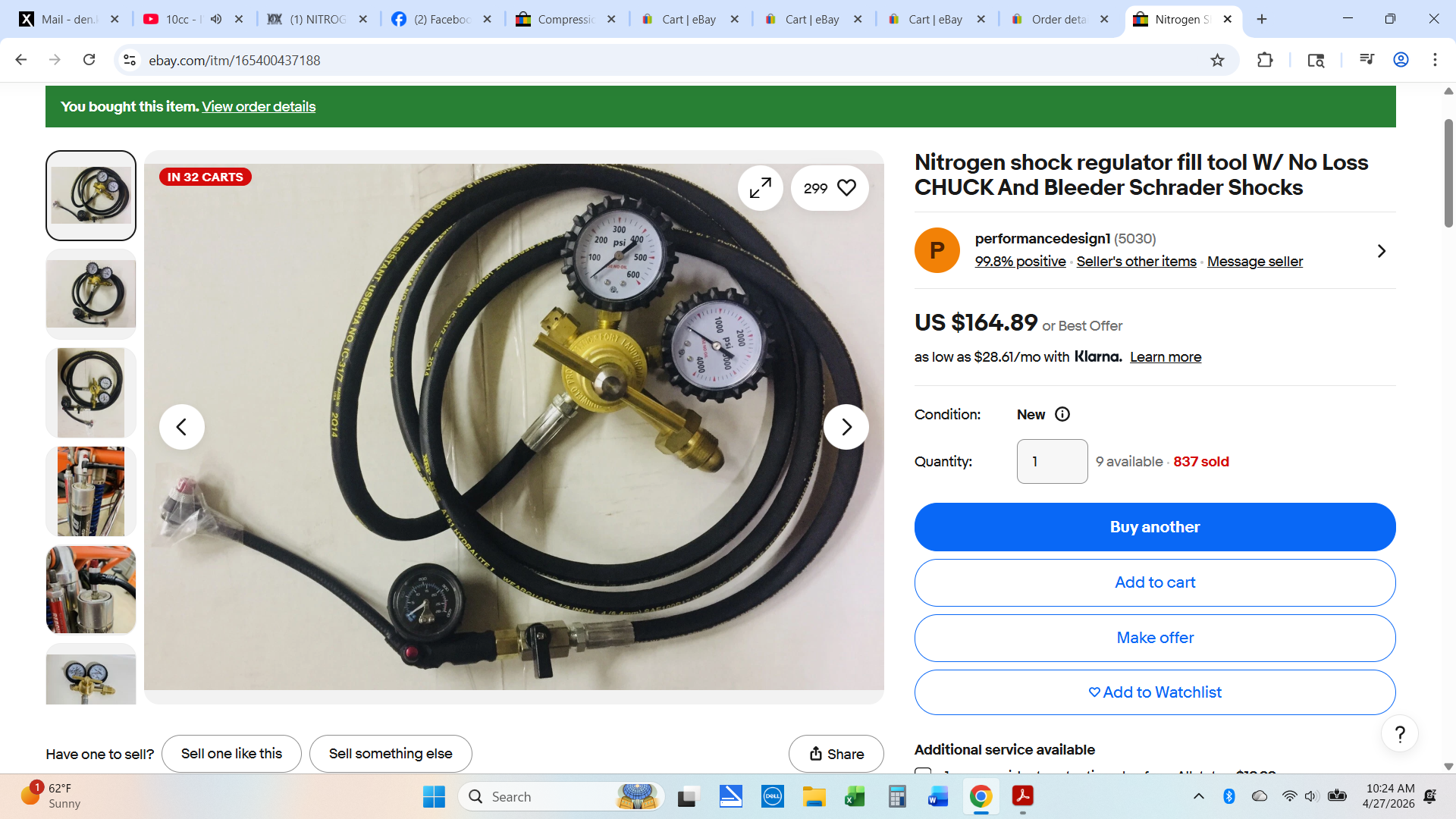

To get it done really well on many shock models requires a vacuum pump and bleeding setup to bleed it quickly and fully, but it's not mandatory the majority of the time. A hand operated vacuum pump and a DIY adapter can do similar.
A basic nitrogen charging setup with a no loss type air chuck can be bought fairly affordably, and on KYB shocks with a bleed port on top, it's really pretty easy to purge all air out of the oil, so the nitrogen fill / regulator setup plus a small nitrogen tank is all you really must have.
Something like these with a no loss chuck is what you need, plus a small nitrogen tank (welding supply store) and regulator.
https://www.ebay.com/itm/196543676309
https://www.ebay.com/itm/167701426648
https://www.ebay.com/itm/165378066486
I have almost the same setup here (1st link), and a hand operated MityVac Silverline Elite vacuum pump. I've thought about making a pro bleeder setup using my HVAC vacuum pump, but like I said, especially with the KYB shocks with a bleed port like the '95+ KDX's, a vacuum pump is not required.

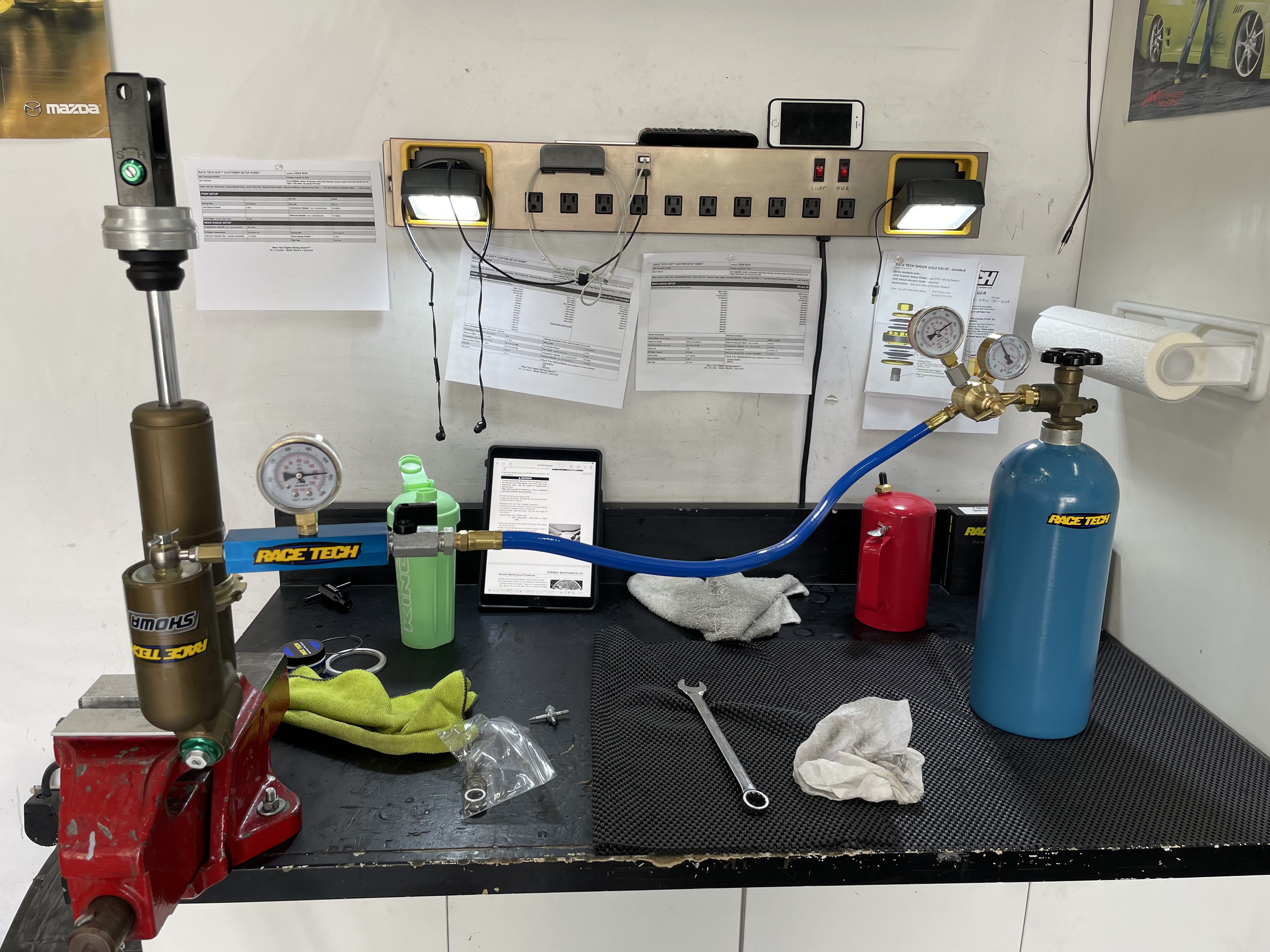

I built my own setup. Machined a manifold from aluminum and anodized it. Lossless chuck is a have to have. Regulator and gauges can be found at any welding shop. That little tank lasts me a LONG time. Probably 100 shocks or more.

Slick_Nick wrote: 10:13 am Mar 04 2026 I built my own setup. Machined a manifold from aluminum and anodized it. Lossless chuck is a have to have. Regulator and gauges can be found at any welding shop. That little tank lasts me a LONG time. Probably 100 shocks or more.
Nice work there, Nick!
Also, that's one heck of a wall mounted shop power strip, with two fold down spotlights built-in!

Costco special!Chuck78 wrote: 07:13 am Mar 05 2026Slick_Nick wrote: 10:13 am Mar 04 2026 I built my own setup. Machined a manifold from aluminum and anodized it. Lossless chuck is a have to have. Regulator and gauges can be found at any welding shop. That little tank lasts me a LONG time. Probably 100 shocks or more.

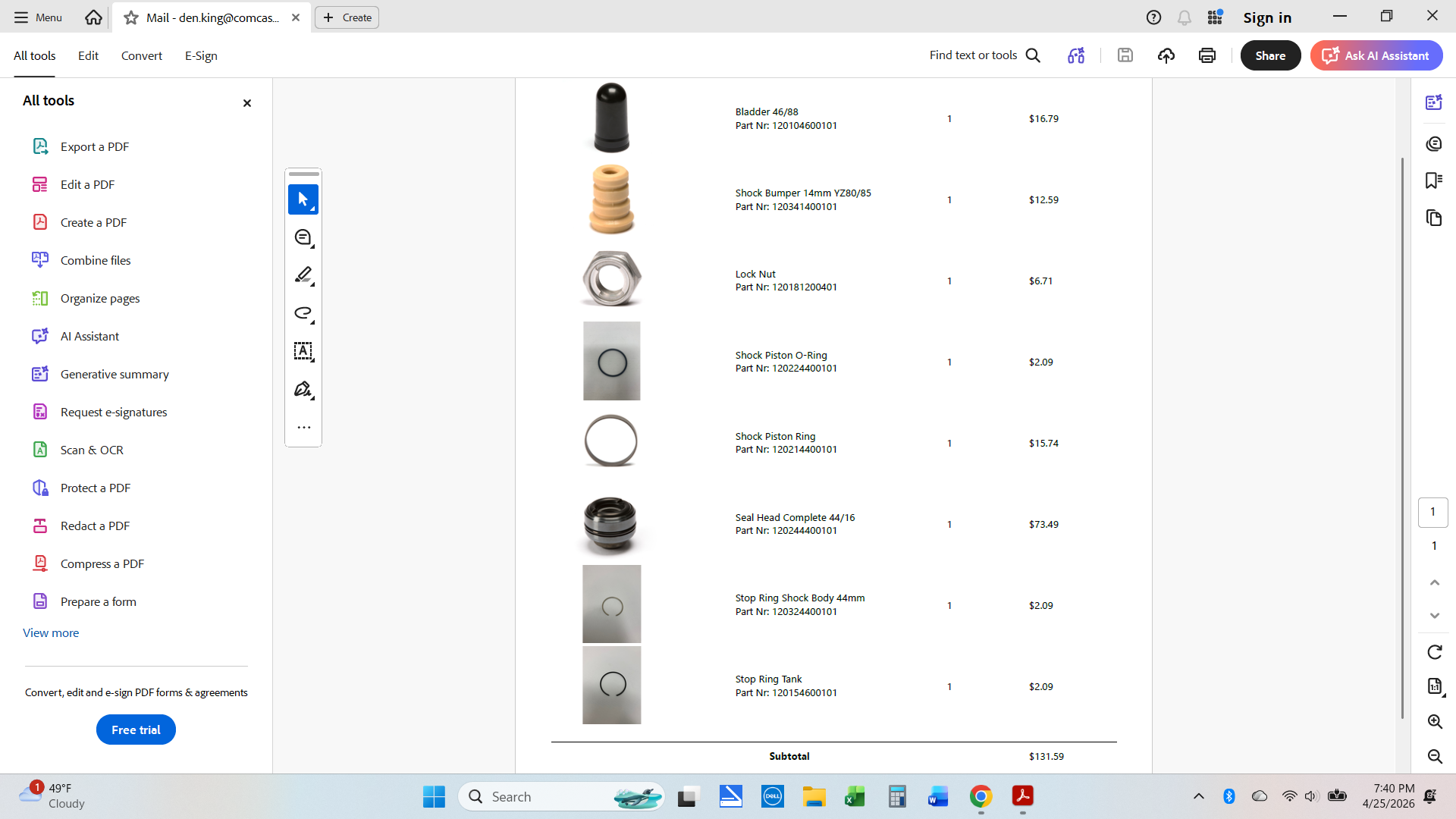

After a hiatus I'm finally back to the shock project. This is what I will be ordering from Partzilla for the shock rebuild. Does anyone have any feed back regarding the quality of any of the parts or if I am making any mistakes? Thanks in advance!!

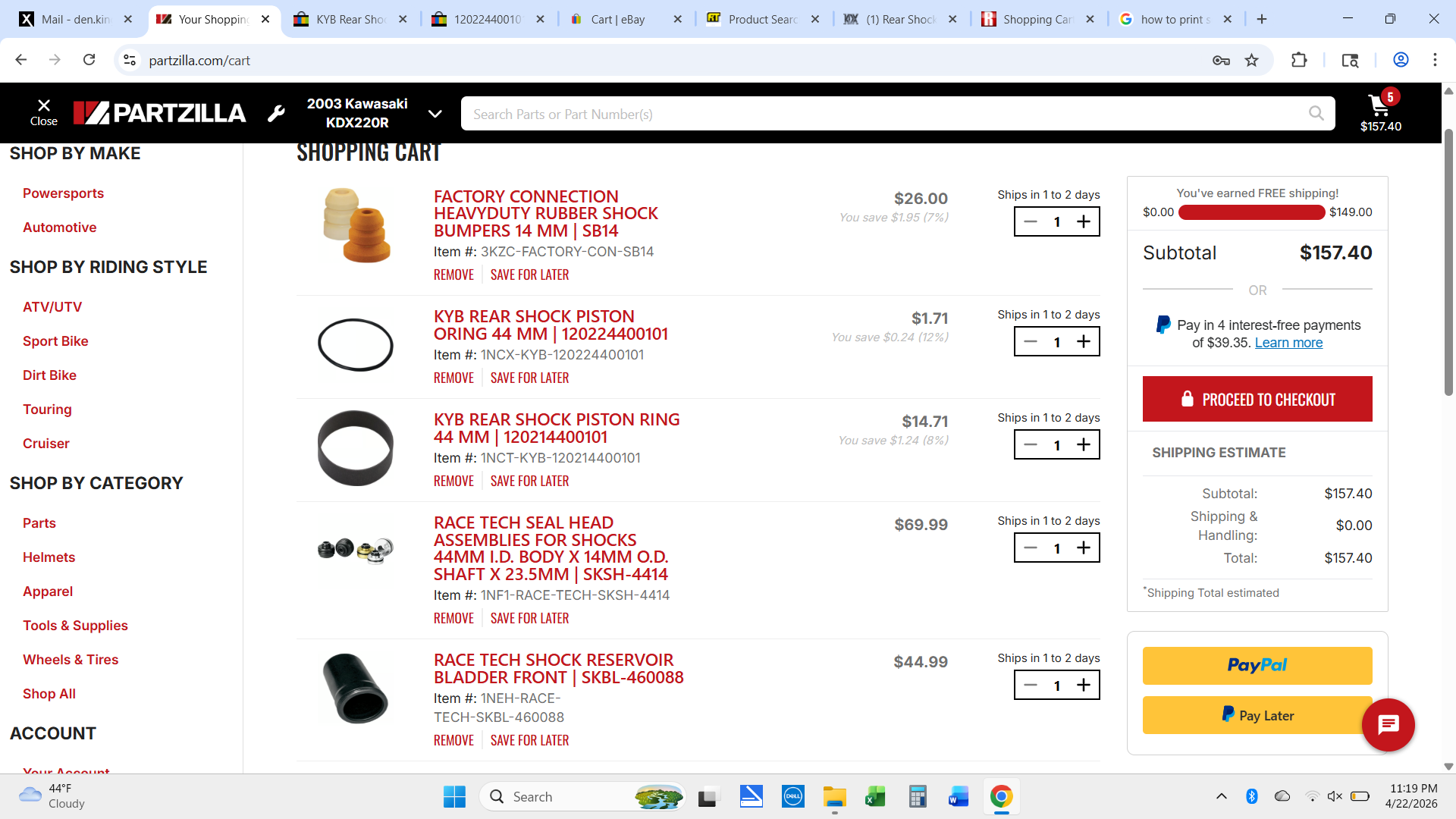

If USA, I would check on Technical Touch USA to see what they have. That is high for a bladder and a little high for a bumper.

bladder PART # 120104600101
bumper PART # 120341400101
nut PART # 120181200401
piston o-ring PART # 120224400101
piston band/ring PART # 120214400101
seal head PART # 120244400101

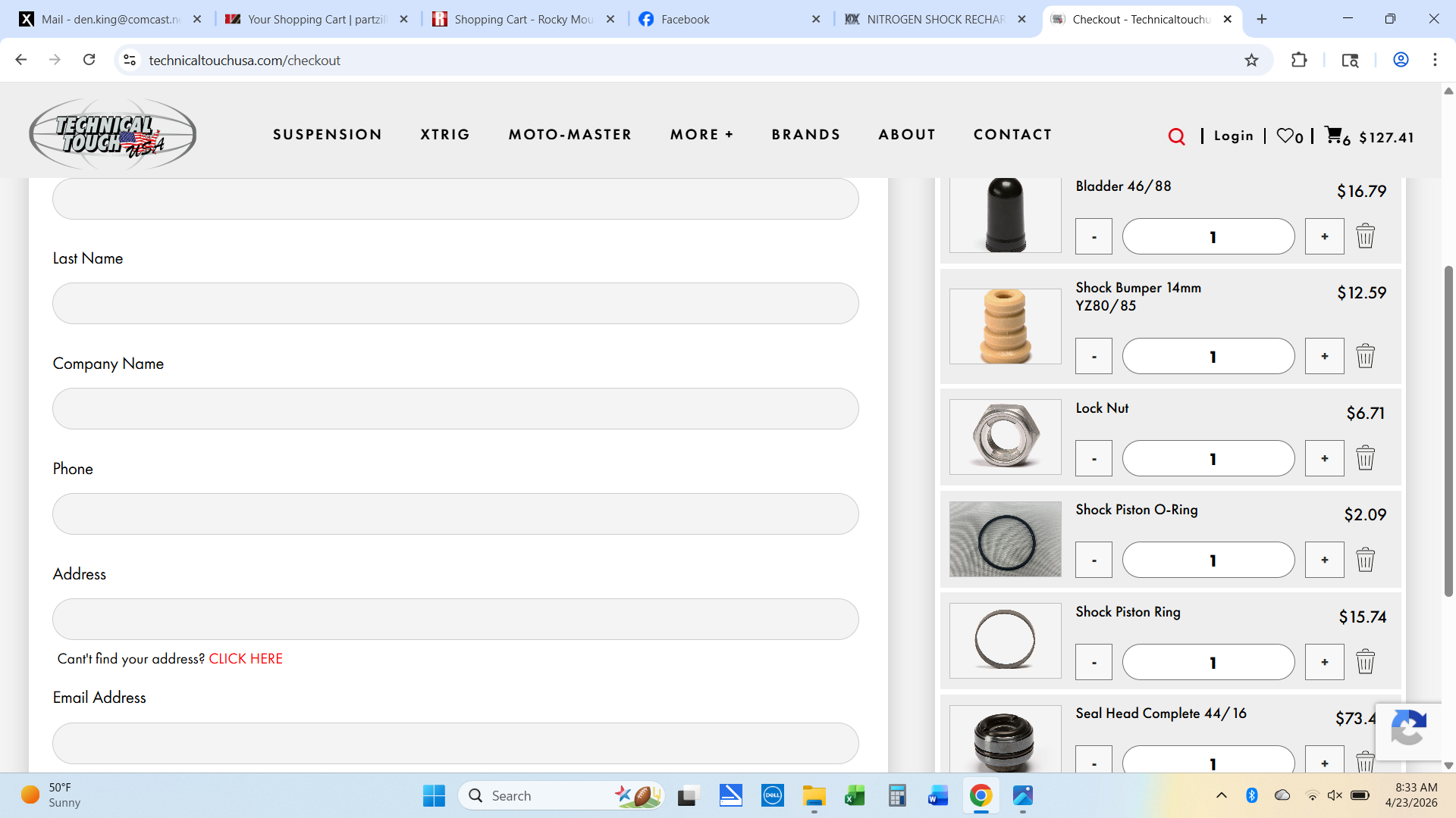

THANKS KDX GARAGE!
That trimmed off about $30!
Per your previous advice I had gone to Technical Touch but it kept/keeps telling me that those parts wouldn't fit the KDX220 so I went elsewhere, researched the part numbers I thought I needed, but then couldn't find a place that carried everything. I never circled back to Technical Touch when I rounded up what I thought I needed and I'm now just disregarding where it is telling me the parts won't fit a KDX220. Thanks for the reminder on the nut!

Nevermind.... Shipping ends up being $83.00. They are out of Canada so I'm guessing that's kicking the cost of shipping into the stratosphere....

NEVERMIND X 2....
Turns out the checkout page automatically defaults to 2nd day air for the shipping cost that it calculates at first. The other shipping choices are listed further down the page. Regular shipping is $19.00. I wonder how many sales they lose to this? I was back over to Partzilla and ready to place my order with them when I jumped back to Technical Touch to confirm something and the shipping chart caught my eye. Also, I misread the address for TT and it is Ontario California, not Canada...

Here is the nitrogen gas setup I purchased. Haven't used it yet but it looks like pretty good quality.
After I have all the parts/tools I'll try to put together a comprehensive overview of the process so others might have an easier time of rebuilding their own shocks.
https://www.ebay.com/itm/165400437188
