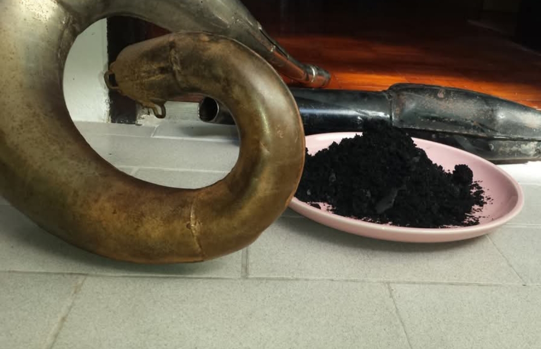

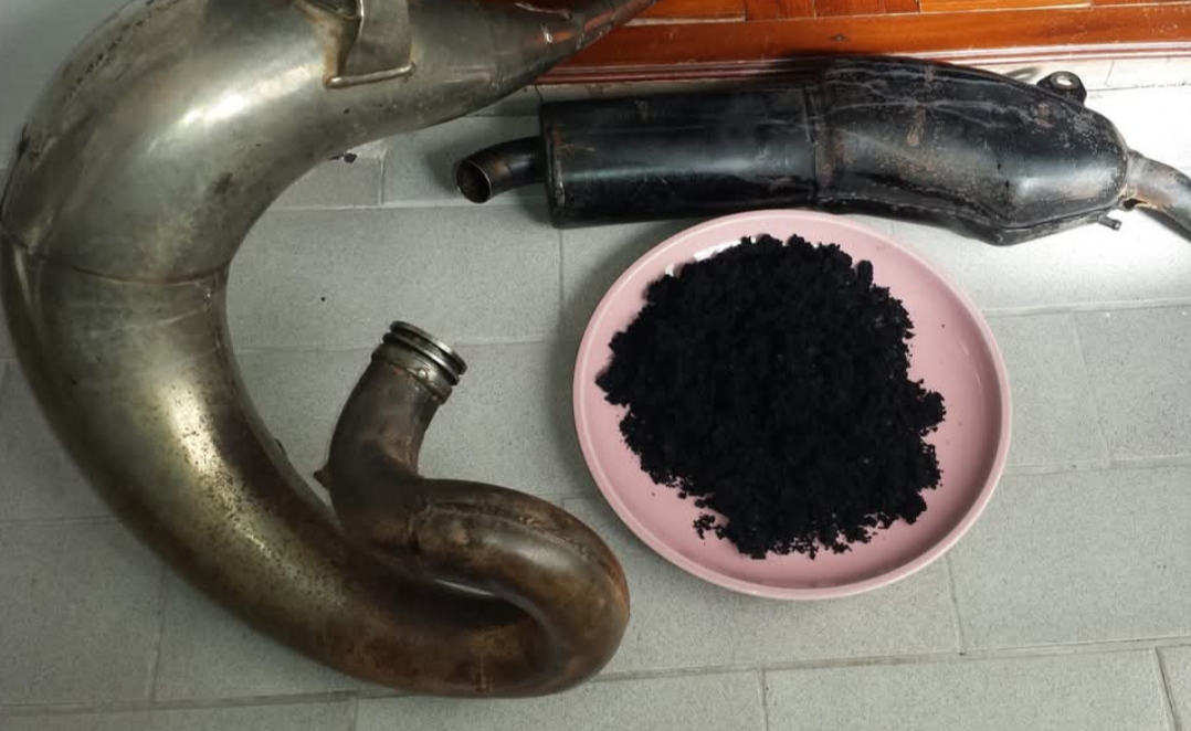

I think some of the reason people feel such a large gain in power when going to an aftermarket pipe is the stock pipe is caked with carbon on the perforations on the inside which reduces its overall volume and also the stinger area is prone to carbon build up around the weld joins, I soak my stock pipes in hot caustic soda for 2 or 3 days then flush

Hmm I wonder if i need to do this? My stock pipe feels like it weighs 10lbs.kdxdazz wrote: 06:07 pm Dec 23 2025 I think some of the reason people feel such a large gain in power when going to an aftermarket pipe is the stock pipe is caked with carbon on the perforations on the inside which reduces its overall volume and also the stinger area is prone to carbon build up around the weld joins, I soak my stock pipes in hot caustic soda for 2 or 3 days then flush

This is what came out of the procircuit pipe when I first bought the bike, although the previous owner had it running so rich it wouldn't even idle and took me 5 years to be able to get it to idle lol
The carbon doesn't weigh very much but the oil soaked fibreglass carries a bit of weight
