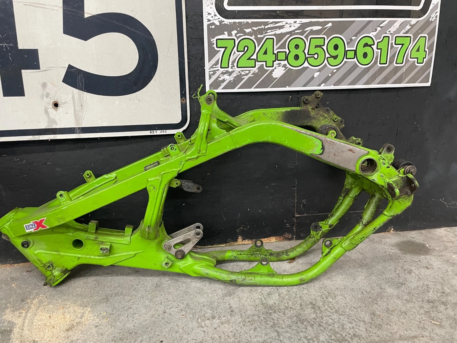

Now you've got me wondering how much a KX 125 frame weighs!
I know the stated difference between a KDX H-series and a KX125/KDX200 hybrid is only about 5 lb difference, but the fuel tank is smaller and fuel weight sits lower, as well as having a thinner seat and an aluminum seat subframe, and seat subframe rails which don't stick back nearly as far as the kdx, so I figured over half of the 5 lb weight difference was probably all just in the seat foam and seat subframe area. Now I'm wondering if most of that was actually in the fork with only maybe a pound or two in the seat foam and subframe and the dished out race spec fasteners used on the KX versus the full head fasteners mostly found on the KDX.
I've been talking about making a post on here comparing all of the weights of each component on the bike, as I went on a real deep dive last fall buying parts for my next 220 rebuild after I rebuilt the suspension linkage and felt how heavy the linkage bolts and swingarm pivot bolt were. Then I ended up buying almost an entire bike worth of fasteners short of a few internal engine bolts and a few small screws here and there, and the KDX specific rear axle which is only similar to a DRZ400 axle, and not available in titanium aftermarket since pre-covid.
Parts like exhaust swapping, KX250 or 125 kick start lever, KX shifter and brake pedals in aluminum to save an extra 1 lb, KLX 650R or KLX300R aluminum suspension link pull rods / dogbones vs KDX steel, etc... Those dog bones are effectively lowering links for a KDX,but I needed that due to swapping a longer rear shock onto my KDX.

Has anyone weighed a KX125 frame (with seat subframe) to compare to the KDX200H frame weight???

Chuck78 wrote: 04:27 pm Aug 05 2024 Has anyone weighed a KX125 frame (with seat subframe) to compare to the KDX200H frame weight?
I still haven't cracked into a full rebuild & major upgrade of my '99 KDX220 yet, but I'm still slightly considering picking up a '96-'98 KX125 chassis for a hybrid build.
Well... I'll soon be able to provide a KX125 frame weight myself, after no one else has chimed in here or elsewhere on the big comparison question!
...after finding some rare aftermarket parts (purple Acerbis KX desert tank, AC Racing aluminum KX seat subframe, Acerbis 035 KX250 spark arrestor, and Works Connection '94-'02 KX125 frame guards, + an additional $183 later, I now have a '97 KX125 frame in transit.... so I'll finally be able to weigh the differences in frames, mid-period '95-02 KX125 vs perimeter frame '95-'06 KDX200/220... Building a hybrid from parts is a costly approach, however it will be built with the exact parts I choose, and all good condition vs buying a clapped out KX125 roller
- Posts: 1432
- Has thanked: 204 times
- Been thanked: 99 times
Re: Stock 1995-2006 KDX part weights photos
Well... KDX200H/220 bare frame
30.30lbs
-vs-
26lbs 5.0oz (26.31lbs)
'97 KX125 frame
(missing the 4 seat subframe mounting bolts but has the 2 headstays & 2 headstay bolts & 2 chain rollers/bolts...
Seat differences - the KDX seat is only around 5.5-6.5oz heavier roughly
(2.5oz lighter as pictured minus the weight of the second seat cover under the green ribbed outer cover - the KX125 seat has a black/purple cover underneath the visible cover, FYI...)
