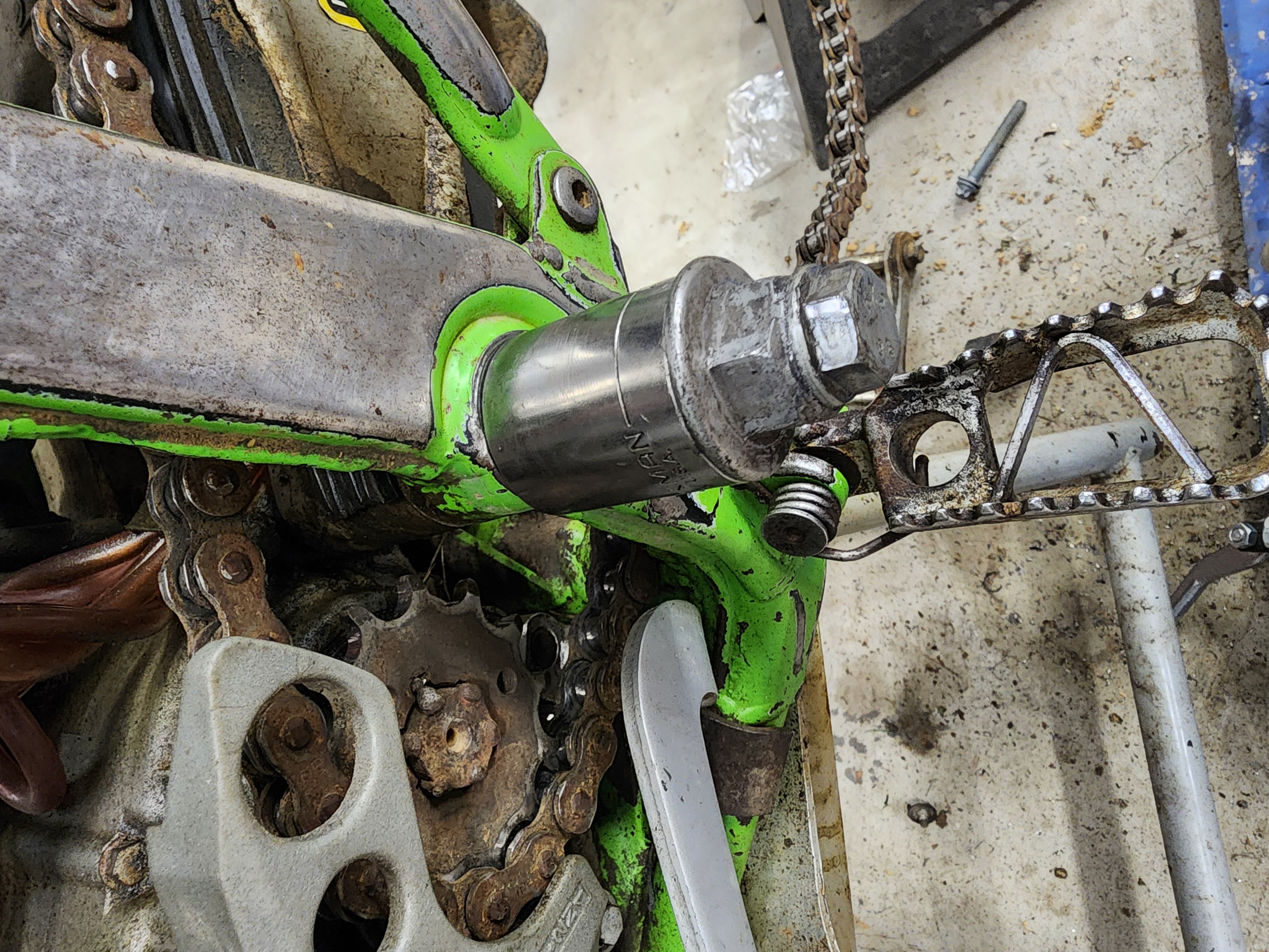

Tapped m10 threads into the head of the bolt and used the deep socket technique as a puller, no luck.

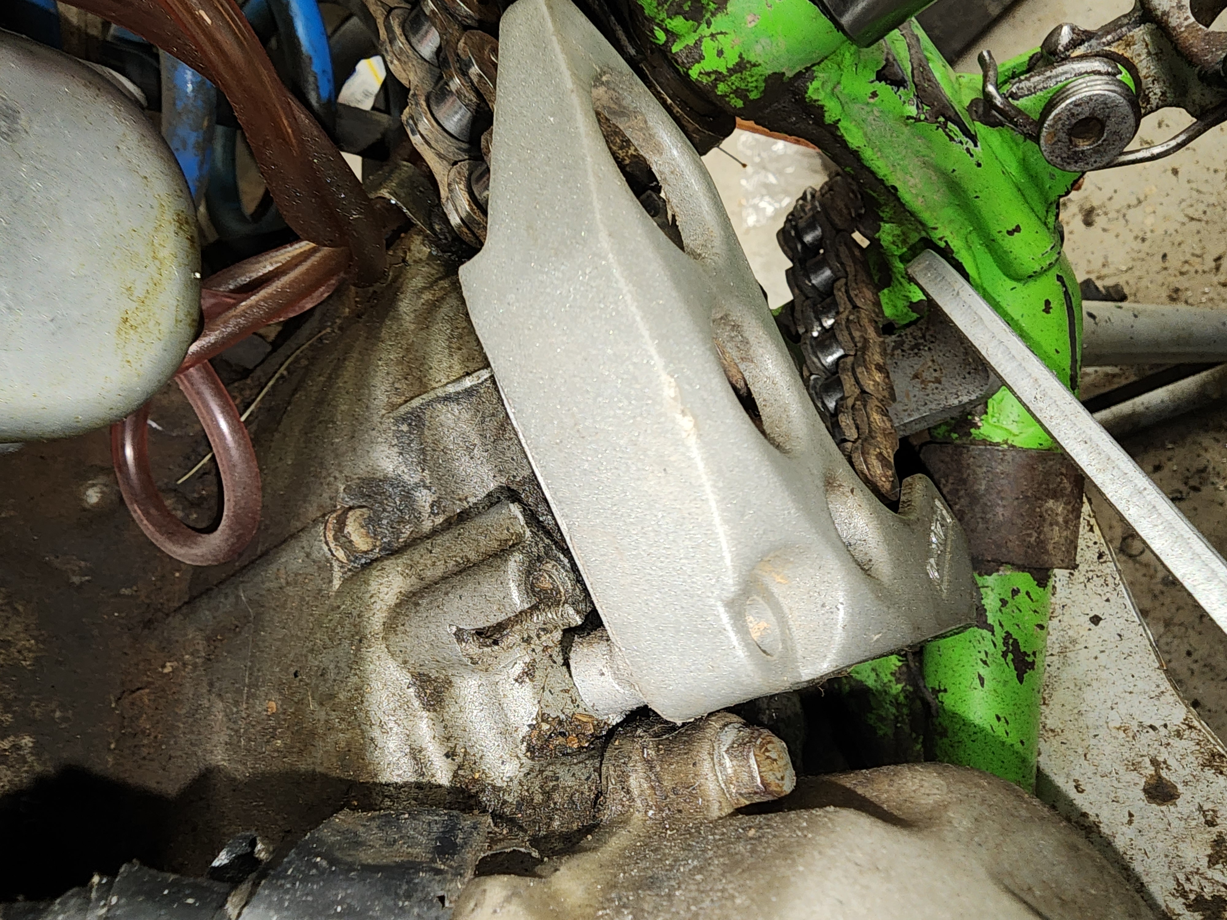

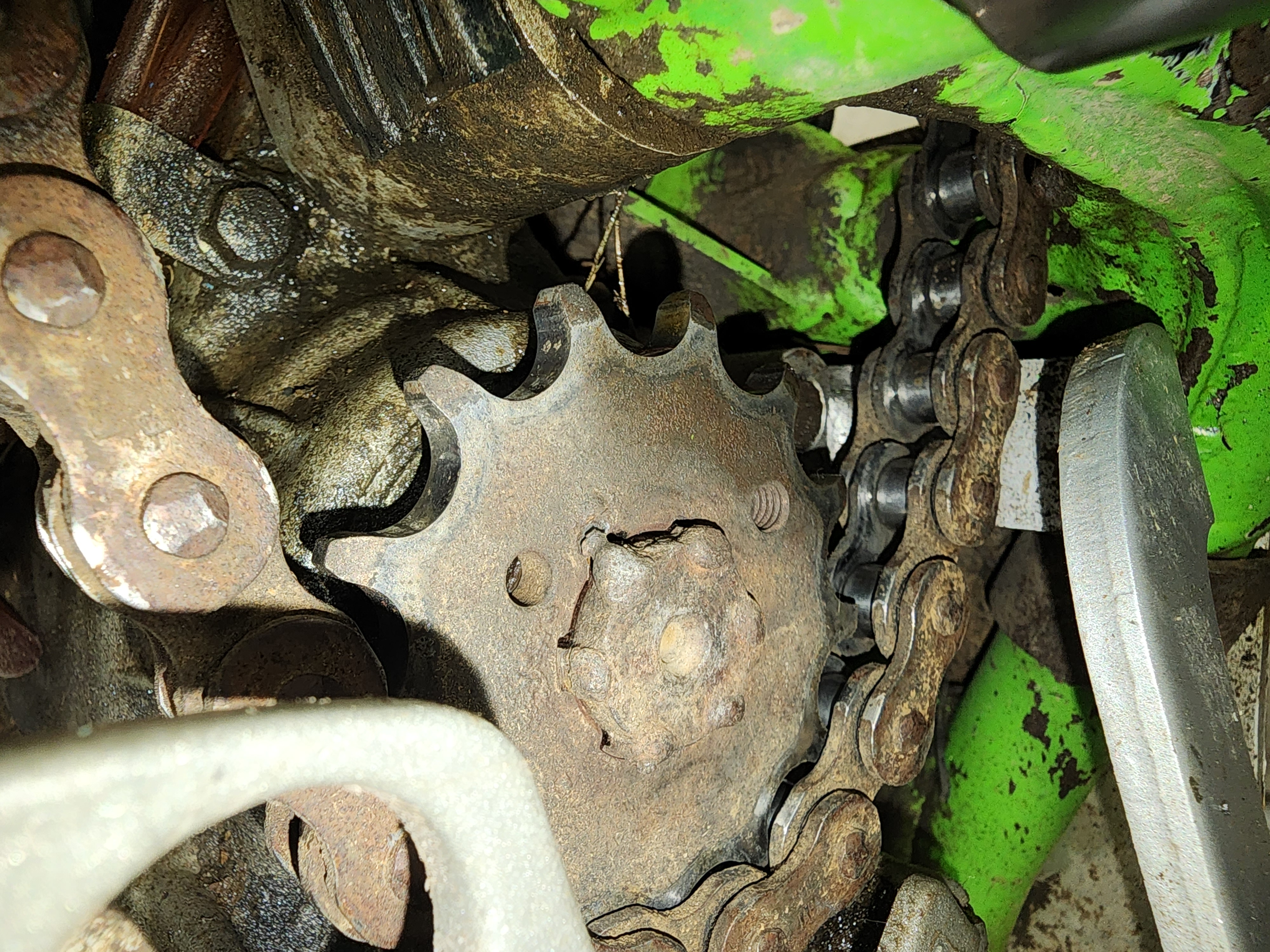

The other 2 pictures show the other projects I have waiting for me- a broken case for the sprocket cover, and a welded on front sprocket.. can't wait!

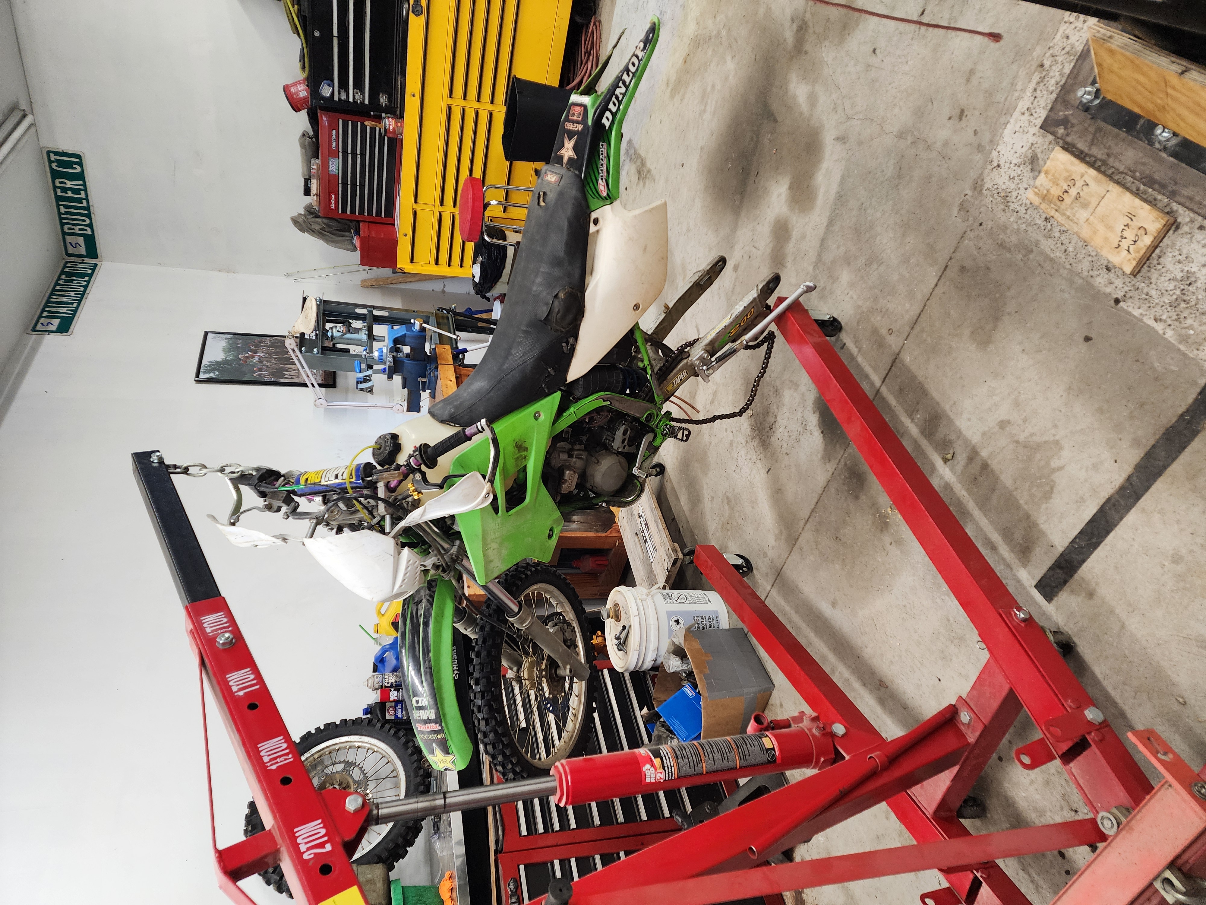

I didn't take a Pic of it in the press, but I did use an engine hoist to position the front of the bike while wrestling the back half into the press.

Forgot to attach these pics on my last post..
