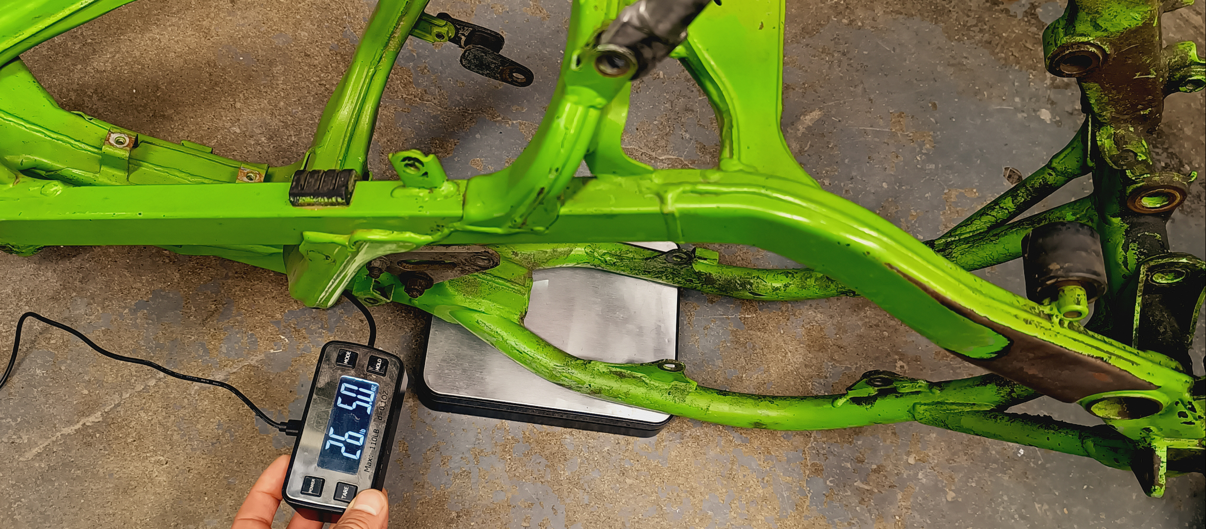

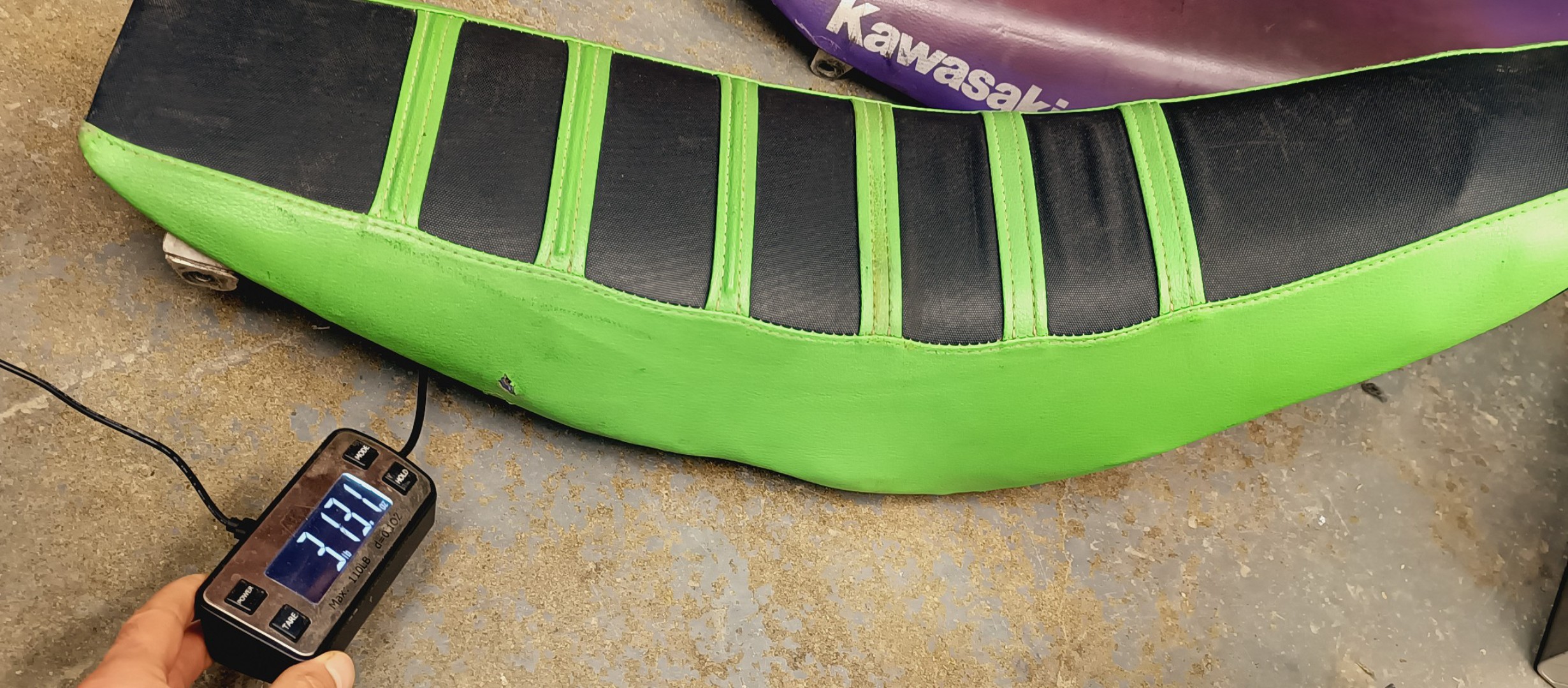

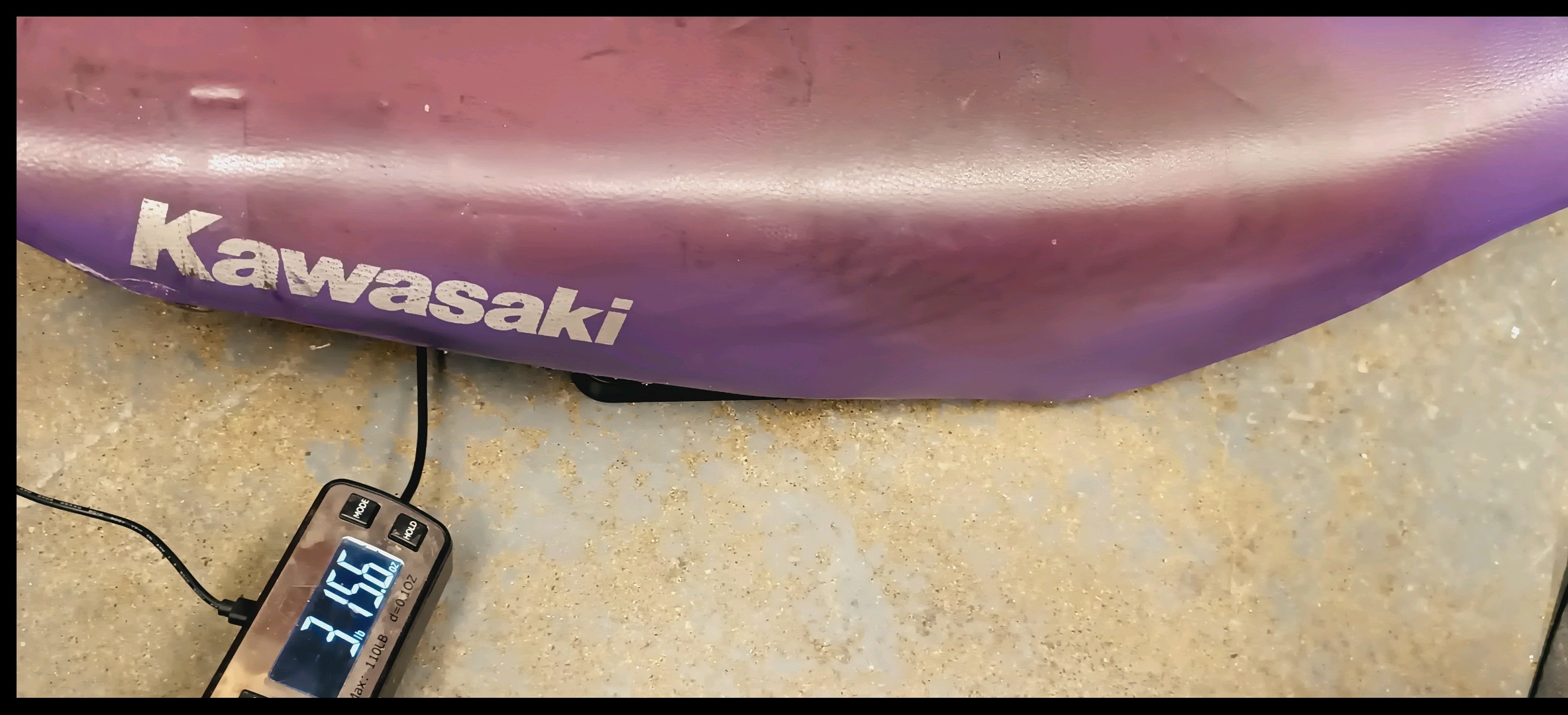

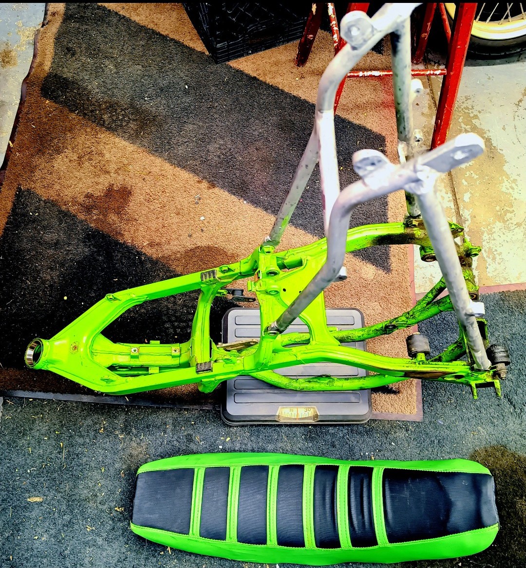

Well... I'll soon be able to provide a KX125 frame weight myself, after no one else has chimed in here or elsewhere on the big comparison question!

Here's an abbreviated, weight info only version of my ramblings on a more elaborated thread elsewhere here:
@soup-n-sandwich's KDX200H/220 bare frame
30.30lbs above (I do see the rocker linkage knuckle still bolted on, actually)
-vs-
26lbs 5.0oz (26.31lbs)
'97 KX125 frame
(missing the 4 seat subframe mounting bolts but has the 2 aluminum headstays + their bolts, upper exhaust mount, & 2 chain rollers/bolts...
So the KX frame is about 4lbs lighter than the KDX frame not including adding KDX case saver hoops, not including the added weight of the bigger 1997+ KX swingarms either.
I may try and scrounge up a junk KDX frame to graft the case saver hoops off it to weld onto the KX frame to better support the "wings" of the KDX skidplates that I'd likely be fitting to this if they'll match up to the KX frame's bottom (SxS skidplate should, hopefully the Hyde Racing pipe guard skid plate combo also as that's my #1...)
That'll add a little bit of the weight savings back as well.

Seat differences - the KDX seat is roughly 8oz heavier vs the '94-'98 KX 125/250 seat. Losing weight up top on the bike is of great benefit to the perceived feel of the bike. I did note that the Kawasaki parts fiche diagrams show a low foam and a tall foam option. I'd imagine the taller version is the standard version. Stock was a dual density (2-layer) foam setup on these, quite nice.
(2.5oz lighter as pictured minus the weight of the second seat cover under the green ribbed outer cover - the KX125 seat has a black/purple cover underneath the visible cover).
-vs-
'97 KX125 frame
