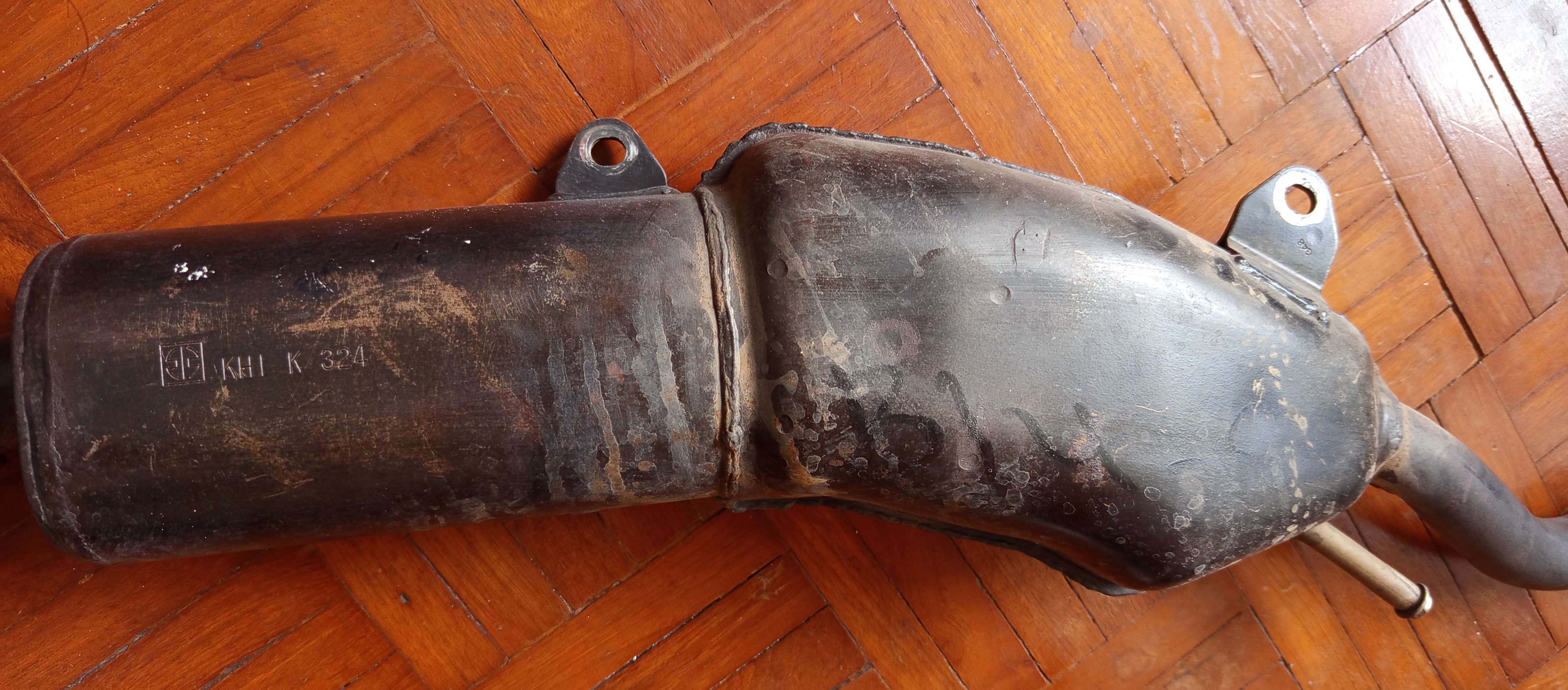

Here is the SR model muffler if anyone is interested, doesn't appear to show anything about the spark arrestor like the R model does so now I know why the part numbers are different even though they look identical

kdxdazz wrote: 03:10 pm Sep 01 2025 The KDX250SR is a chambered design, the first part is a resonator wrapped in fibreglass, the second part is the chambers, very complicated in design.
The mounts don't bolt up at all to the H series, I had to cut off one ear and reweld it in a different position and made an offset mount for the other one.
I bought it not knowing it was missing the chambers but I brought it back to Australia so I could make it fit the H series then back in my bag it goes back to Thailand, I have another kdx250sr muffler lined up to use the missing chambers
I don't believe there is any spark arrestor
Part of noise suppression in the expansion chamber is the thickness of the material, so there is no way around it, heavier and quieter or not.
The weight on the stock pipe compared to aftermarket really is negligible given the weight is carried low but like you say the procircuit has an incredible midrange hit compared to stock, I prefer stock for it's off idle performance and like you say the procircuit just seemed to wheel spin and break traction which made it exhausting to ride.
I'll test the kdx250sr muffler using the wideband O2 sensor so I can see what jetting changes are needed
kdxdazz, did you ever get the time and 250SR muffler parts to assemble it and test it?
I've now got one in transit from Japan for around $100 USD shipped w/tarriffs included.
I'm wondering about their internal construction. Is the chambered portion at the front/bottom? That's where the oil drain hose nipple is located. So you're saying that part of the muffler is a typical fiberglass wrapped perforated tube type baffle, but the other part is chambered? Do you have any photos of the chambered portions?
I'm slightly concerned that the chambered design may choke up the top end power a bit due to slowing down flow.
BUT...,[/I] as I have 2 KDX220R bikes & 3 total engines (1 spare), I'm thinking this winter, I'll build the 3rd engine up as a KDX220R low/mid torque technical singletracks build that won't target maximum top end revs, so the chambered SR muffler may be perfect for this, paired with an FMF Gnarly Woods pipe or the stock KDX220R expansion chamber.

kdxdazz
Posts: 621
Joined: 07:51 am Dec 28 2017
Country: thailand
Location: Thailand
Been thanked: 41 times
Re: Quieter exhaust options?
Post by kdxdazz »
That sounds like some great projects you have, glad you got your hands on the SR muffler, the very last part is chambered, the part near the mid pipe is the resonator wrapped in fibreglass, I have a disassembled photo of the SR pipe somewhere on my phone, will try to find it
