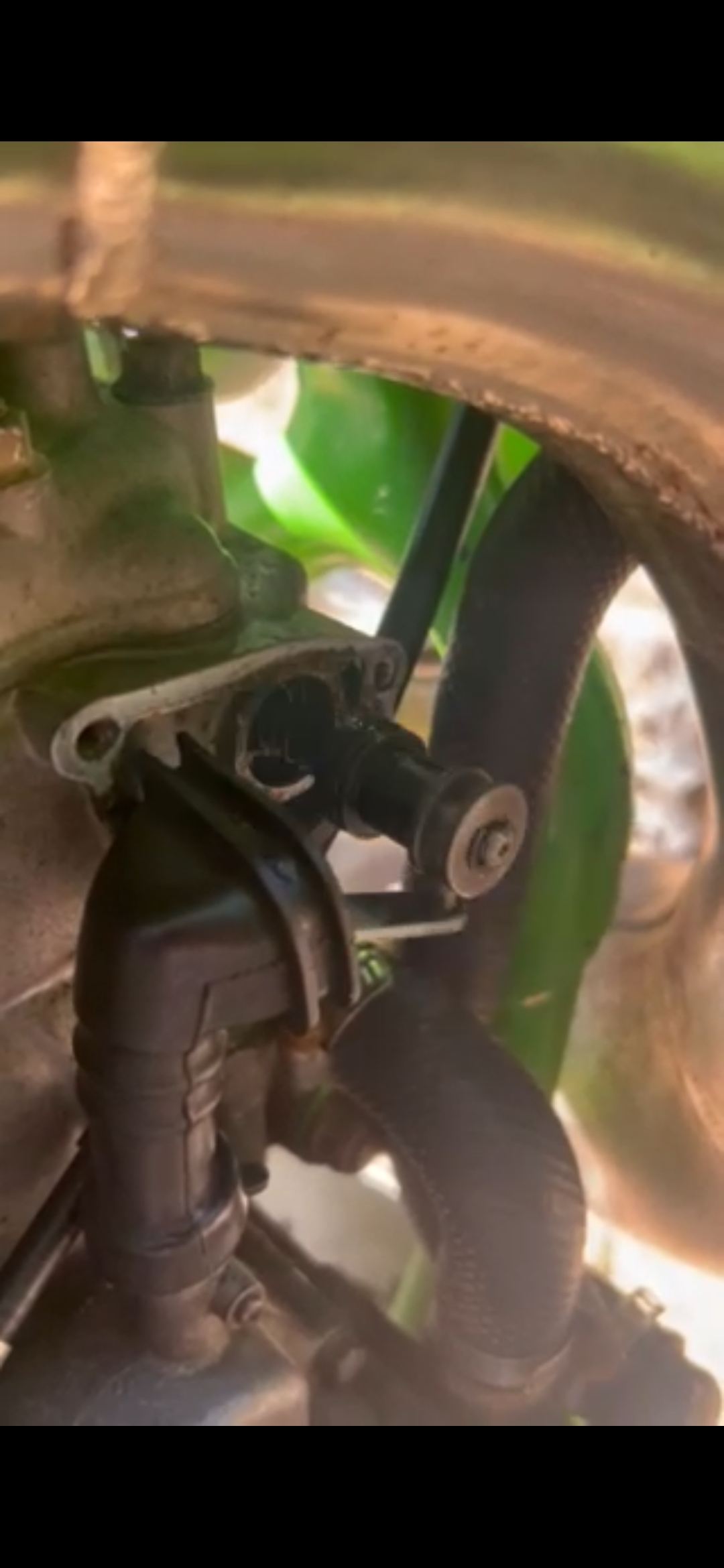

Hello I am back again for the power valve govenor rubber cover leaking with exhaust system smoke. I have taken the top end off and cleaned the carbon from the power valve system and timed them correctly and replaced the rubber o ring on the govenor rod and im still having the same issue where a tiny bit of smoke is seeping out from the rubber cover piece on the govenor side of the powervalve system. I'm not sure what to do from here any suggestions on what to do next and help is much appreciated.

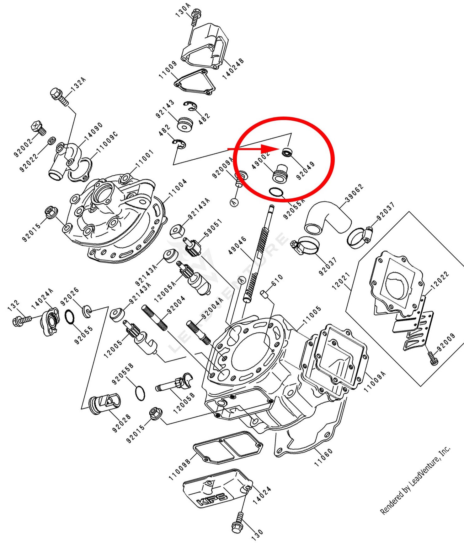

Hi. Did you replace the seal, Kawasaki part number 92049-1206?

On the parts diagram, those are the only two things keeping the oil and smoke in, I think.

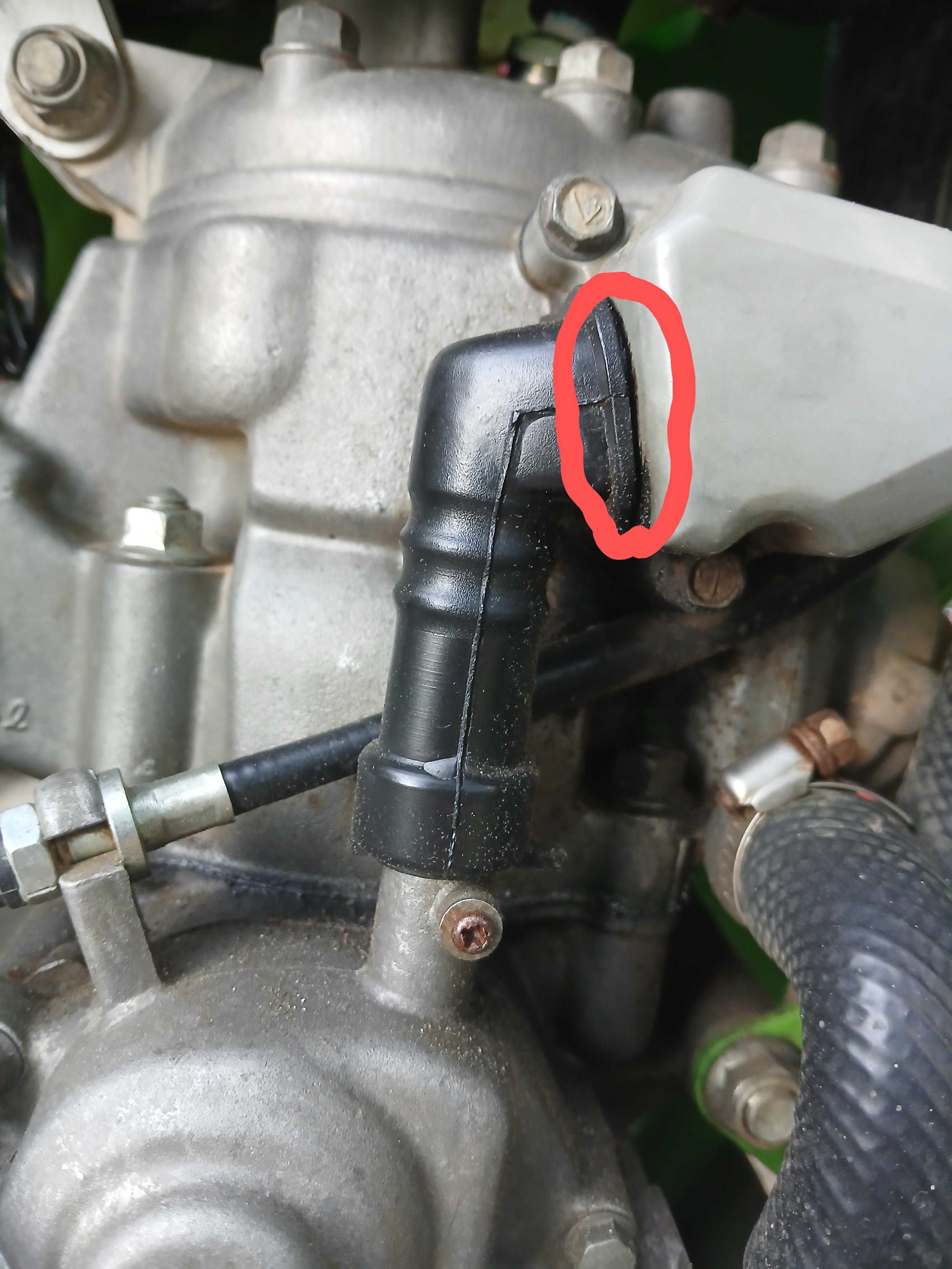

Hello I have found that on my bike on the govenor side of the power valve the o ring on the powervalve shaft is not keeping the slider in place and sealed and is allowing exhaust to come through i have replaced the o ring and it is brand new im not sure how to fix this issue any help or guidance is much appreciated thanks.

I don't see the seal in that pic. Have you replaced part number 92049-1206?

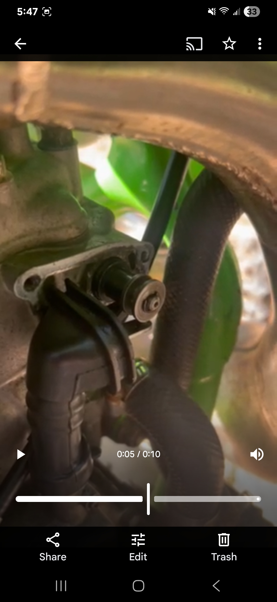

Why is your KIPS rod sticking out so far? Is the shaft nut attached behind the rubber boot? Generally one can not just pull it out that far and not have it snap back as it is under spring tension.
Is your KIPS pin inside the clutch cover broken?
With the butchered JIS or Philips screw shown in the first pic, it makes me wonder more.

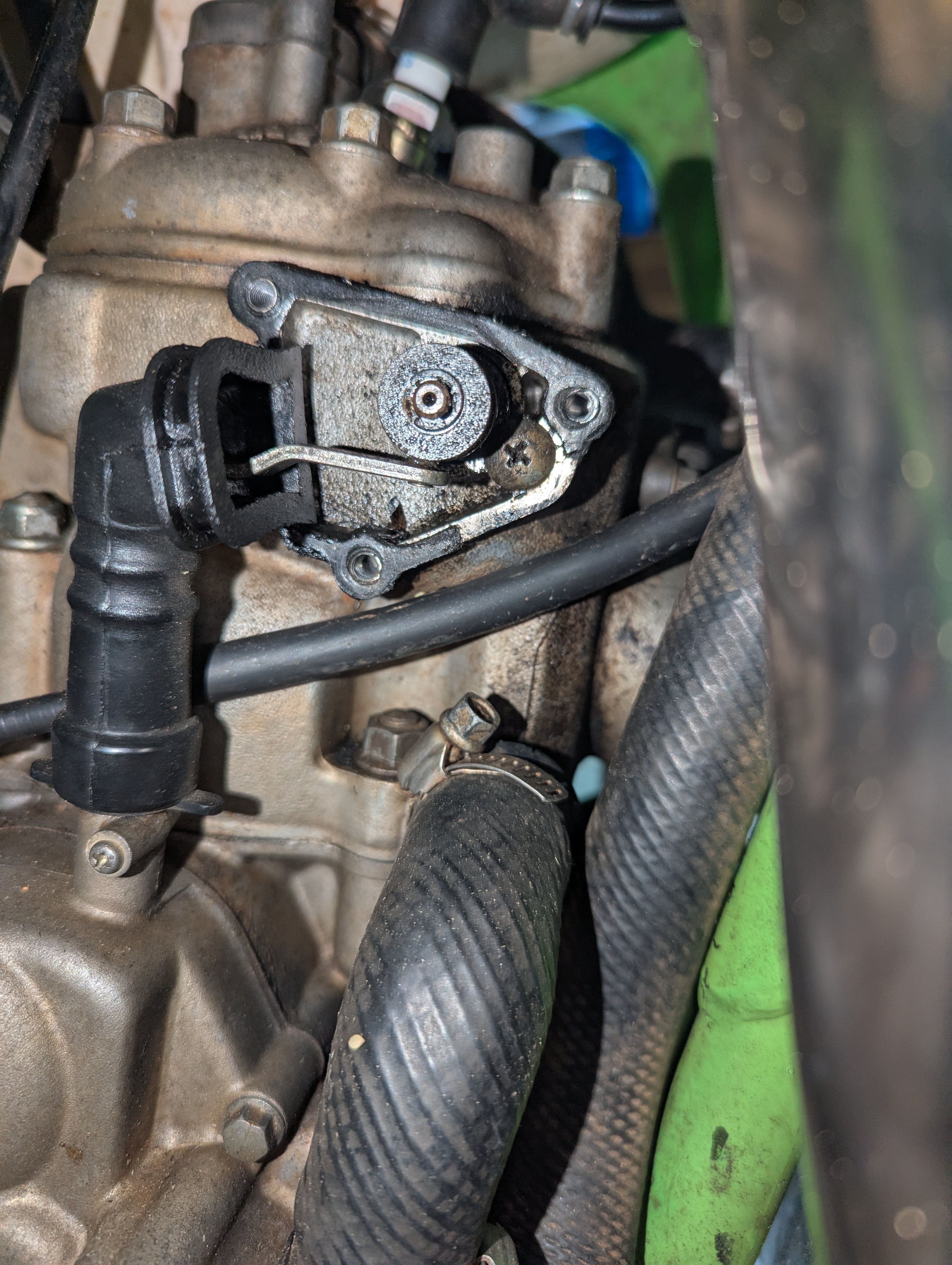

With the guide are you installing the flanged bolt # 92009-1502 to keep the guide # 49002-1083 in place or is just free to move in and out of the cylinder as the rod moves? I don't see it installed in any of the photos but it is a bit hard to see as it is around the 4 o-clock position on the guide/cylinder.
If it is still leaking past the o ring once installed perhaps the bore where it sits is worn out, nothing wrong with cleaning everything off and putting a thin layer of sealant on the outer guide/o ring to prevent the leak.

Jimmy makes a very good point, there is a screw that holds in the part that holds the seal, letting the rod move in and out through the inner hole. I completely forgot to mention the seal that the rod moves through, though it is a quick and easy change. I believe SS109 already mentioned it.
I sent a photo of where that screw should be located. It prevents the whole mechanism from moving out of the case as the rod moves in and out.
I get no smoke out of my cover, though I did when I bought the bike, but changing out the seals did the trick.

I was about to reply about the missing screw, but I see that has been thoroughly covered. That would certainly do it. It would certainly attribute to early exhaust valve failure as well.

I will put the screw in and that should do the trick thank you so much.

That seemed to fix the problem thank yall so much you guys are a blessing!
