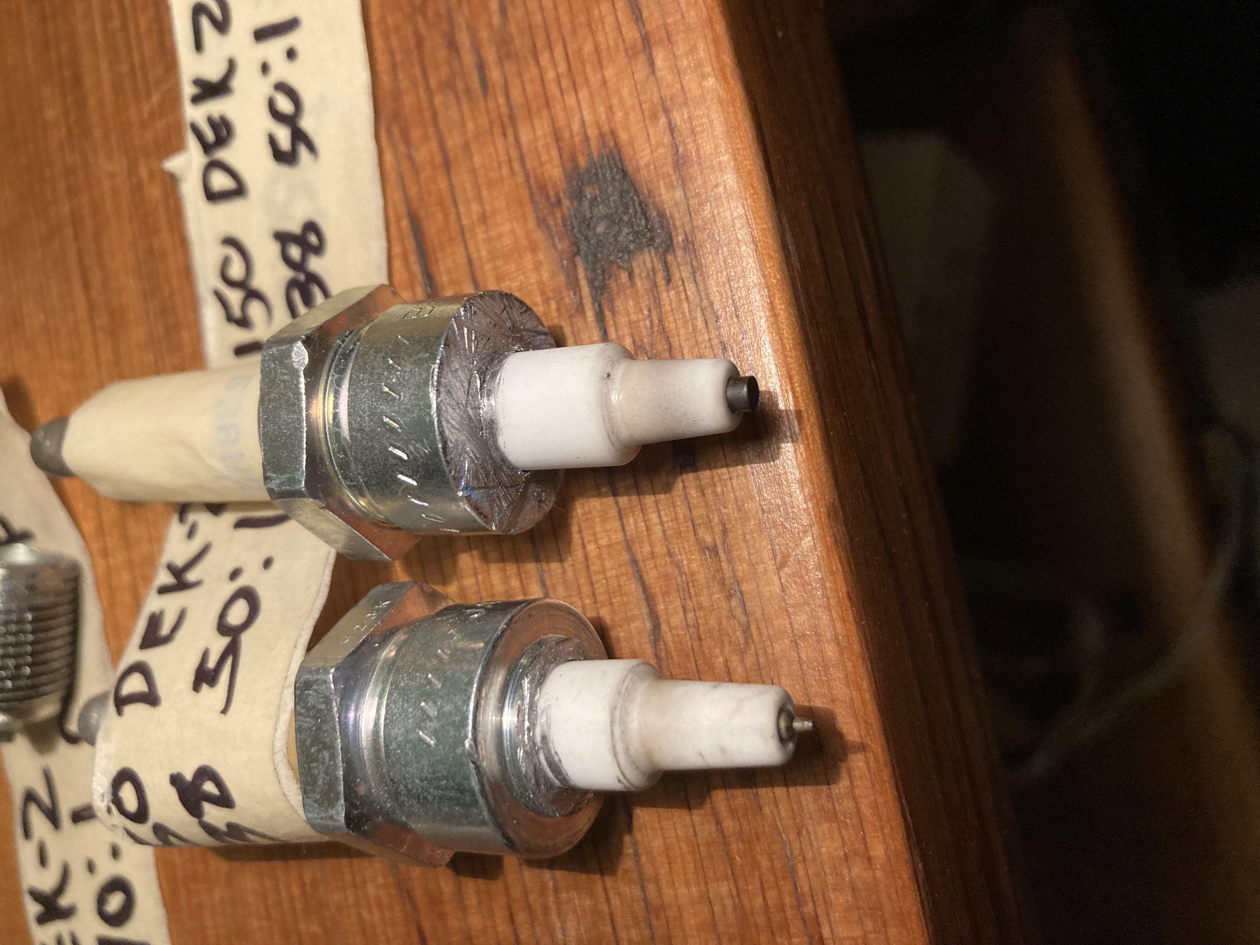

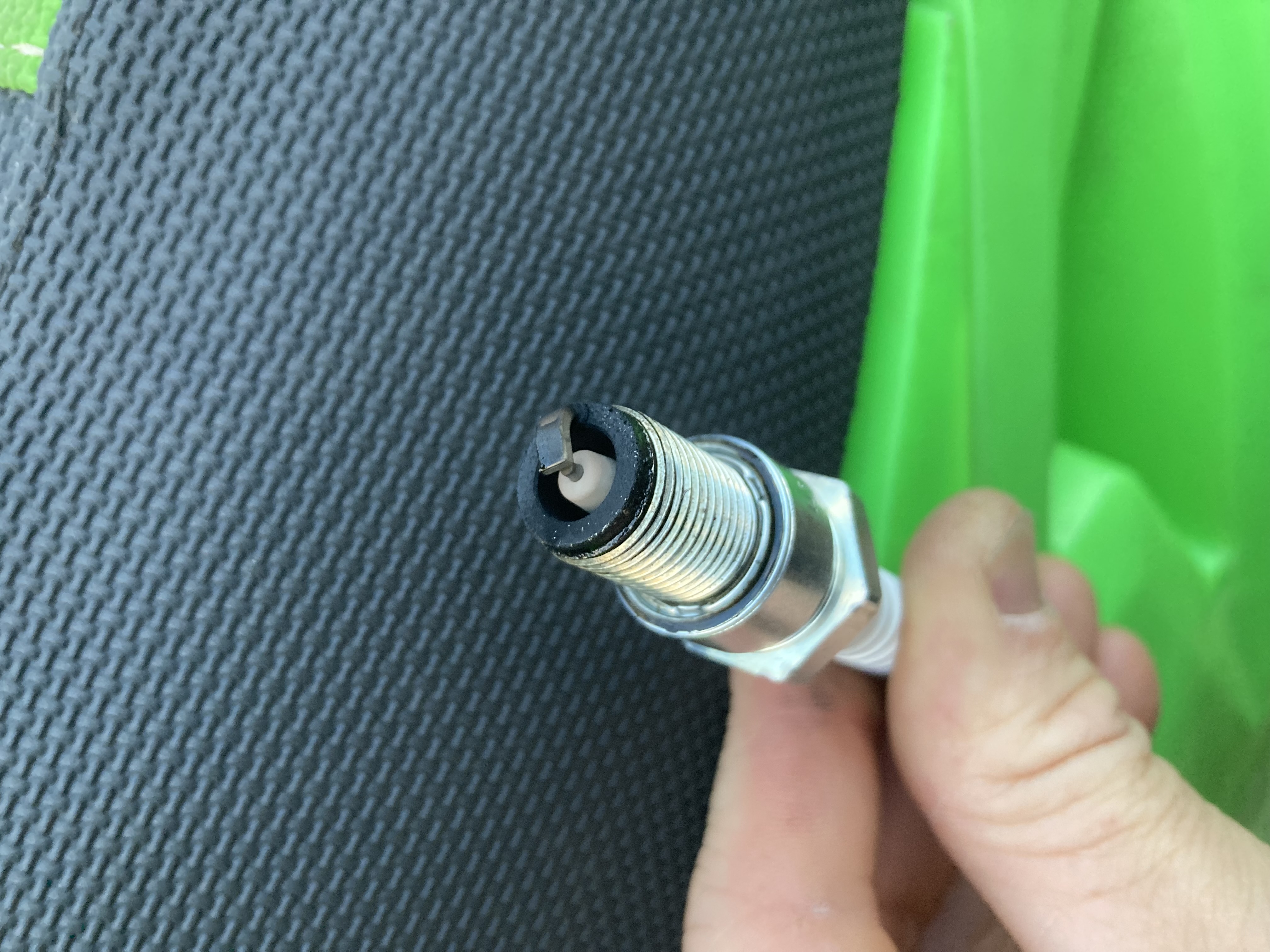

After some more riding with the aforementioned setup, I thought it worth a post that some days there’s barely a dribble from the muffler, and some days it has a drip running half way down the turbine core II. I still think the situation is much improved with a 50:1 mix.
Here’s the latest plug chop with a BR8ES plug (on the right, BR7EIX on the left for reference). Same setup on both plugs with about 15°F warmer ambient temps for the 8 range plug on the right.
I’m also including a pic of the unchopped BR8EG I’ve been running on the trails. Hopefully this info will all be helpful to someone combatting KDX spooge in the future
Re: More on spoo....
Wow. That looks too lean to me.
In general riding, how often are you revving the heck out of it?
Did you take the pipe off and clean it before starting the plug chops and jetting? If it was rich for a long time, the oil was still in the pipe and spark arrestor.

Yes, very lean.

I did not remove the expansion chamber before this process. I do a fair amount of slow wheelies & pivots, so it should help evacuate some residual spooge. I did have the silencer off the other day to install the exhaust joint sleeve- nothing was dripping out of it.
For what it’s worth, I’ve been running this exact jetting or something very similar to the 40,150 setup the RB carb comes with for quite a while now- the main thing that I’ve changed recently is using 50:1 fuel instead of 40:1.
I don’t rev the bike to the moon very often, but it was hard on the pipe heading out to the fire roads for a plug chop just before I snapped that pic of the plug I’ve been running. I think that plug has about 2 or 3 hours on it- mostly in the woods
You guys think it’s too lean despite the full ring of black around the base? I could fatten up the main another step or try raising the needle a notch. I’m hesitant to mess with the pilot as the bike starts well hot or cold, idles perfectly and runs crisp in that throttle range.

Here’s a pic of both sides of the most recent plug chop with decent lighting
