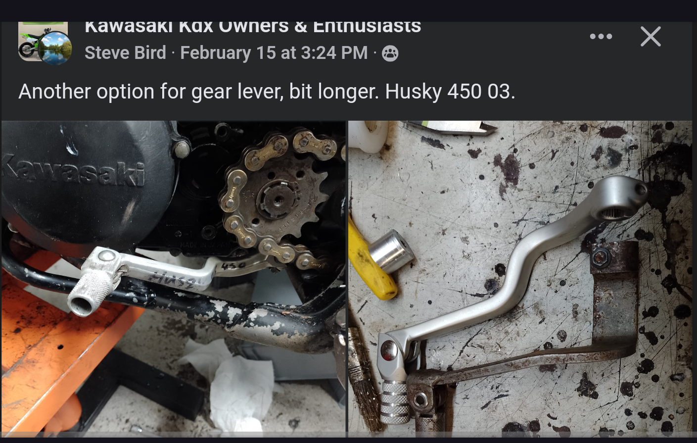

Apparently a 2003 Husqvarna 450 aluminum shifter pedal fits the KDX shifter splines as well, for another potential weight saving shifter swap. It's slightly longer as well, which will help those with larger boots.
I believe another guy found that an older aluminum YZ shifter also fits with the same spline size
