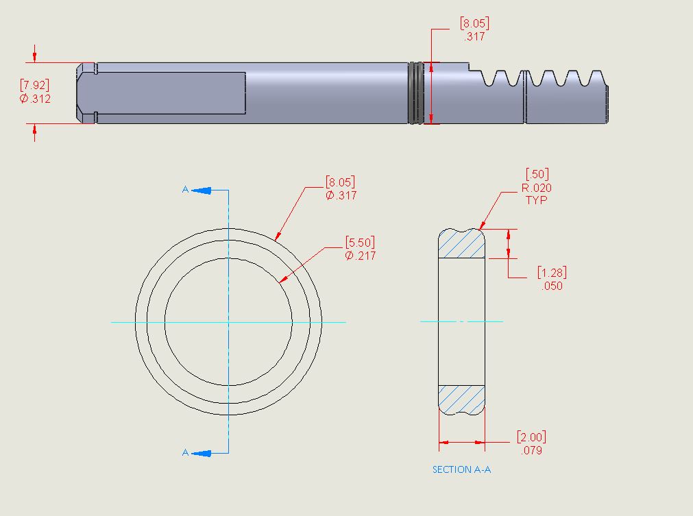

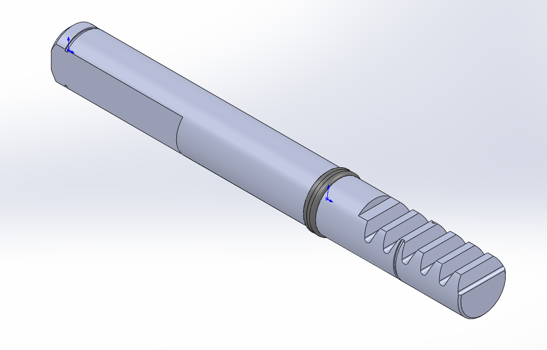

It's coming, still more to do ( the rest of the teeth etc) and a couple anomalies in what I measured when compared to to the 3D model, but I'm getting there.
Reverse engineering and copying something this small is a pain. I picked up a RevoPoint 3D scanner a few months ago that I haven't fired up yet, guess it's time! That hopefully will answer some questions that the Vernier just can't...........

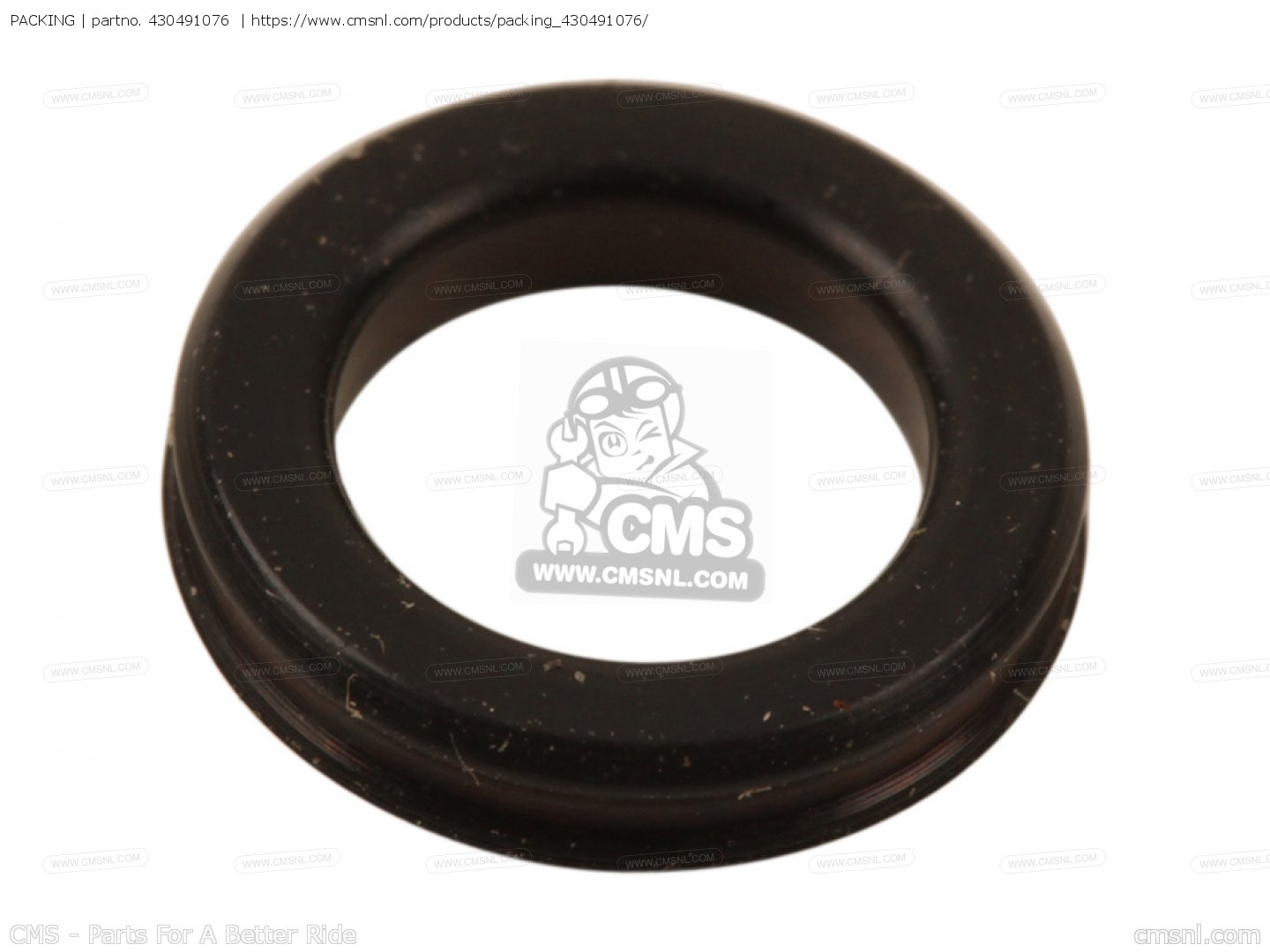

https://www.cmsnl.com/products/packing-nas_430491076/
Here's a photo of the NLA KIPS shaft packing seal. Sort of like a quad ring / x-ring, but with only two lips on the outside portion, the rest is basically a rounded corner square o-ring seal.
I also used CMS Netherlands to look up the part interchange, and unfortunately the H series and 220 are the only engines these packing seals wherever used on, unfortunately. So many parts for our bikes, when looked up on interchanges, may fit 50 or 200 models even, but not this one...all 27 models/model years are just the entire run of the KDX200H/220A(R). I'd imagine a website that lists the international '94+ KDX220B (KDX220SR) would also include those models in the interchange, but those models are even more scarce anywhere that we are concerned with in general.

Busy weekend, but got a bit more into it....... it's amazing how good one's camera phone actually is........
The seal groove is pretty much size on size with seals ID and seals width. The most important thing is the OD once installed. Assuming it's an 8mm bore (I don't have PIN gauges to properly check it) there isn't much squeeze on that seal. Likely to keep the actuation friction as low as possible. The measured OD is what I measured with the seal installed on the shaft. I'd want to shoot for .317" as your min, and probably no higher than .325" as you max OD with a seal installed (my two bits anyways)
These are the best numbers I can get. Dimension in {} are in mm. Will keep working on it though. As stated, my goal is to get a standard sized Xring or Oring to fit a modified groove if at all possible, resulting in the same squeeze.......

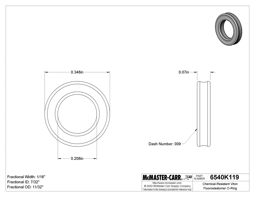

EDIT - this size converted to decimal inch sizing equates to exactly the standard "-008" SAE size.
Or this perhaps, inch side, but perhaps it would stretch and compress? The closest "SAE" sizes I can find in any format o-ring x-ring etc are all seeming to be listed as size standard "-009" - although you mentioning a dash 008 makes me think the 8.05mm dimension you list was total and not with .010" / .254mm sectional squish added.
https://www.mcmaster.com/6540K119/

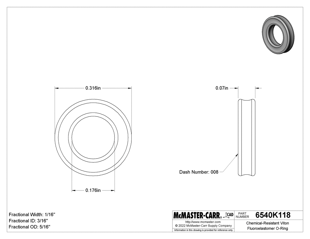

*OR* your -008 size in an x-ring, these are both Viton Fluoroelastomer x-rings, a much better choice for an engine cylinder:
McMaster-Carr -008 X-ring Viton 6540K118 https://www.mcmaster.com/6540K118/

The McMaster part 6540K118 - the 008 Xring or Quad ring is EXACLTY what I want to try to get to work. It's slightly narrower but nothing I'd be worried about (instead of about .001 clearance per side on groove width, we have .004" - means pretty much nothing) My plan is to 3d print some parts and install this on it and measure the final OD with the seal on. Make sure I'm in the range, then machine the shaft groove deeper but leave the width the same, and try it!
