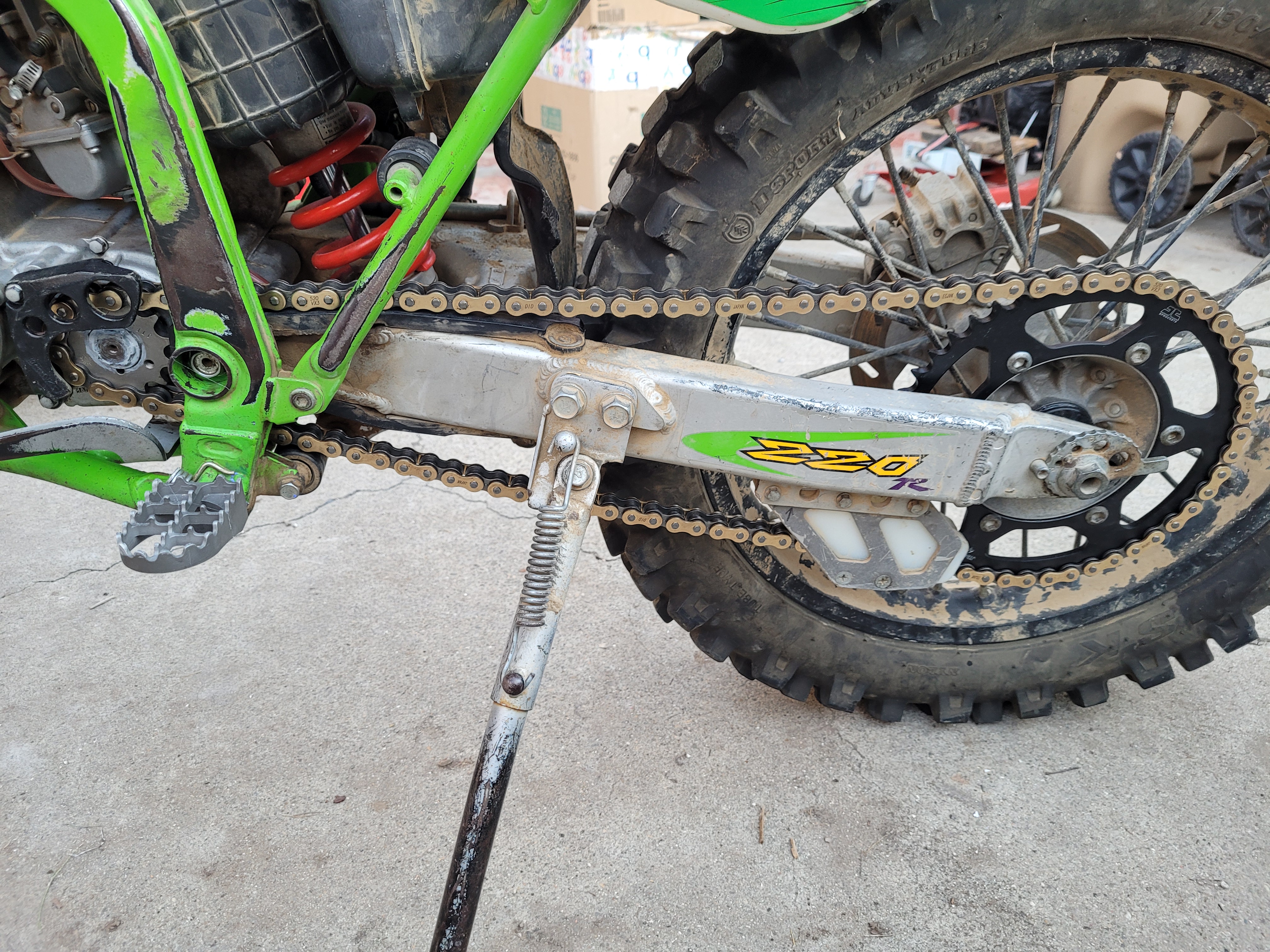

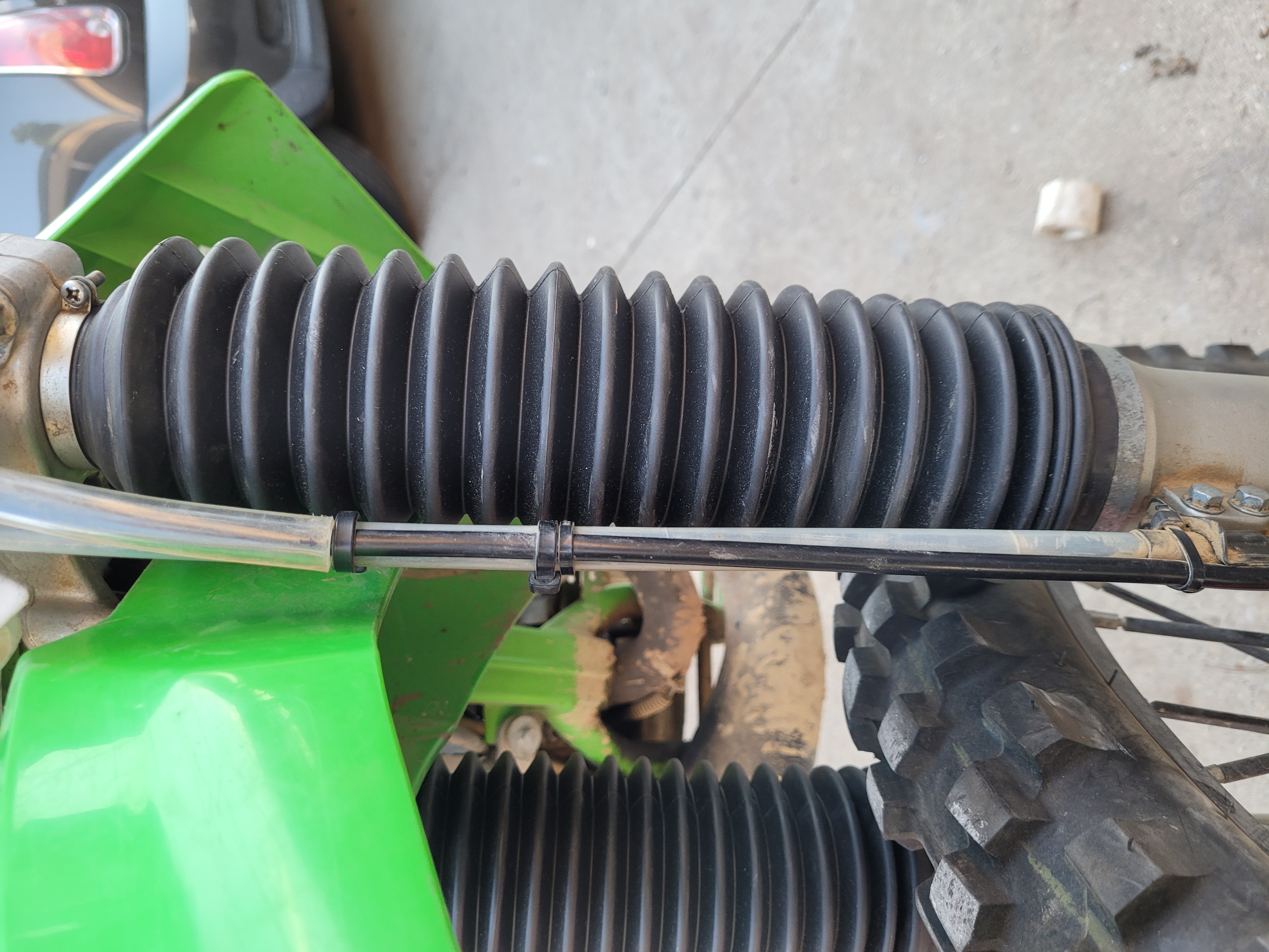

Installed some new parts on my 1999 KDX 220.
1) Fork boots
2) Countershaft oll seal, (two skinny) countershaft o-rings, 13 tooth countershaft sprocket, sprocket retaining clip, 47 tooth rear wheel sprocket, and X-ring chain

If anyone looks closely at the countershaft sprocket, then they may see the Three Bond 1184 semi-drying liquid gasket application (to better retain spring clip & seal shaft channels). A little bit of this is also smeared onto the chain master link clip. (This habit was formed when I roadraced, where it is required by code book).
