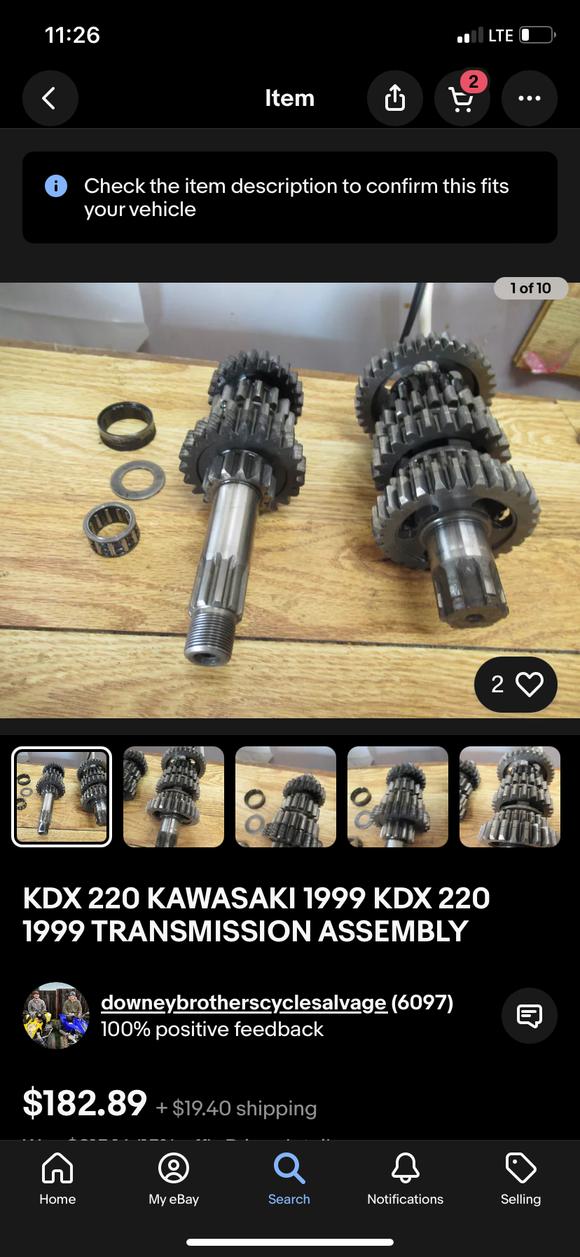

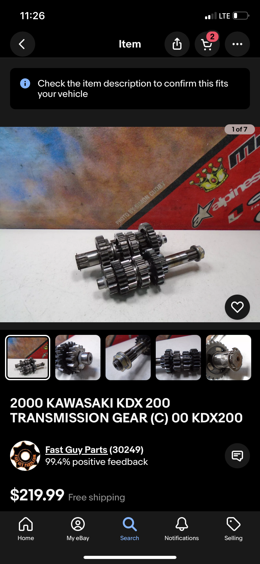

Are thos gonna work

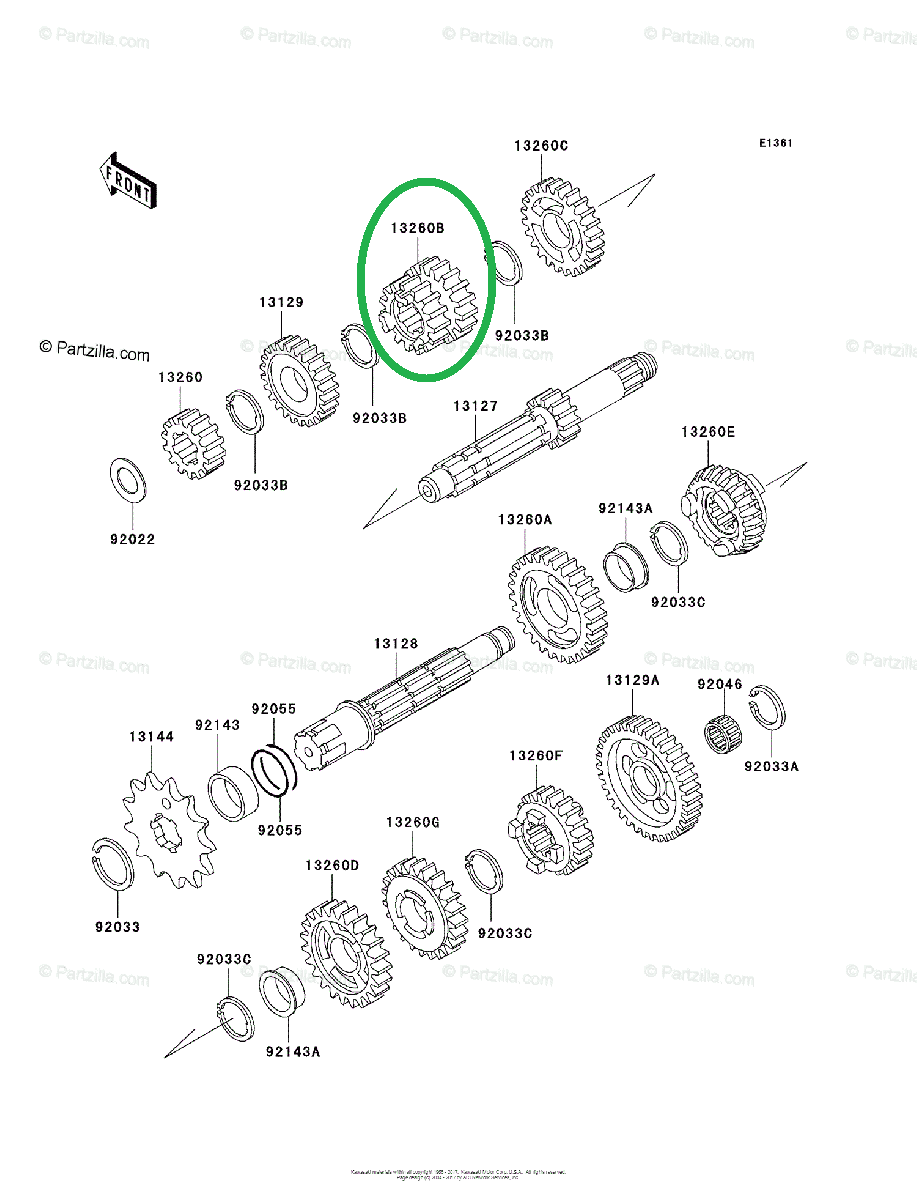

Is this the only gear you need?
2001 KDX Transmission.png (111.5 KiB) Viewed 5341 times
Joeymf
Posts: 34
Joined: 04:38 pm Sep 03 2024
Re: Transmission gears
Post by Joeymf »
No I’m most likely gonna need all of the gears bc I have more than 1 chipped gear
OK, look for 2 shafts and gears from a 1995 - 2006 then. The shafts don't have the same part number on 1989 - 1994 KDX200.

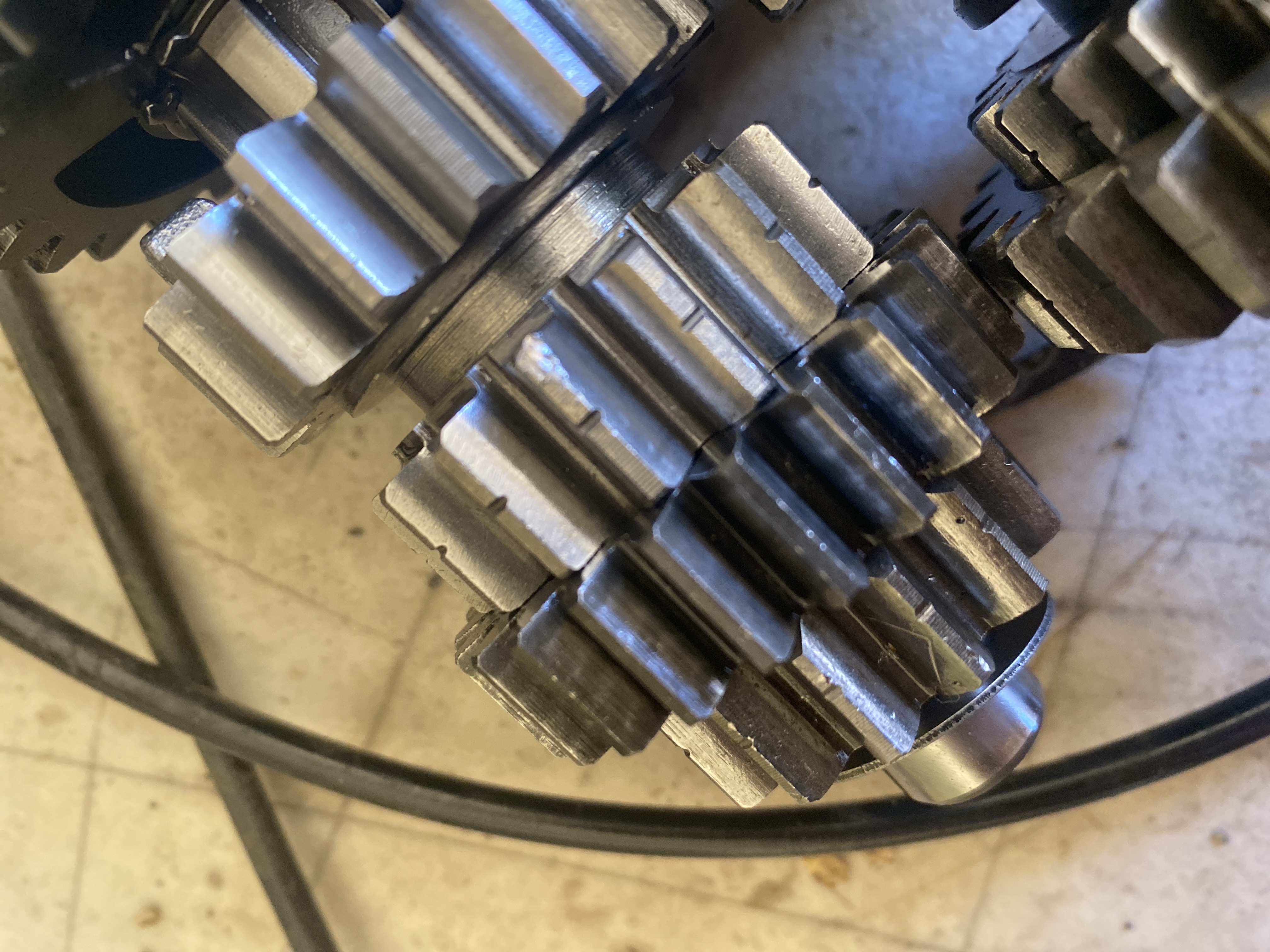

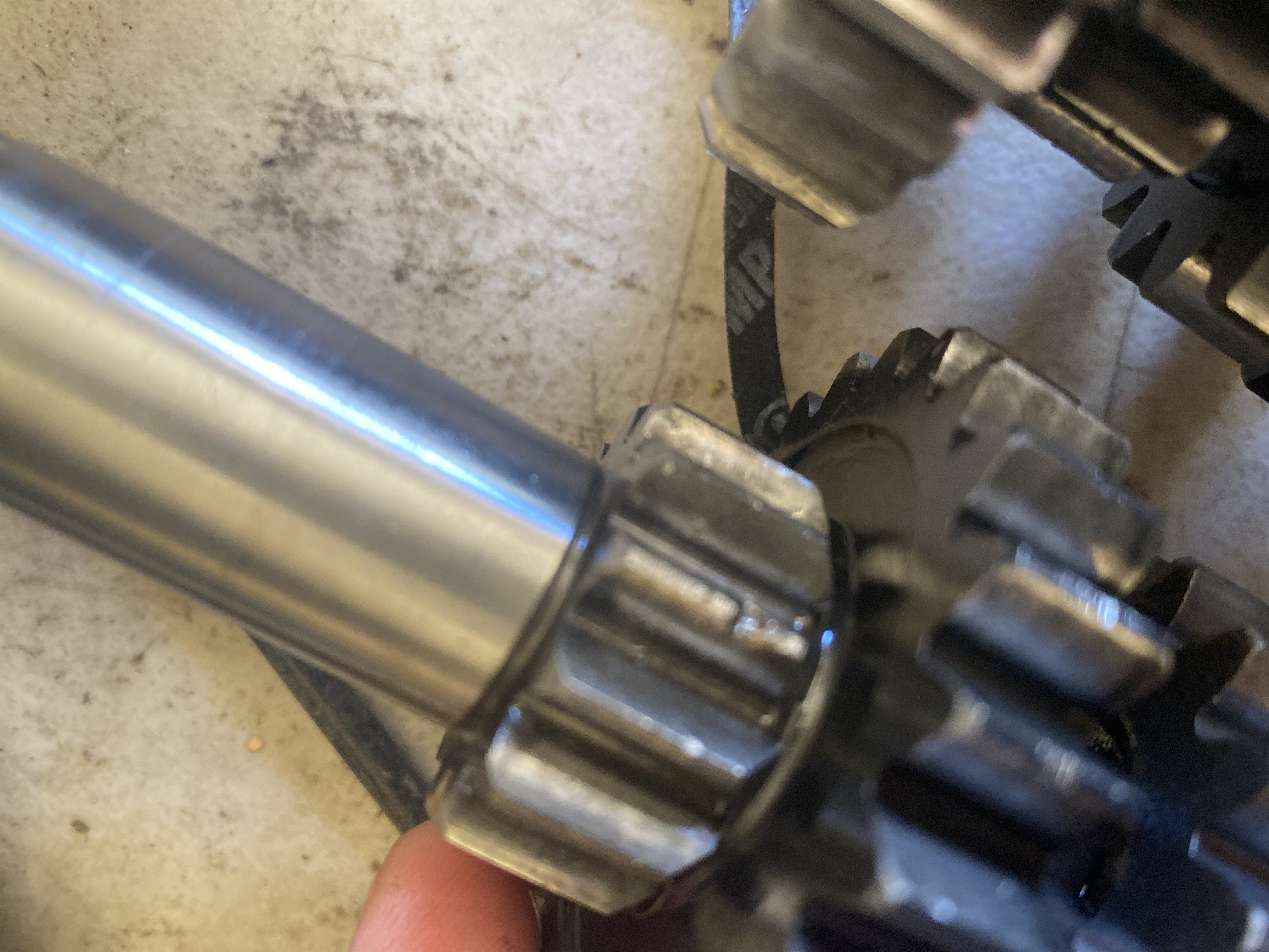

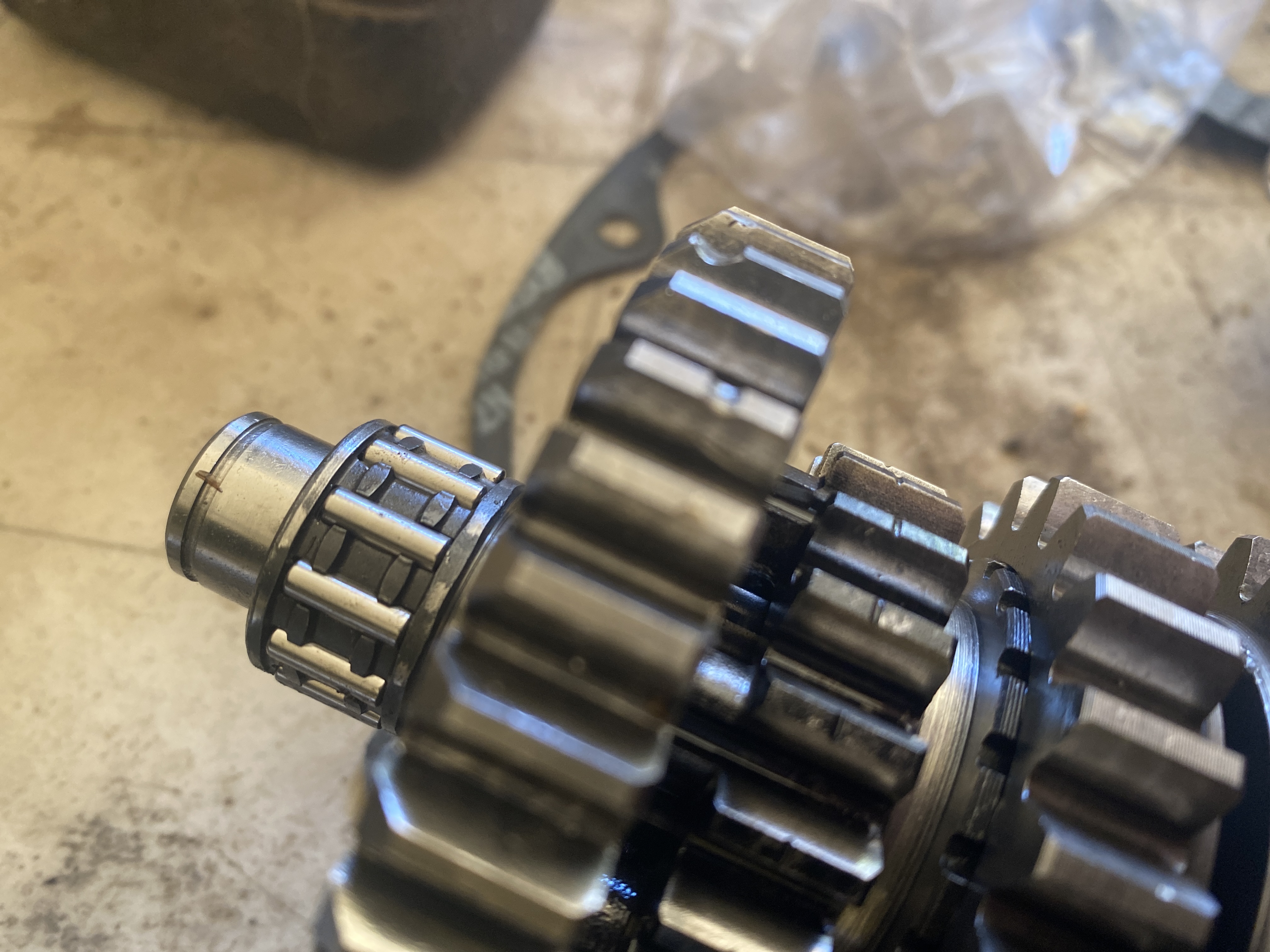

What do you think are these shot out or still usable
Posts: 1708
Been thanked: 19 times
No, I would not be using those gears.
Post by kdxdazz »
Can see the chips and damage in some of the gears, obviously you can't use them but other gears maybe salvageable
