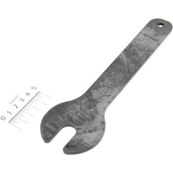

I just looked it up in the service manual. It doesn't say there is a torque value on tightening the cap. It is 11 foot-pounds for the nut against the cap. I would just wind the cap down snug, then tighten the nut against it.
You will need a fork spring holding tool or a helper to do this.
https://item-shopping.c.yimg.jp/i/n/hirochi_57001-1286
57001-1286 is the Kawasaki part number. You can make a homemade tool. I have the OEM tool and have used it on a friend's KLX300R forks he put on his 1197 KDX200, as well as other KDX / KX forks. It works great.
