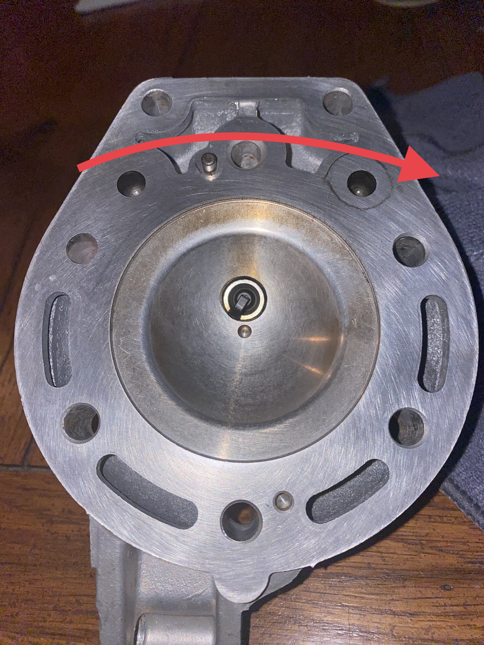

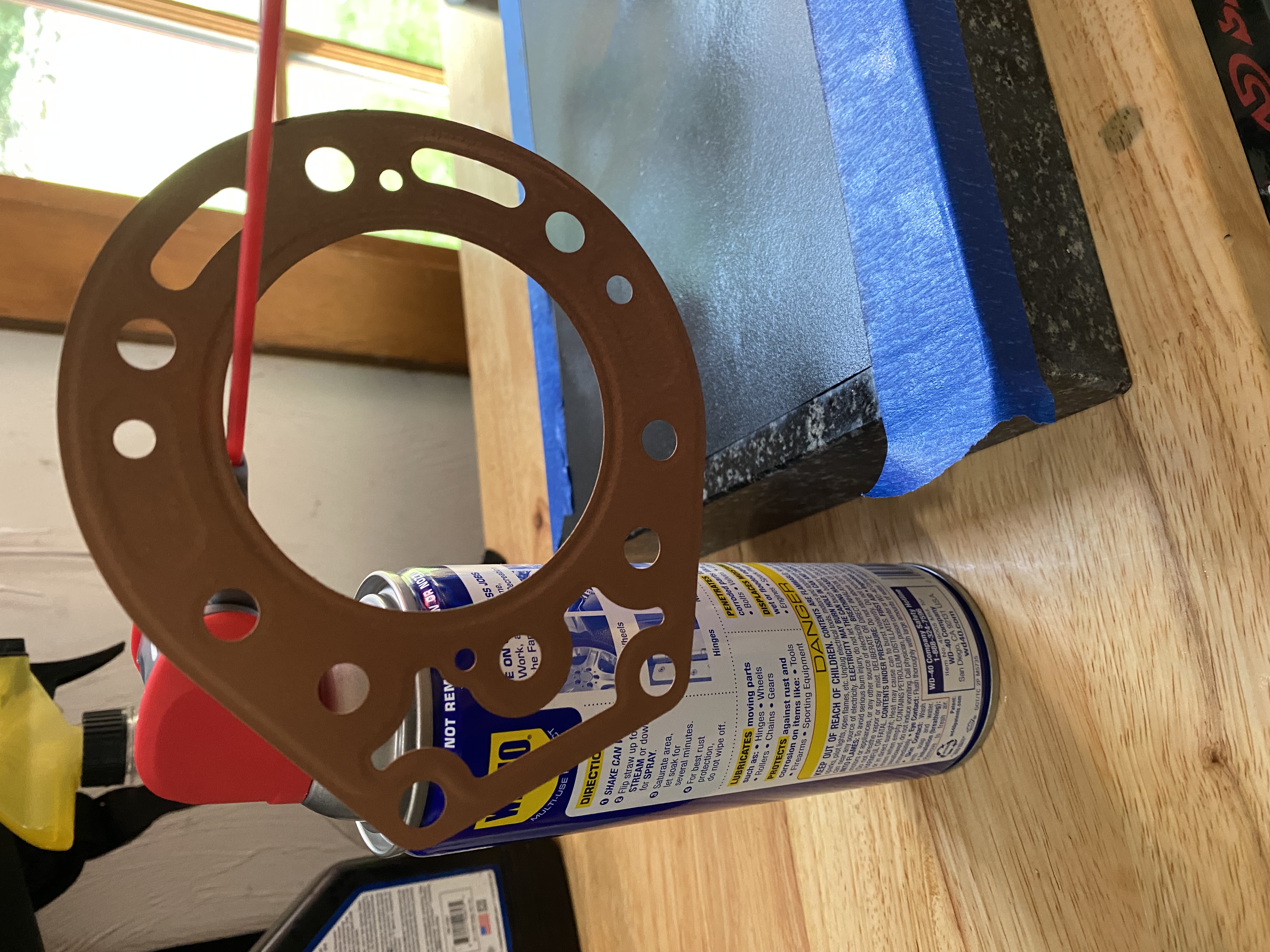

Called engine builder Ken O’Connor this morning. He told me to try the following:
1. Use 220 grit on a perfectly flat piece of material. I used a surfacing stone I purchased a few weeks ago and kept going. There was a low spot toward the exhaust side of the cylinder head crossing over the two weirdly shaped water ports. I kept sanding till the spot disappeared. I included a picture of where the low spot was using my stock head as an example. Ignore the point on the arrow. All above the contour of the curved was where the low spot was.
    2. Make sure the retaining pins were shortened to compensate for the RB head. I already shortened them but went a bit more.
      3. Permatex Copper spray a gasket on an oem headgasket. I sprayed both sides of the new oem head gasket and let sit for a half hour then installed. I prepped the surfaces with carb cleaner and then used rubbing alcohol and blew dry. I used my 1/4 torque wrench and worked up in increments of 2 foot pounds all the way up to 16 ft pounds.
      I then finished off with my electronic torque wrench set 18. I ended up torquing them to 20 ft pounds due to the nature of the electronic wrench.
        Noticed my cylinder already has markings on it that I could not feel with my finger. My old cylinder ended up with the same markings. I’m thinking it’s the coating on the wossner piston.
          I hope it works.

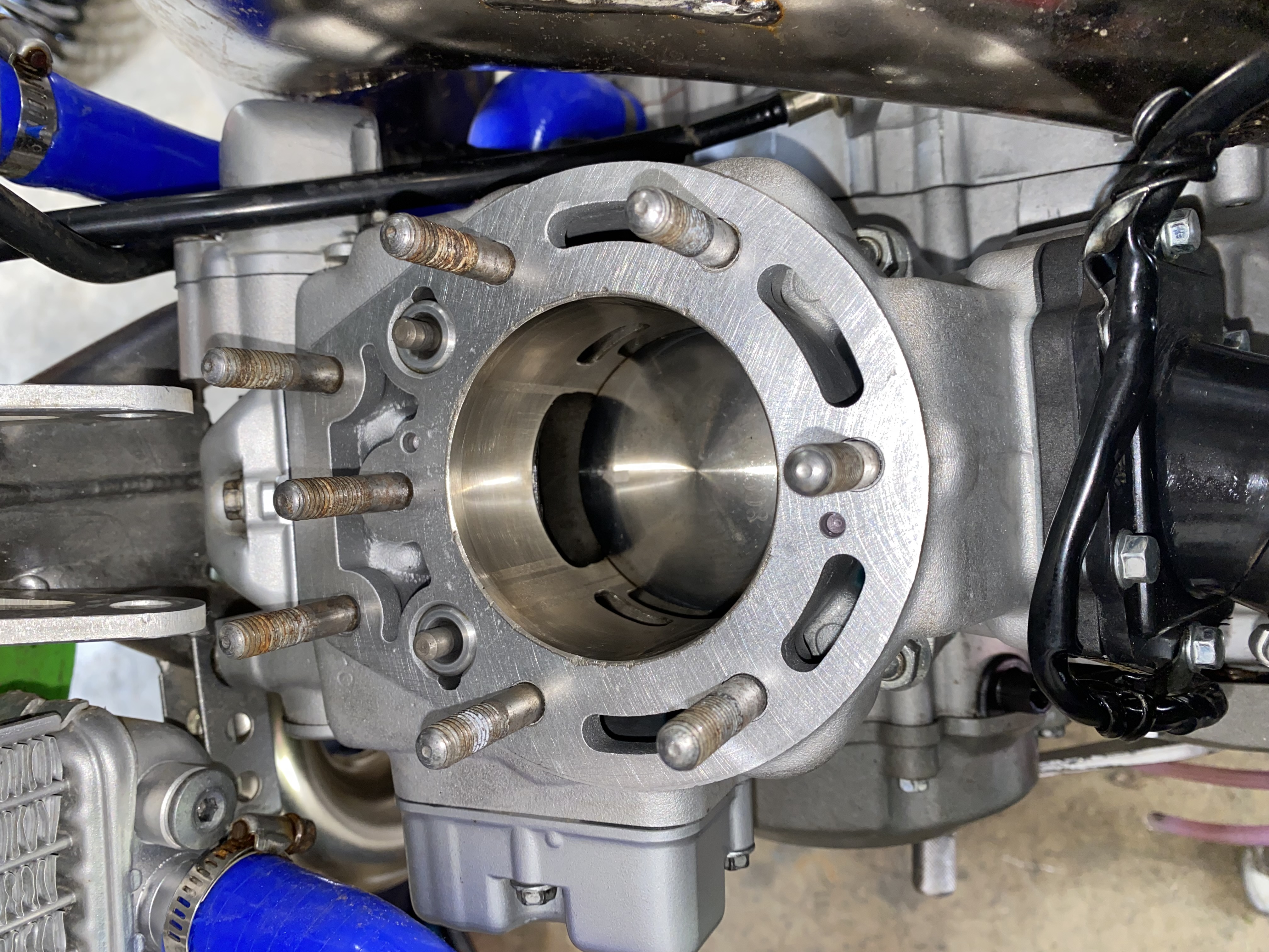

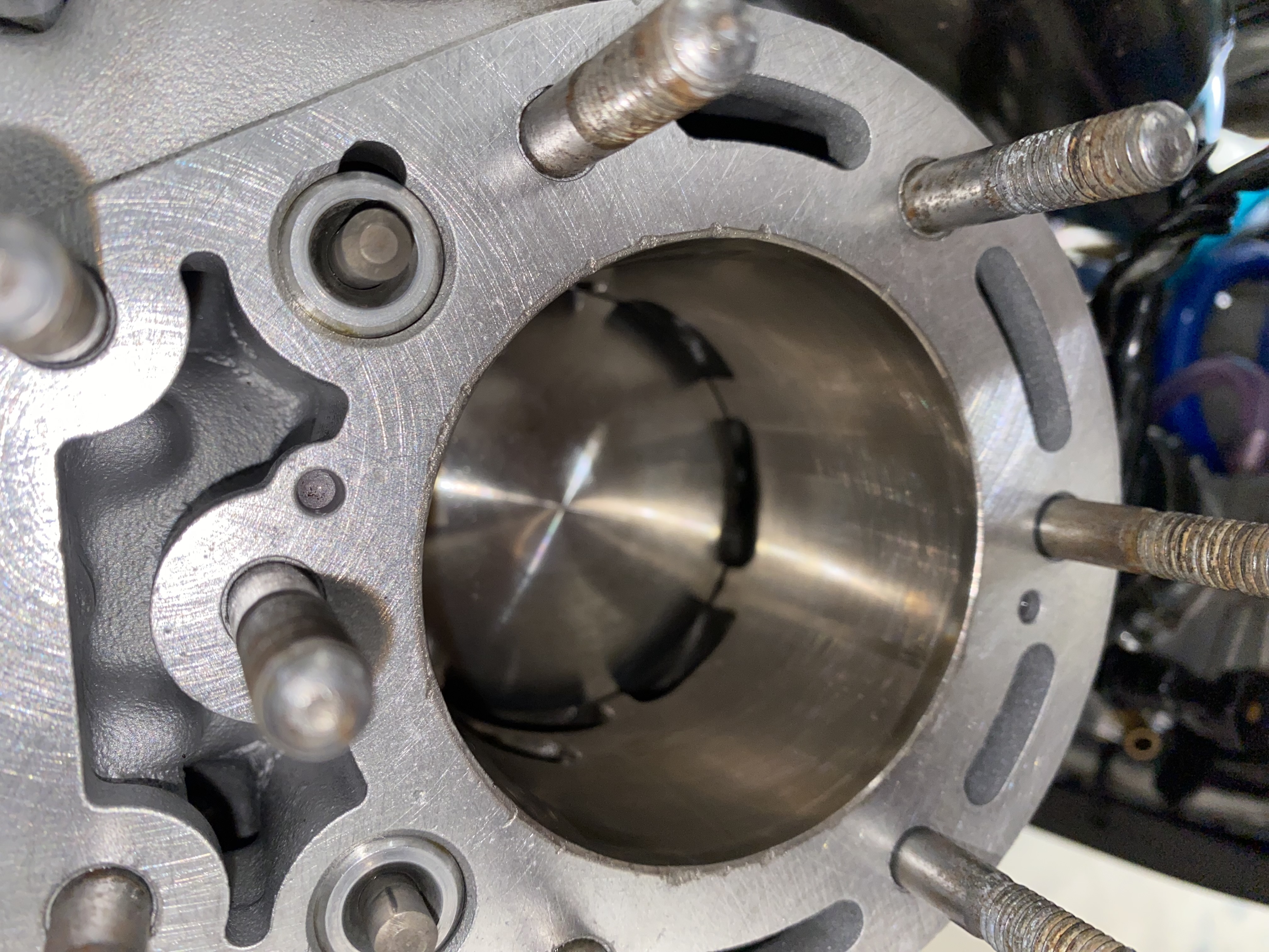

          your cylinder has some serious pitting around the top edge of the cylinder bore, is that cylinder the original nikasil coating or has it been redone at some point?
          you may have to take the cylinder off and try the same sanding technique but its unlikely you will remove all that pitting in which case a sleeve is your option. one of the reasons i went with a sleeve is they mill the top surface so you know its dead flat, i struggled for 6 months trying to solve head gasket issues so i'm well versed in this, did you get the pin shortening idea from my youtube channel?
          as you remove the cylinder head each time take photos of the cylinder and cylinder head surface, you should see oil leaking past the head gasket
          i also tried permatex but think its a useless messy product, threebond 1211 is better
          the OEM gaskets come from the factory with a sealant thats why you can't touch the surface before you put it on, you can use mineral spirits and scotch bright to remove all the old sealant so you can reuse the OEM head gasket

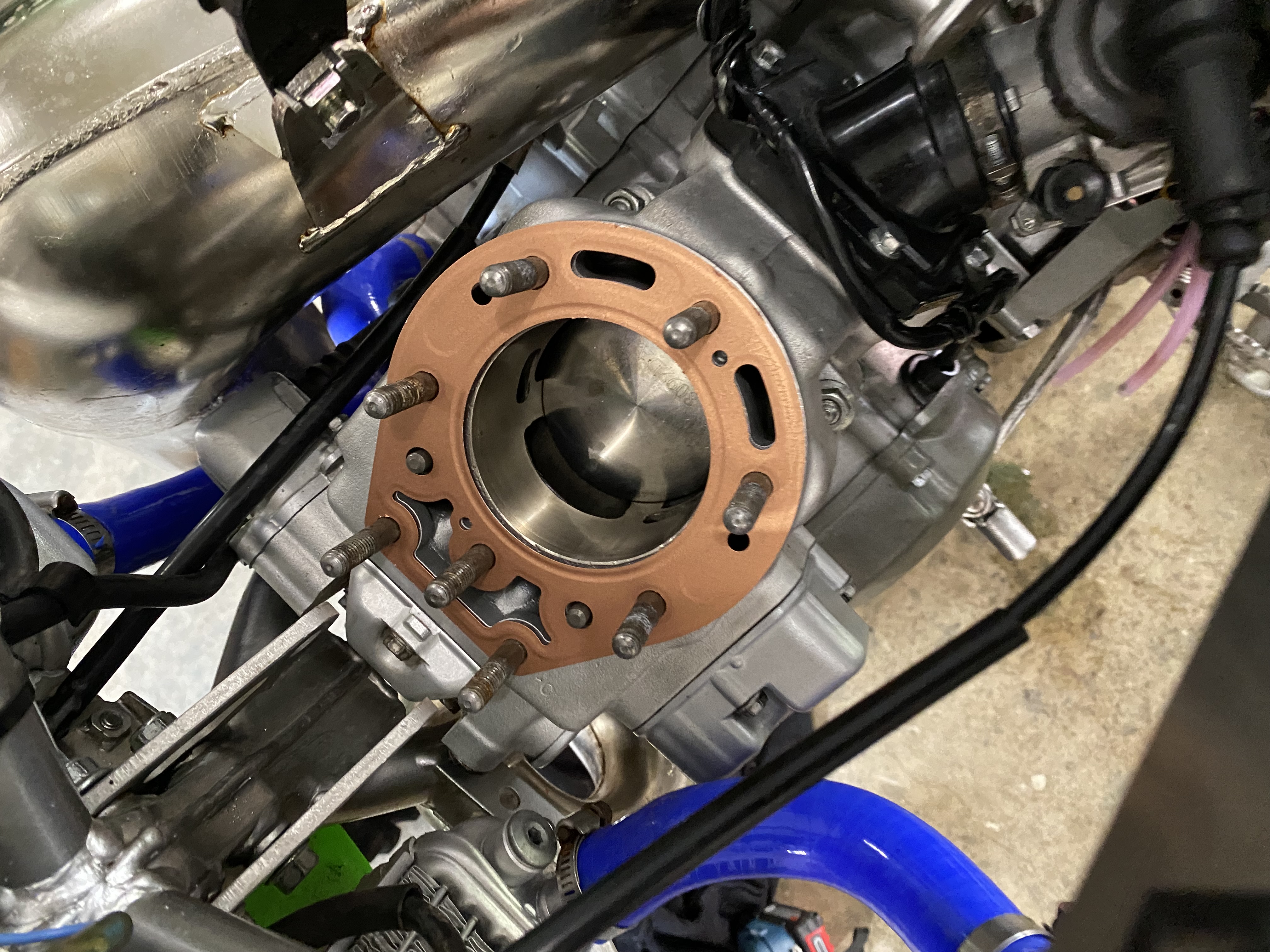

          forgot to say if you can't get the pits out then a custom made copper head gasket might be an option, i got mine laser cut from 0.8mm copper, granted i am in thailand where costs are cheaper, cost me 18 US dollars
