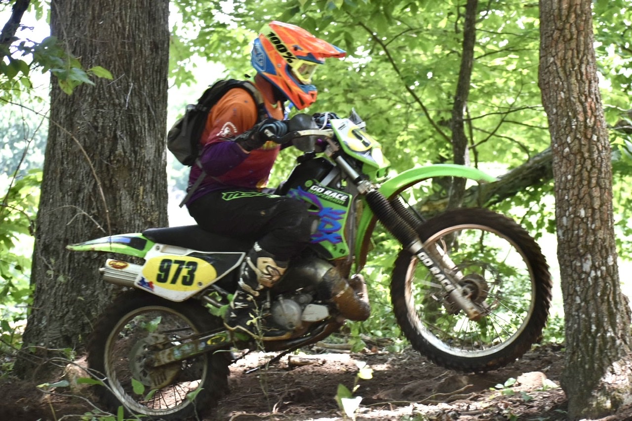

As far as success racing this bike…
I just started in racing hare scrambles in C last year. I was a successful mountain bike racer for twenty years before that. In my first season I improved a lot, worked really hard at it. Got some podiums and a hole shot. Finished 4th in the series and then moved up to B this year so I could race the same event as my son. I’m told by my suspension guru that this bike requires more skill and strength to ride fast than the newer bikes. The modern geometry, lighter weight, and longer wheel base of the newer bikes is an advantage in a lot of places… HOWEVER the KDX can make enough power and is good enough in the right hands to beat everything out there in the tight woods.
Mine was raced last year by a talented young 250A class kid [with a broken power valve - we didn’t know!) in the main event and finished in the top ten of the overall of a 130 racers. His Husqy 300 bike was broke and I loaned it to him so he could earn points, he went on and won the championship.
That day I rode the morning event and finished 3rd in 50+C and it needed a top end, it was fouling plugs at the start and I was pissed. I missed the start changing a plug, but ended up having a great day. The bike didn’t have the desert pipe that’s on it now or the cylinder porting (that he did for me), or the RADvalve, or Fredette’s carb jetting, but it was on the stock forks that we put a Belgian valve job into (like RaceTech Gold valves but a little different). I love these forks, to me they feel better than anything else in the woods that I’ve ridden. They just don’t beat me up and I’ve raced 6hours on them feeling like I could pull another lap if I had to. Maybe not the greatest for motocross, but for woods they suit me fine.
Anyways I’m still learning and improving some, racing in B has been a lot of fun and I’ve gotten some results and another hole shot. Putting the shorter kicker on helps that.
