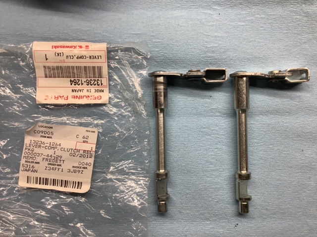

UPDATE… picked up a brand new in the package KDX clutch actuator from Fredette! I pulled out my old one for a side by side comparison - see pix. My buddy is going to weld a 3/8” extension on to the new one using the old one. Should have pix of it all later this week.
Also awaiting a new Streamline Reflex clutch perch/lever from RM. My clutch cable has less than a year on it, is freshly lubed and ready to go.

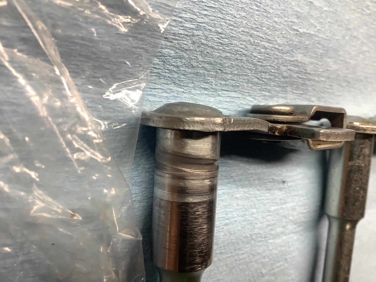

You can really see the grooves worn into the old shaft allowing oil to bypass the clutch cover seal.

Thanks for the pics of wear comparison.

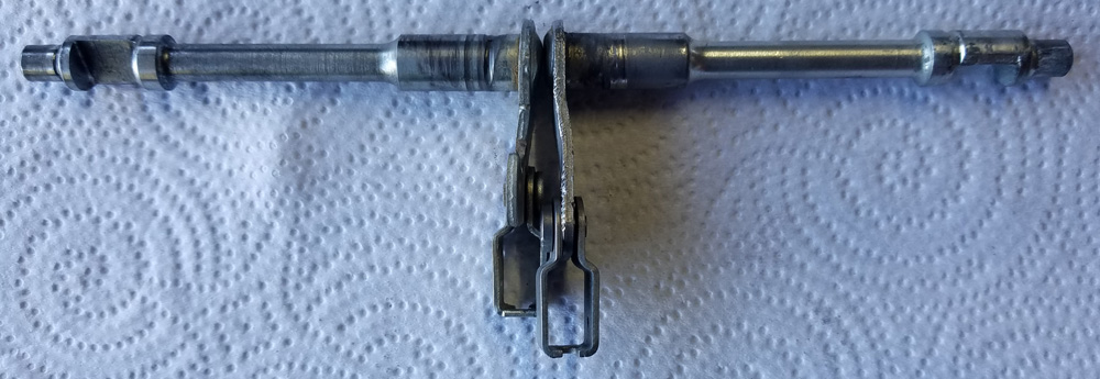

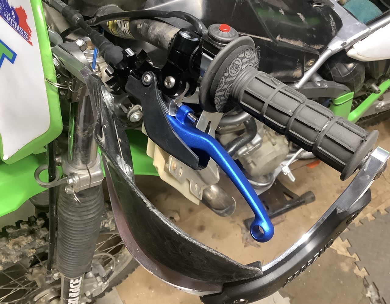

Happy day! Has taken awhile to get here, but it’s finally done. We welded 3/8ths” on and I painted the weld with some silver rattle can. Hoping to test ride and get a feel for the changes in the morning. On the stand the easier pull was apparent. The new lever is smoother too, the ball bearings feel nice and smooth. Installed a fresh oil seal and Kawasaki clutch cover gasket too. Looking forward to not smearing oil all over everything.
Old piece versus the extended new piece… New Streamline Pro Reflex Clutch Lever… Will update tomorrow after buttoning everything back up and testing her out.

With all the pieces in place (at 11:30 pm!) I had to wait until this morning to shake her down. Immediately noticed the hydraulic clutch-like feel on the new lever, the actuator definitely lightens the pull in an appreciable amount too. However, after warming up and clicking in gear - when I released the buttery smooth lever nothing happened - which I sort of expected since I hadn’t adjusted the cable length yet.
So I figured I had her too short and cranked the cable adjuster to the extreme extended length. Fired, her up, clicked a gear, released the silky-smooth lever and NUTHiN’. Hmmm… I must be missing something, looking down at the actuator I could tell the arm wasn’t swung back properly. Somehow my cable was still too short to allow the actuator to disengage. Time to re-examine the assembly instructions on the new lever. After removing an un-needed cable housing extender from the lever I was able to make it work properly.
This is not needed for my application.

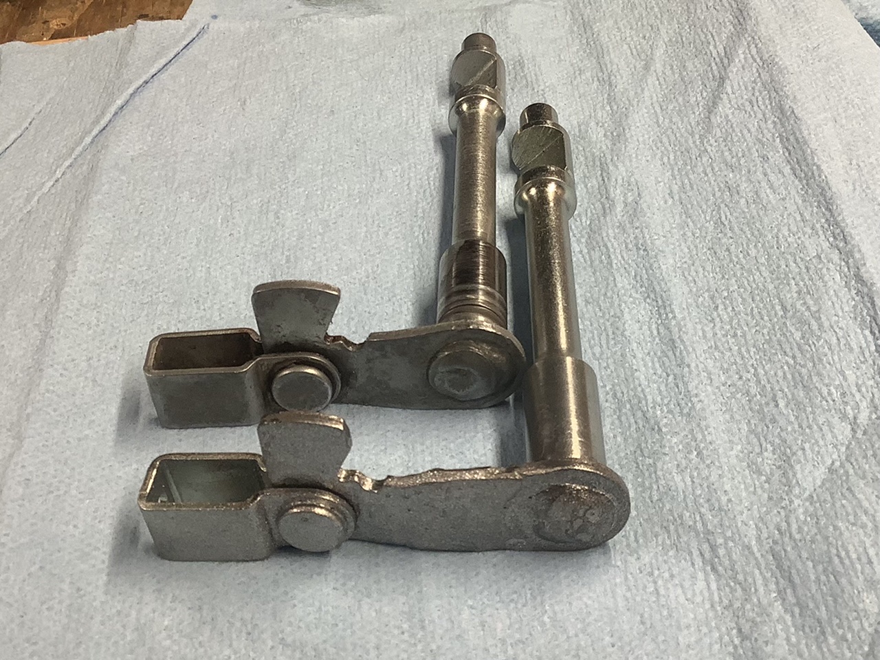

One last final tweak was required for this modification. The extra length of the modified foot ends up using all of your available clutch cable free play. I spoke with Jeff Fredette about this and he suggested creating a “slight dog leg” in the foot near the end. This would bring the cable head catch towards the cable and create the slack I needed.
By putting the piece in a soft jaws clamp and using a sawzall, a slit was cut about 4/5ths the width of the foot on the leading (forward) side, then gently tapped the end with a hammer to close the gap. This gave me 1/8” of forward reach, I decided I wanted just a little more so I carefully reopened the gap and using an abrasive cutting disc widened the cut to about twice the saw blade thickness. After closing the gap by tapping it shut again, welding the seam, and grinding it smooth I ended up with about a 1/4” of improvement.
While I had the opportunity, I used my Dremel to grind in a small groove for the spring hook to rest in just like the stock part originally had. After cleaning it up, I sprayed some silver paint to finish the job.
Testing this modification was extremely gratifying as I was able to introduce slack back into the cable at both the cable juncture and the lever to achieve the desired free play. My clutch feels as easy and smooth as a hydraulic and I’ll never need to bleed it.

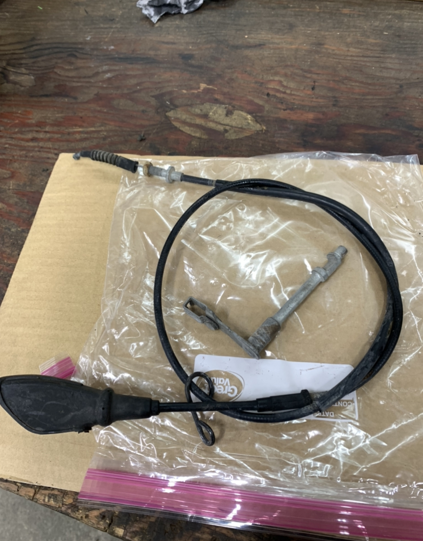

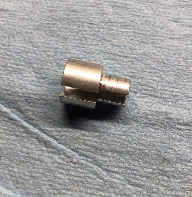

This just sounds too good to be true! But for $30, how could I resist. eBay delivery arrived, yesterday.
