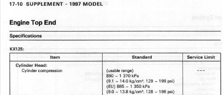

Hi all, I've recently acquired a 1994 KX125 with a 1997 top end. So my question is what is a good range of psi when running a compression test. I ran 165 psi, I've heard for a healthy 125 the psi should read anything above 150 psi.
Posts: 14738
Has thanked: 173 times
Been thanked: 44 times
Re: KX125 compression specs
1997 KX125 Compression.png (158.18 KiB) Viewed 10316 times
