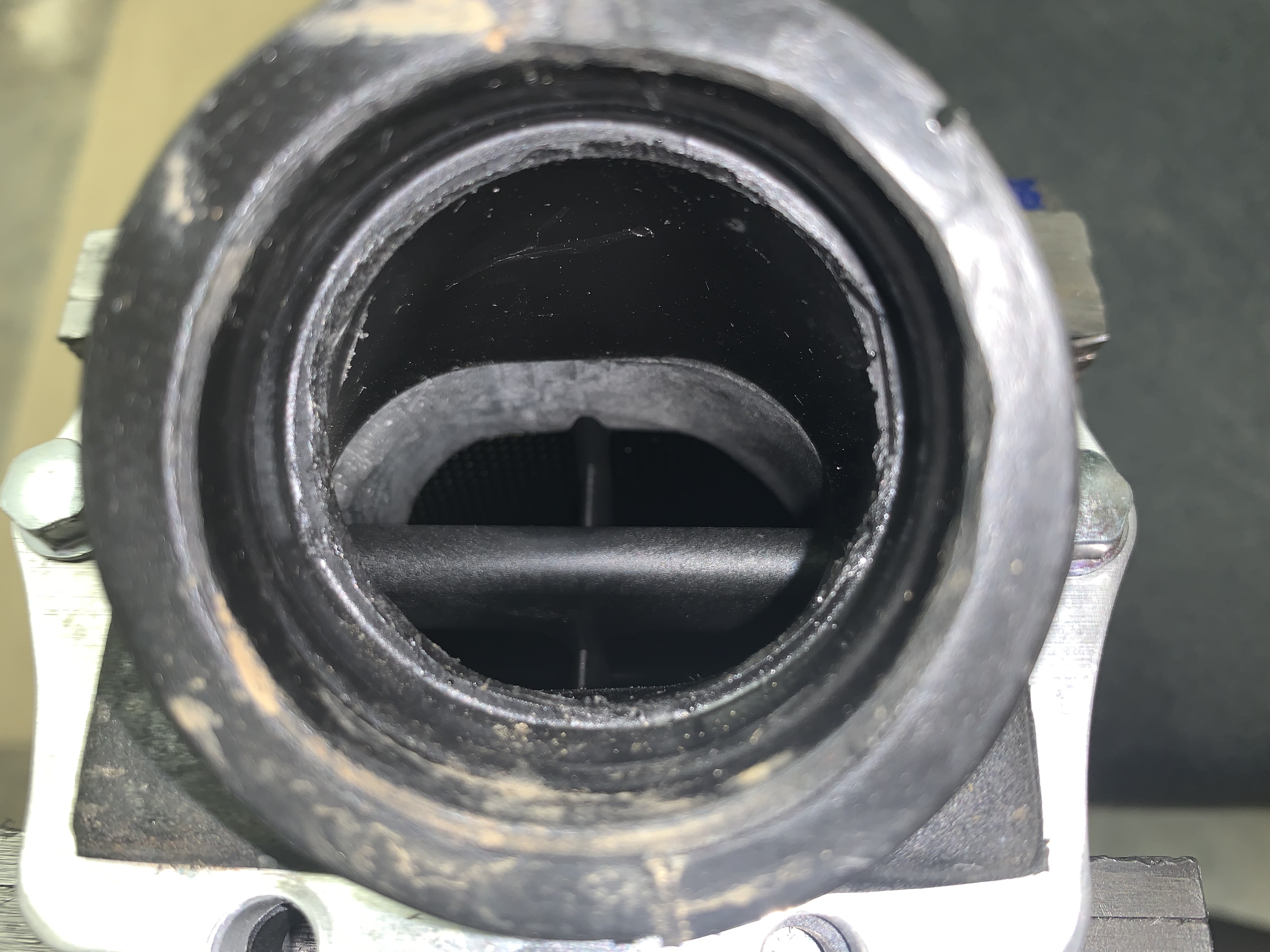

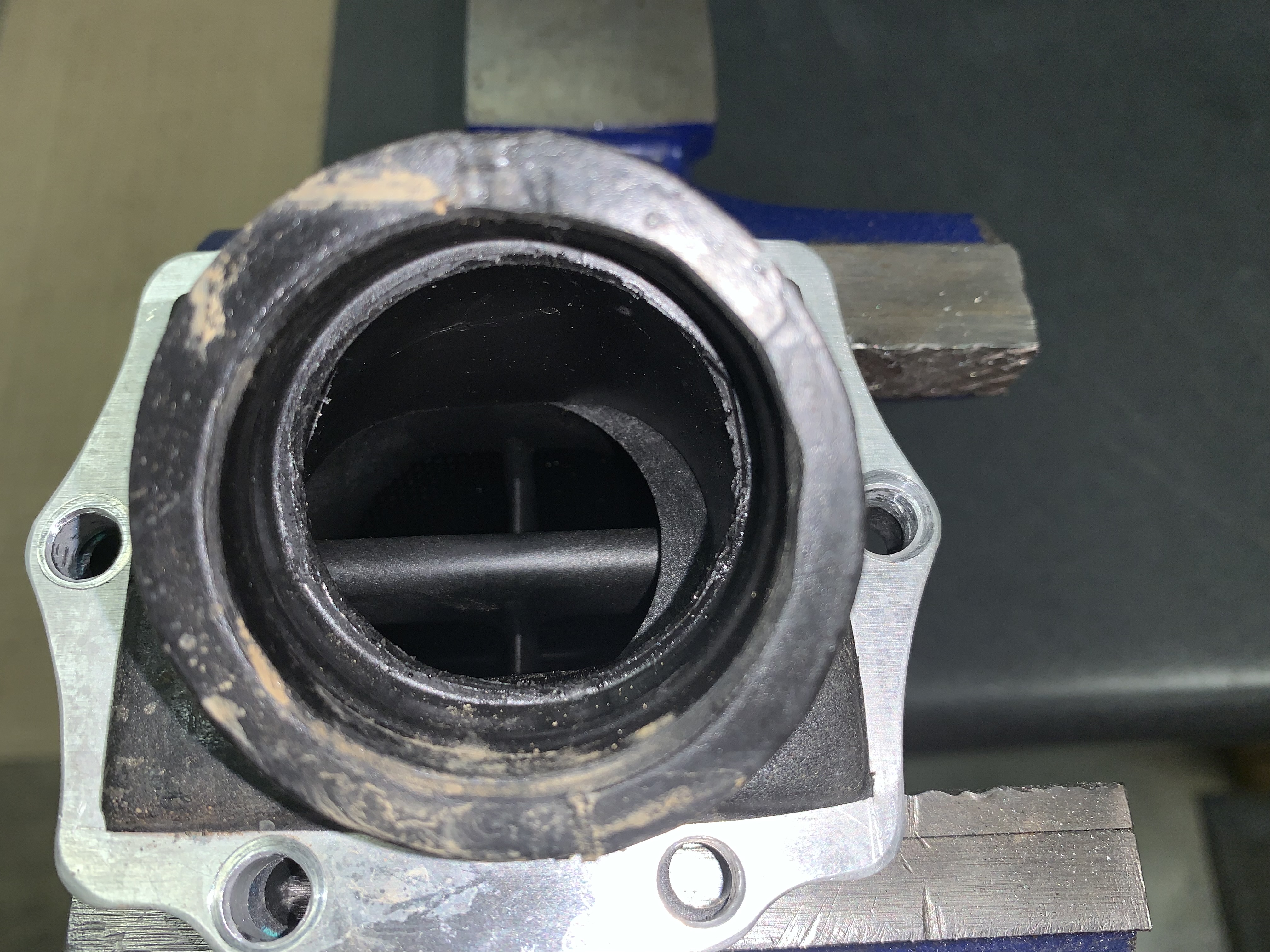

I put a VForce3 reed system on my '84 KDX200 and noticed the "vane" in the new reed cage doesn't line up with the stock intake boot. I rotated the vane 180 degrees and have a similar result. Is this normal for these VForce systems?

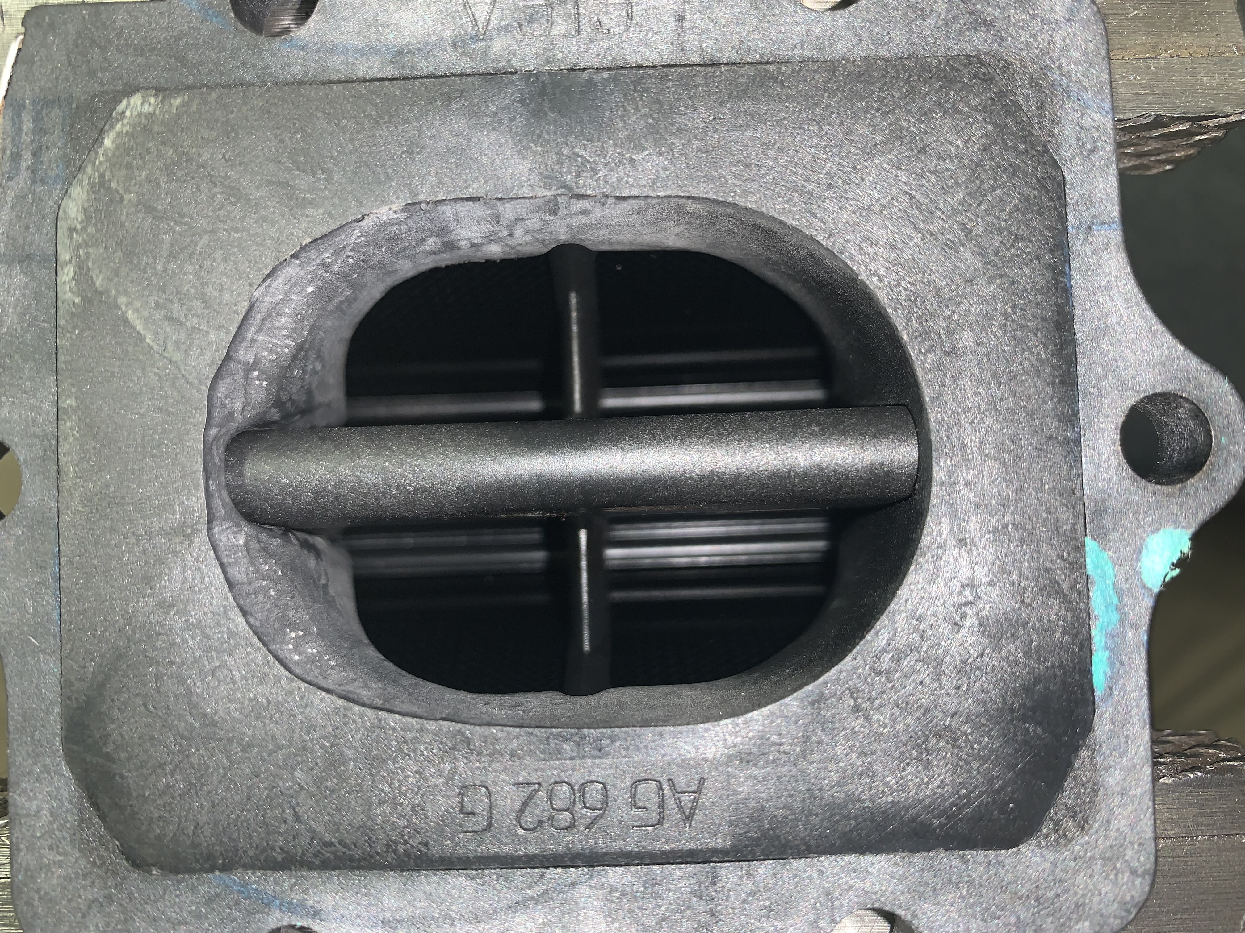

Yes they did. I sent them a note and they responded today with the recommendation to "port" the air guide. I did that with a Dremel and it looks pretty good. Just a bit surprised they didn't mention that in the installation instructions.
Re: VForce3 on an '84 KDX200
I guess that is about all you could do. Throw a pic up if you can.

Here are the "after" pictures after porting the VForce air guide. My technique was with a Dremel on the hard plastic material, finished with 600 emory paper. The surface feels pretty smooth to the touch, so hopefully no unwanted turbulence will be created.
Hey, looks much better!
