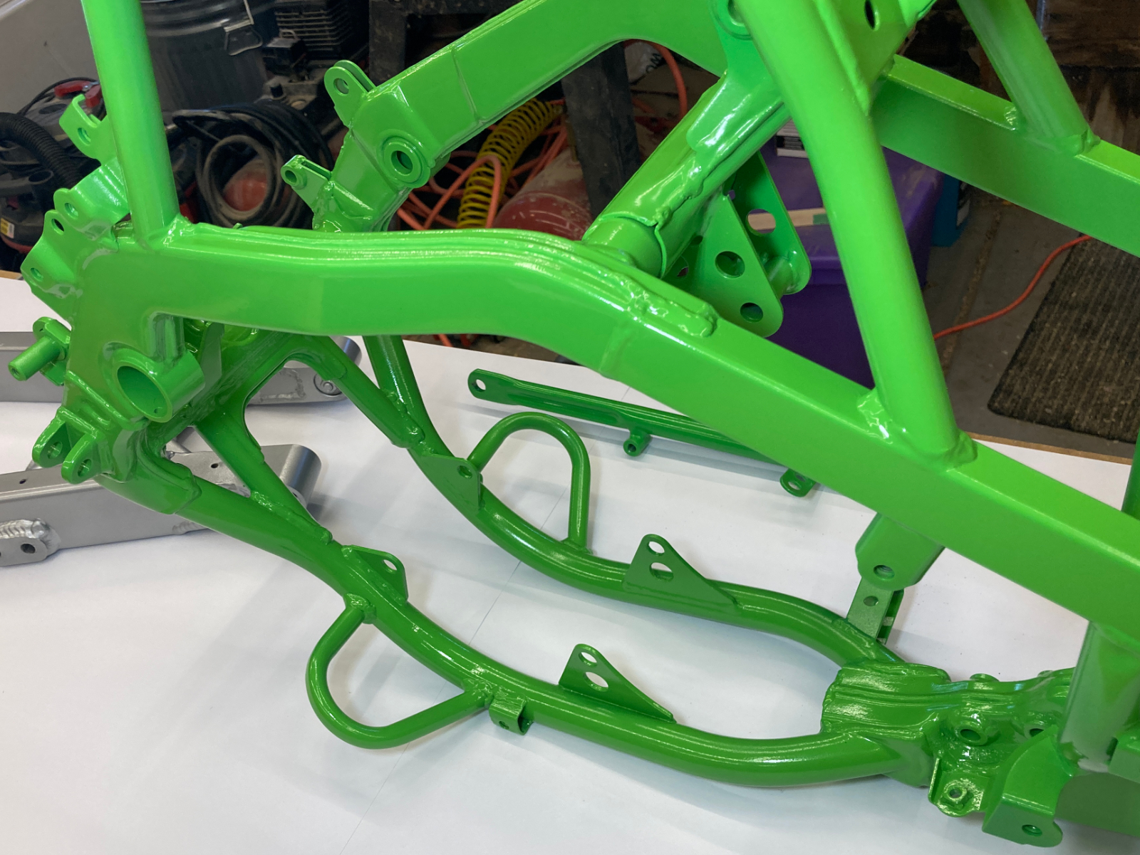

I just finished frame paint and did 2/2/2 primer/color/clear. Doing a third can of color, like KDXG suggested, might be a good idea for some of the tighter spots or thinner edges.
Duplicolor engine enamel. Grabber Green on the color. Nearly identical to the plastics color. Found it local and cheaper at Advanced Auto. Around $8 a can if you order online and pickup or delivered vs in-store which oddly was a little more.
https://shop.advanceautoparts.com/p/dup ... /7140041-p
Take your time. I let it cure for at least 24 hours between primer, color, and clear. The directions say let it dry like 10-15 minutes between coats of same material.
Re: 98 KDX200 Paint
Man. Looks good!

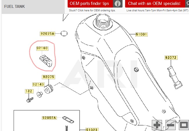

are the right angle gas tank bumpers still available ?
thanks Mark
she might be older but still a fun ride.
TheYakk220r
Posts: 51
Joined: 11:05 pm Jan 06 2021
Country: Colorado USA
Re: 98 KDX200 Paint
Post by TheYakk220r »
Yes, OEM. Check RMATV or Partzila.
DAMPER,FUEL TANK
Part# 92160-1328
Price: $4.83
