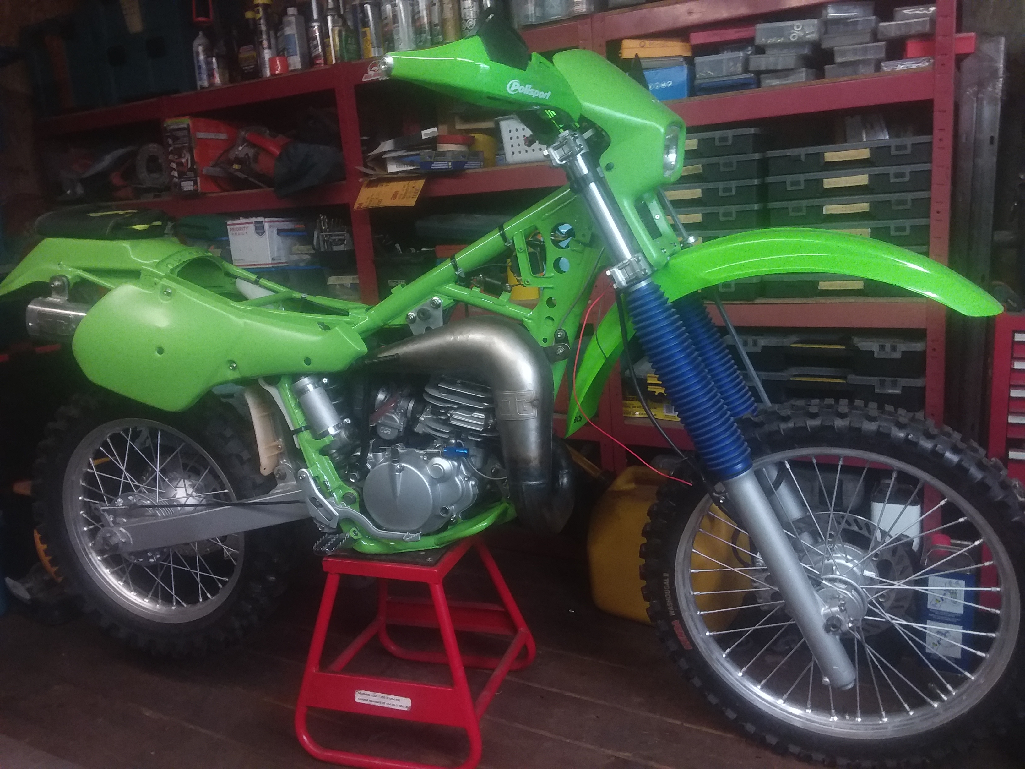

1988 KDX200 C3 rebuild . Titanium bolts everywhere , 12v 85 watt conversion , 2003 kdx front end with original electric trip counter , hydraulic clutch conversion , Allballs linkage bearing kit fitted . Full DG system . PWK air striker with 88 choke mechanism fitted and idle screw moved over to the other side for access .
Everything else fully rebuild ,
Will post some more pictures when I finish it ..

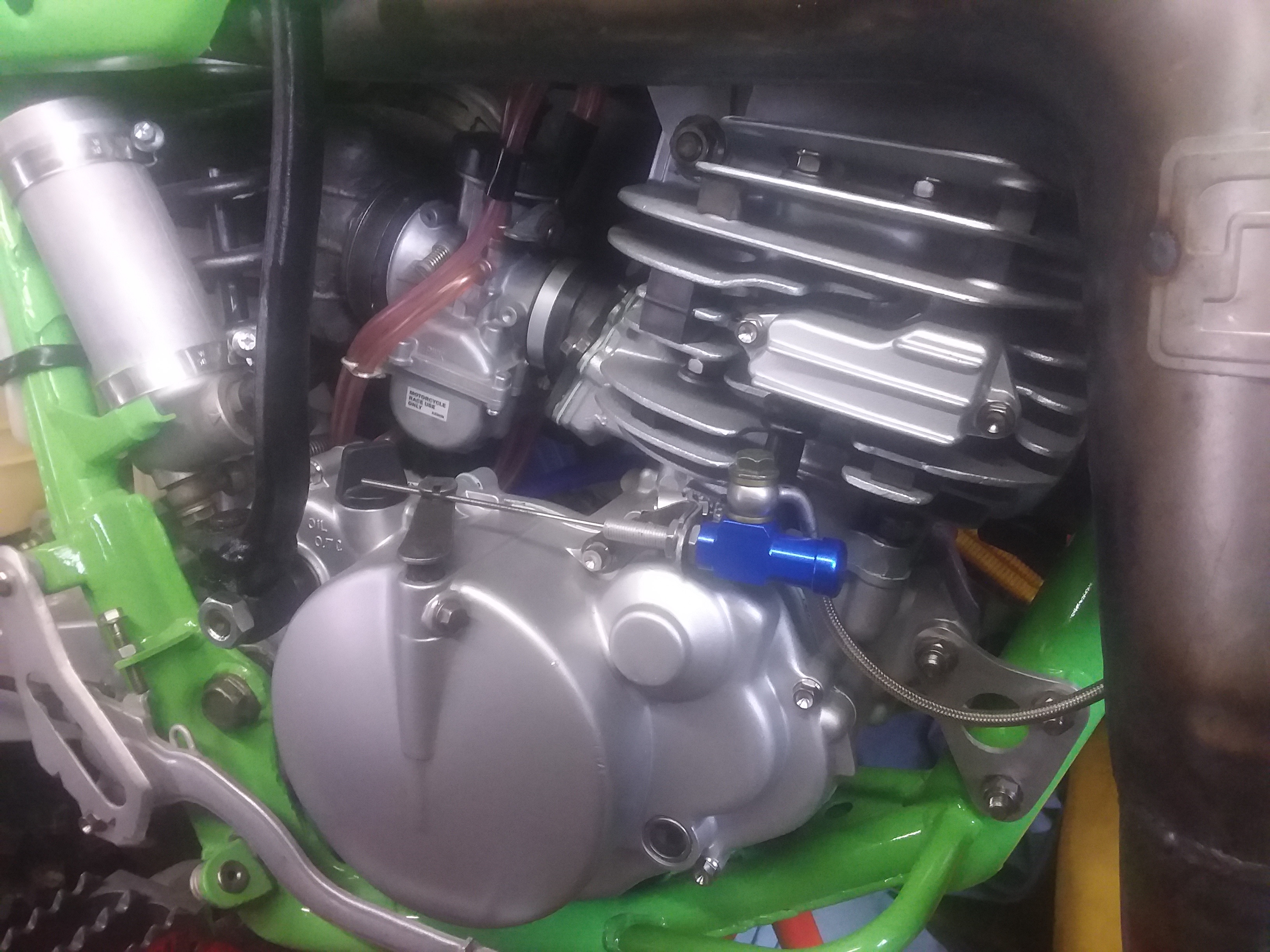

The 12 volt conversion was from Ricky Stator . 85 W high output lighting coil with a floating ground .
Basically if you cut the ground wire on the coil and connect it to the the original power wire you get 12 volts . I added a 12 v regulator/rectifier from Ricky and a 12v capacitor , instead of a battery . Limited space !!

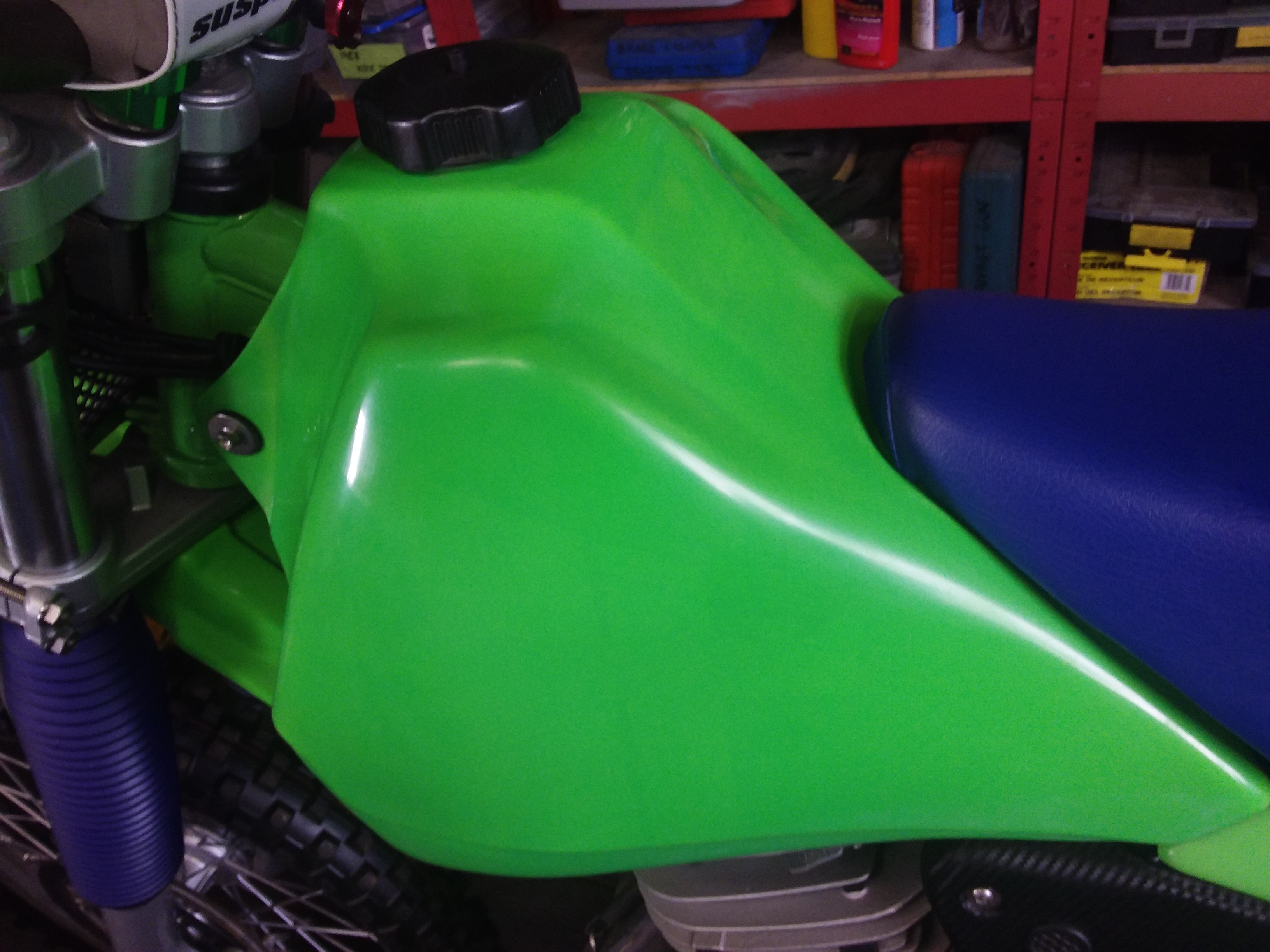

Update , finally got the tank finished and now just finishing off little bits and waiting for decals .

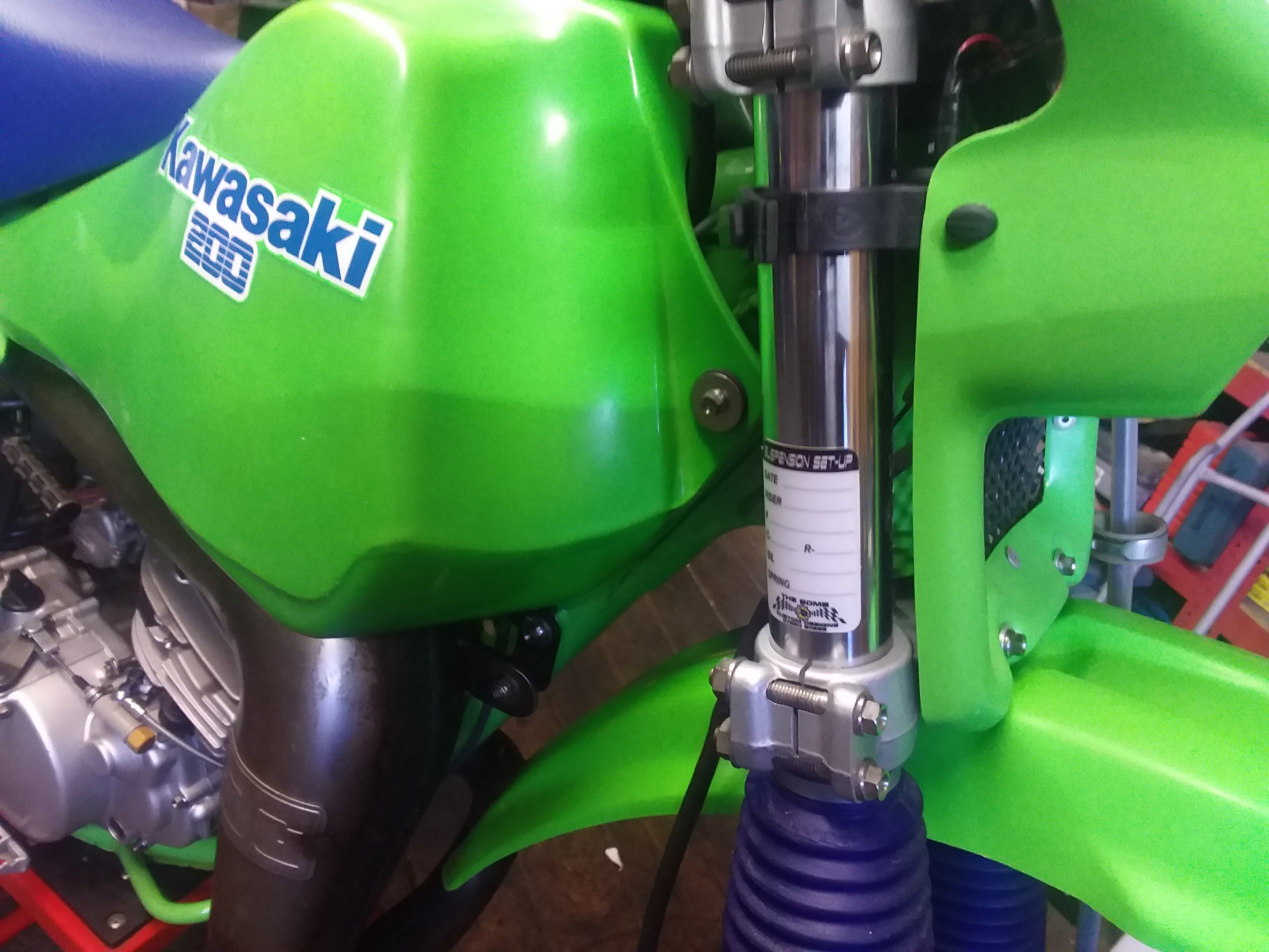

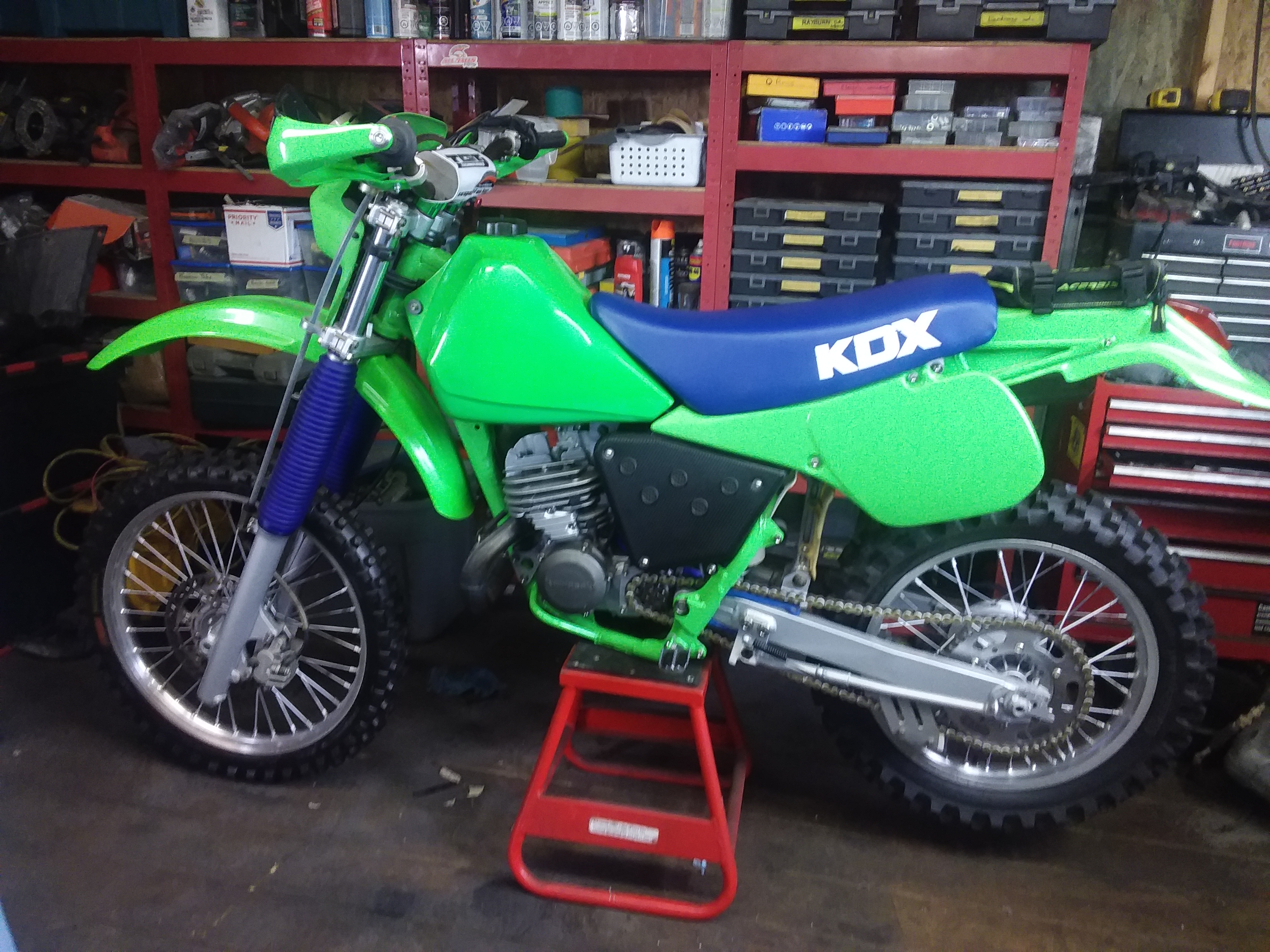

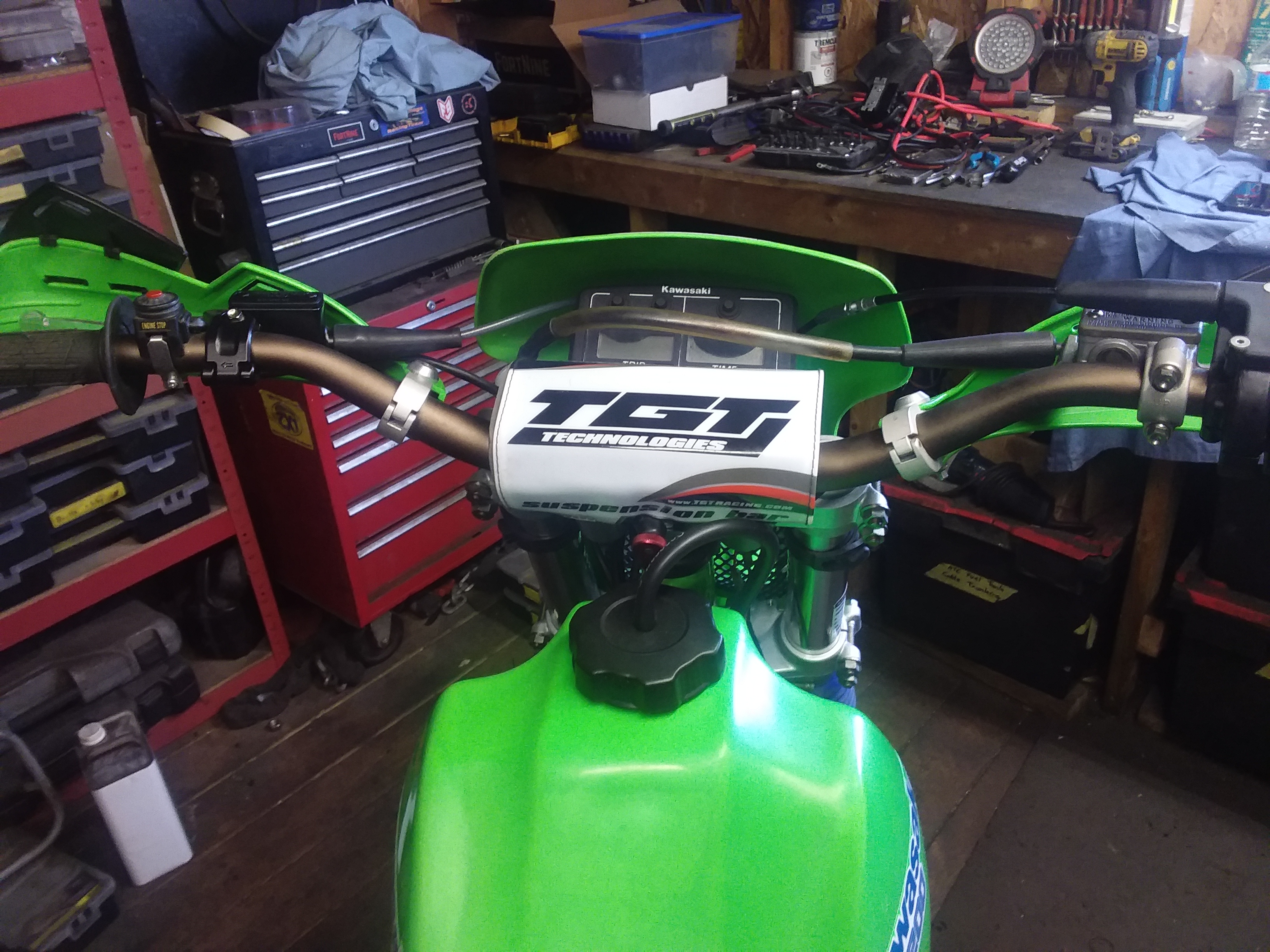

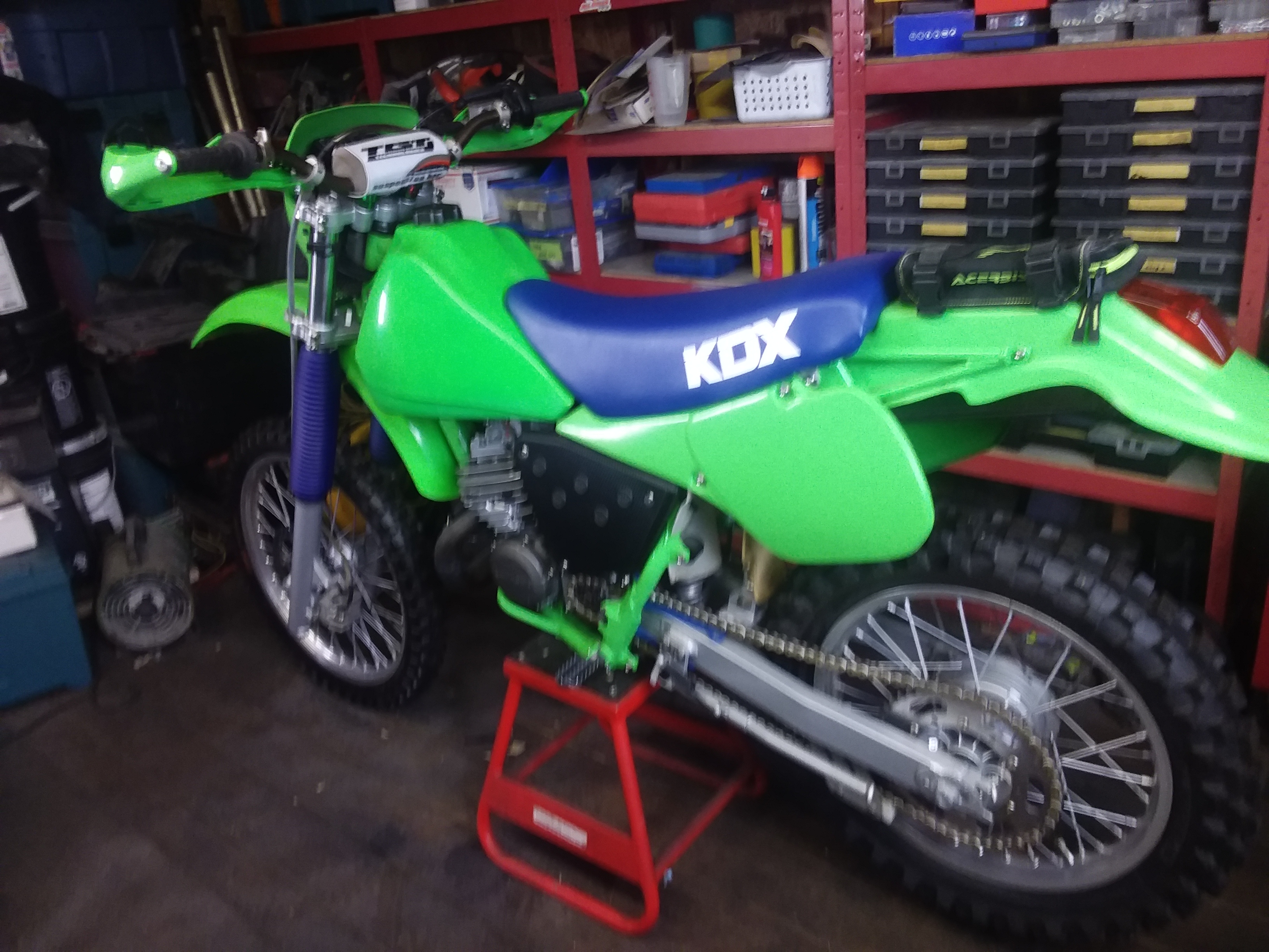

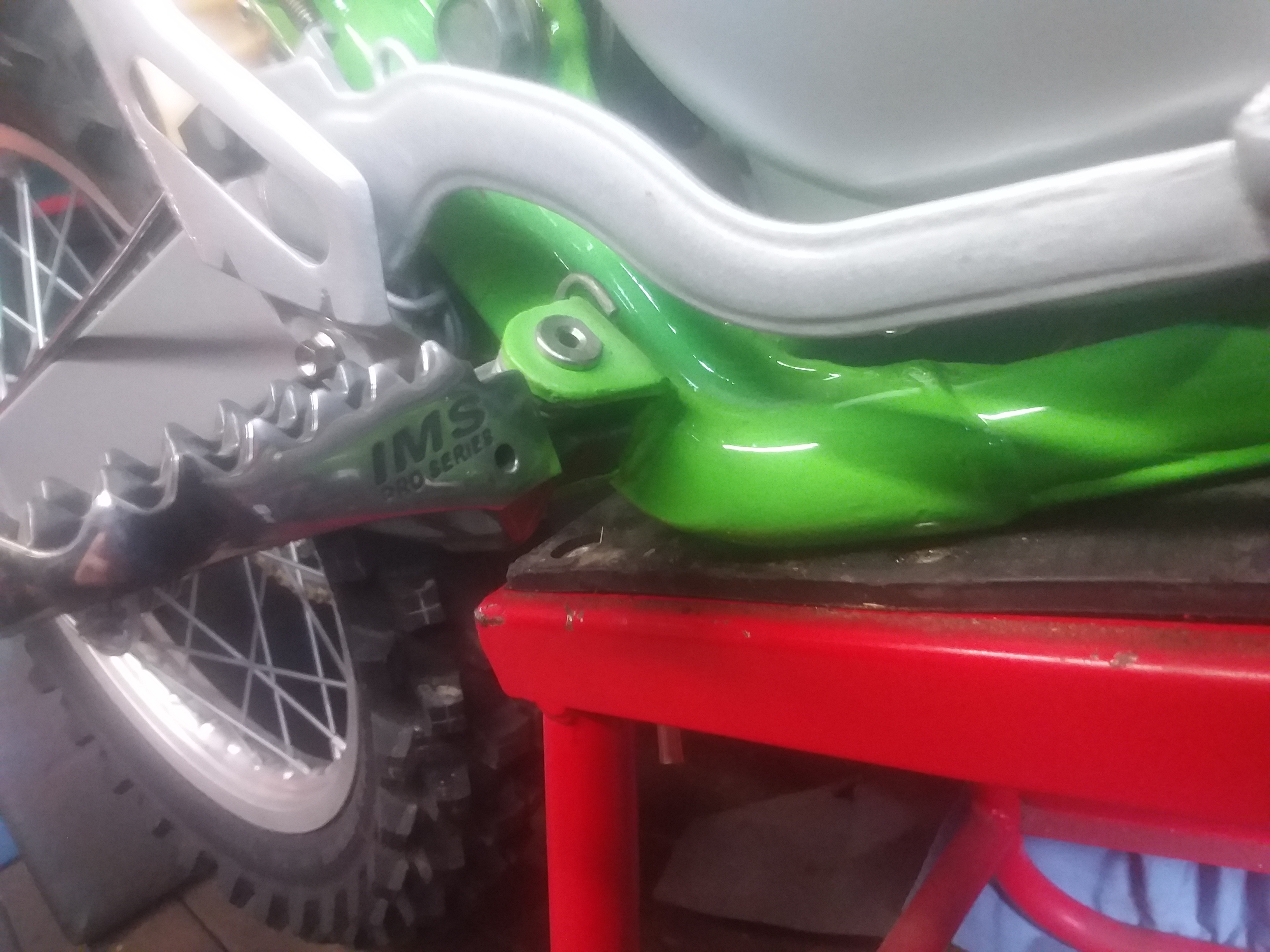

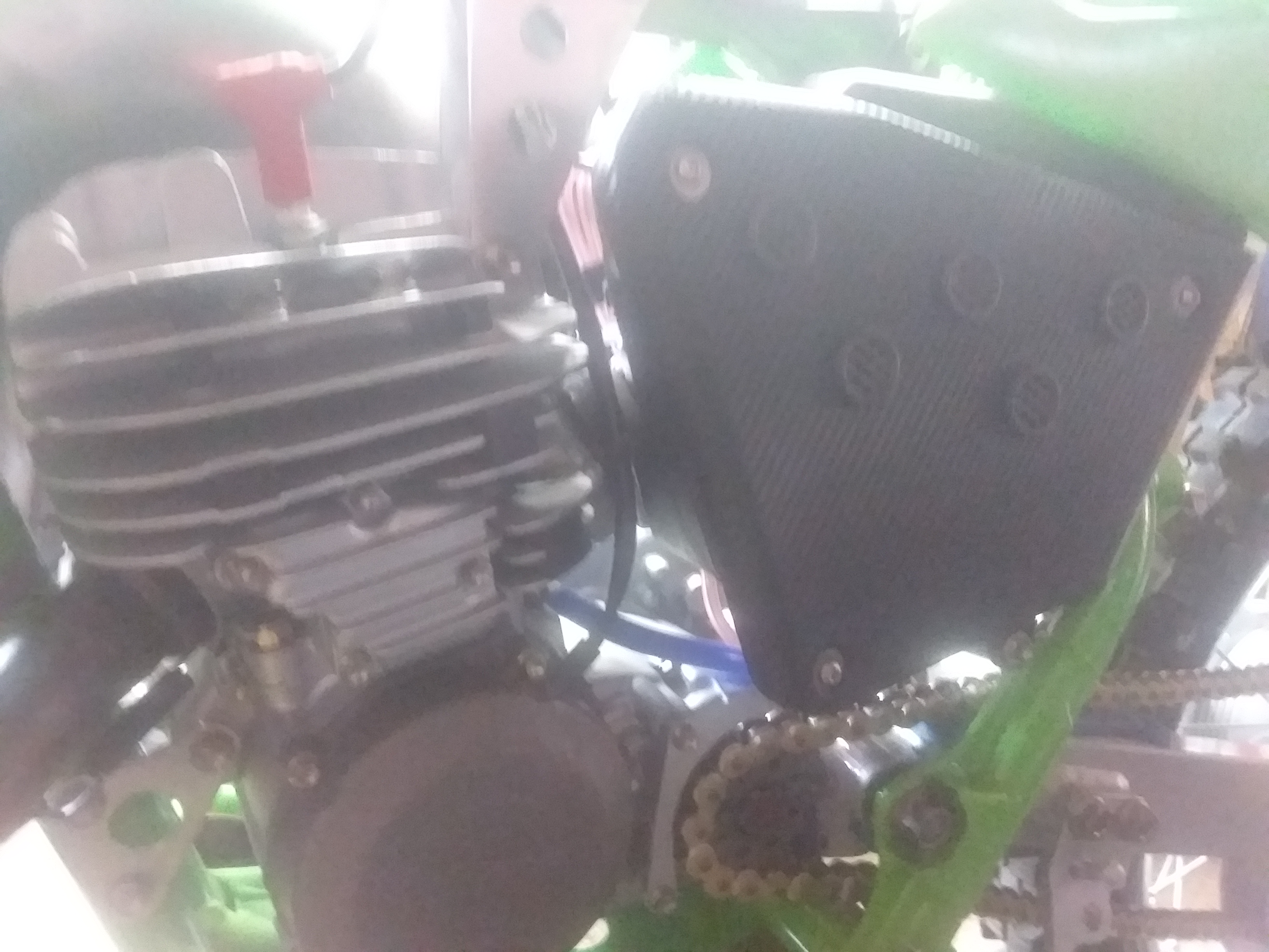

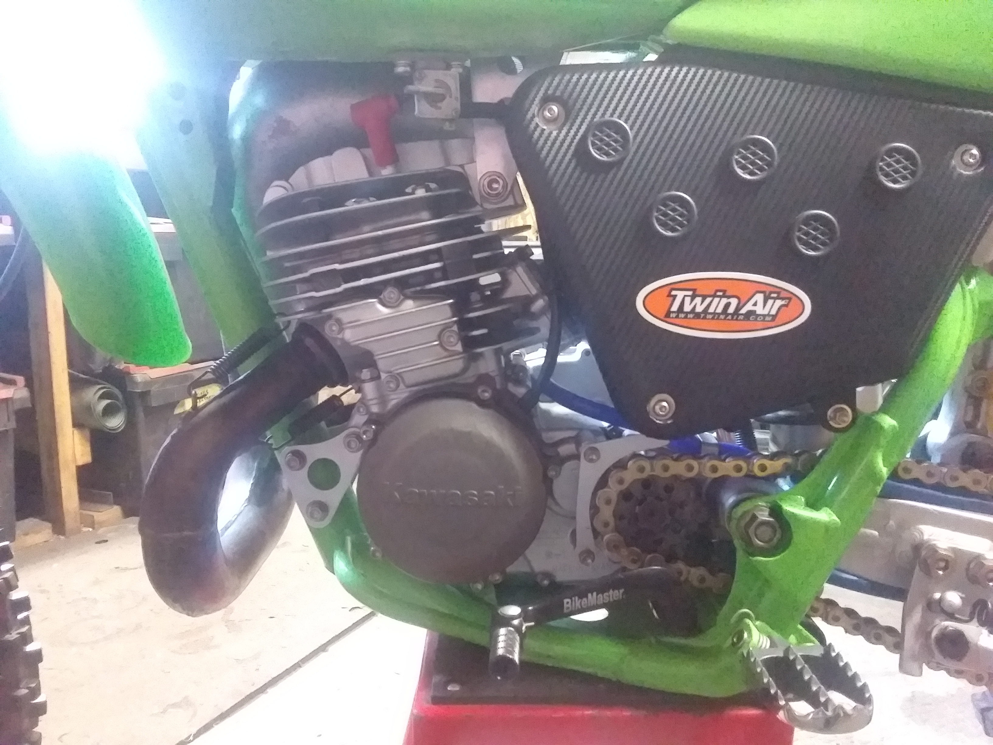

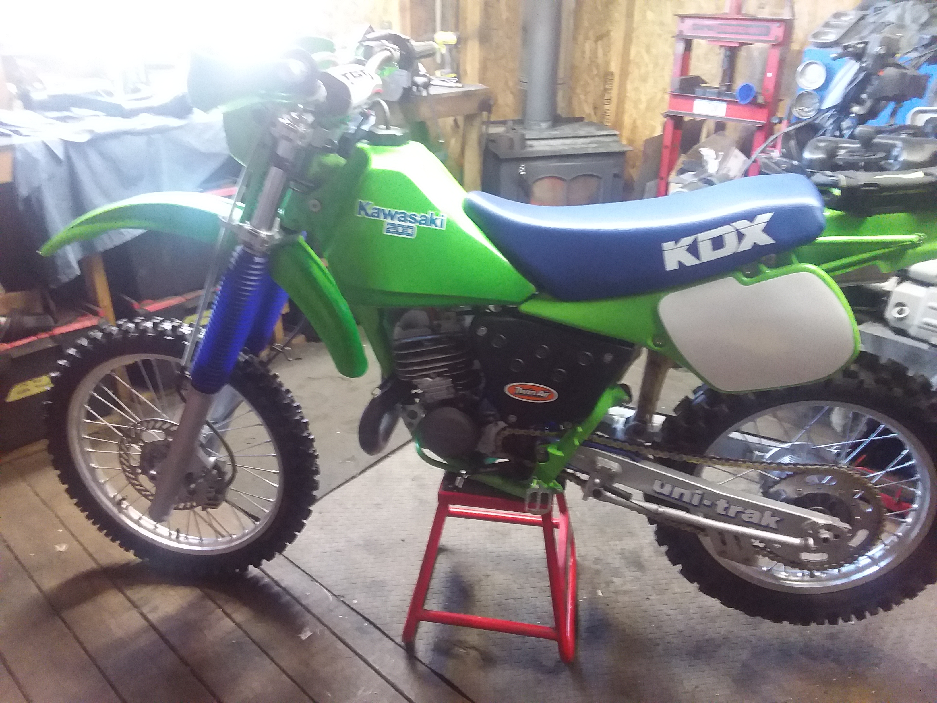

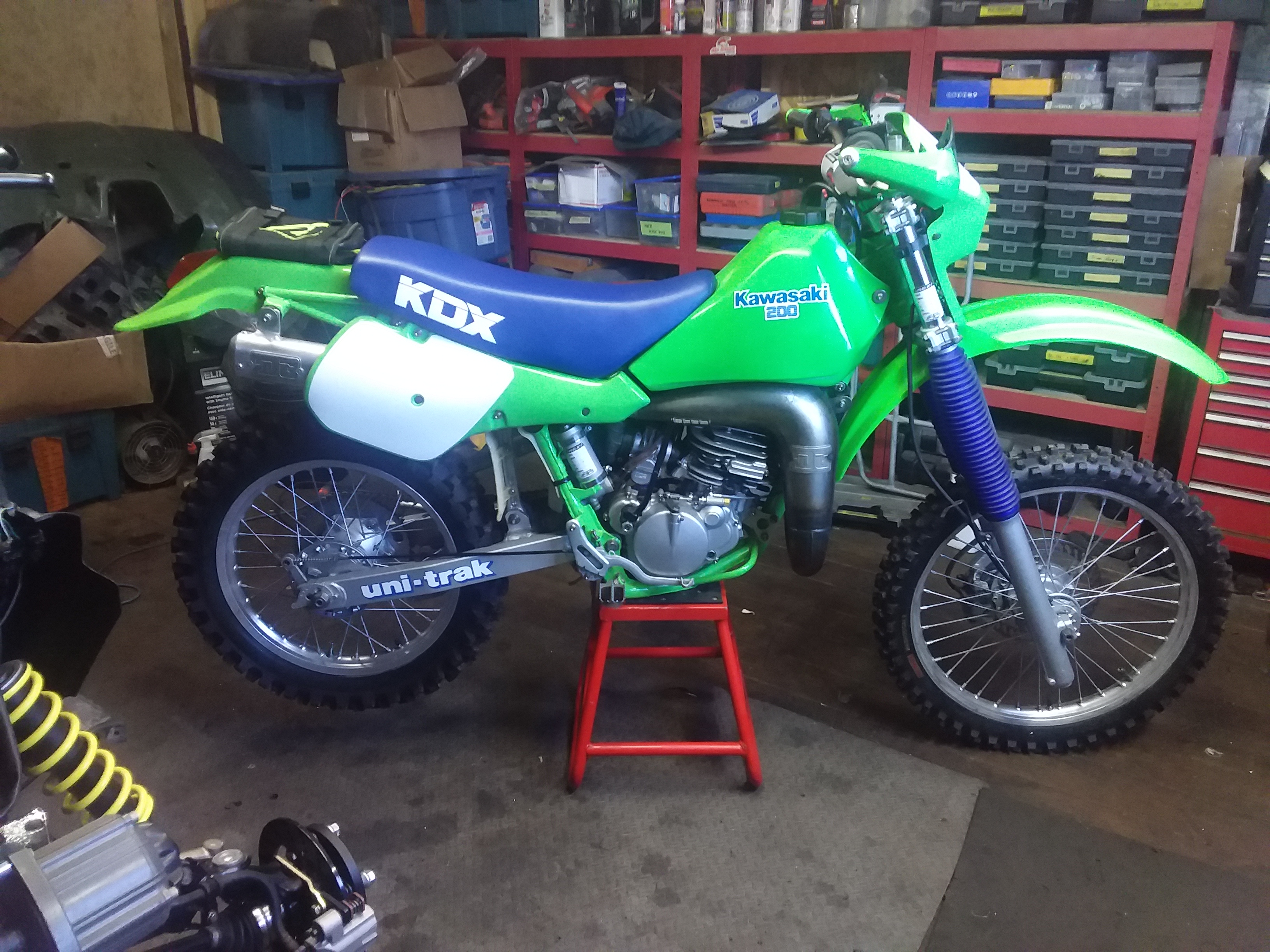

Hi all , She's finally finished !!! Took some doing but worth every effort . Hydraulic clutch is pricey but works great and nice one finger pull light . Rides nice , light and wickedly fast for a 200 .
The decals are for a 87 model because I could only get a KDX logo seat cover and the 88 model has Kawasaki on it ,but couldn't get one anywhere.
The plastics are DC ones and the DC headlamp cowl is modified with rubber straps to hold it on at the top . Rear brake cable had a damaged protective cover so i sleeved it with some air hydraulic pipe . Just cut pipe down one edge and snap over cable ( looks like new factory cable now )
Suspension linkage bushes are allballs ones are are listed for KX 250 / KX 500 and they all fit perfectly .
If anyone has any questions , please feel free to ask .
