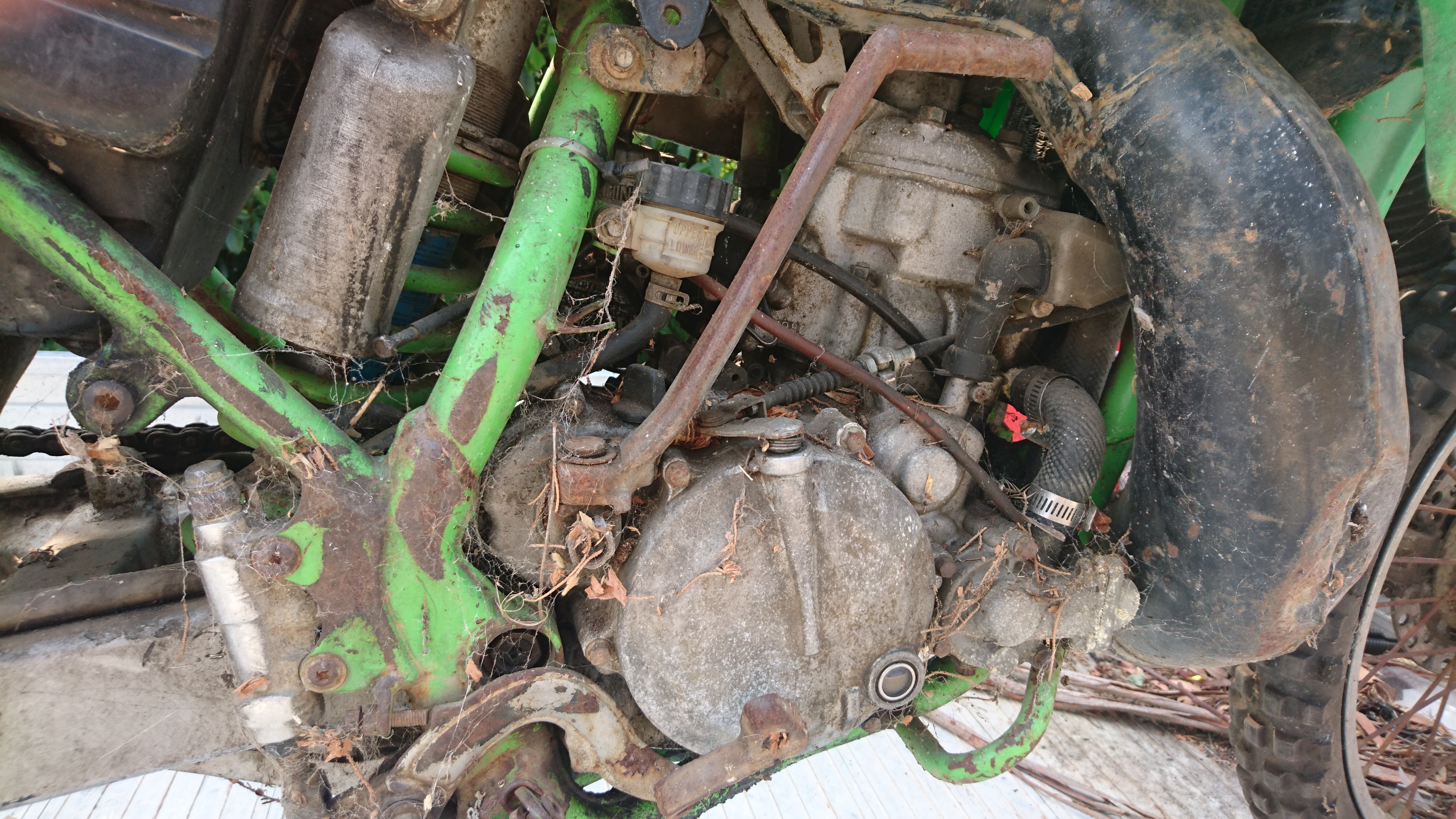

Picked up an old barn find. Was in pretty poor condition. Radiator and engine oil had become one with each other, much the same story with the swing arm and frame.
Figured I would use it to learn about bikes so ended up pulling it apart and poking around. Bit off more than I could chew for a noobie, but pottered forward slowly and thanks to resources like this forum, the bike actually works now.

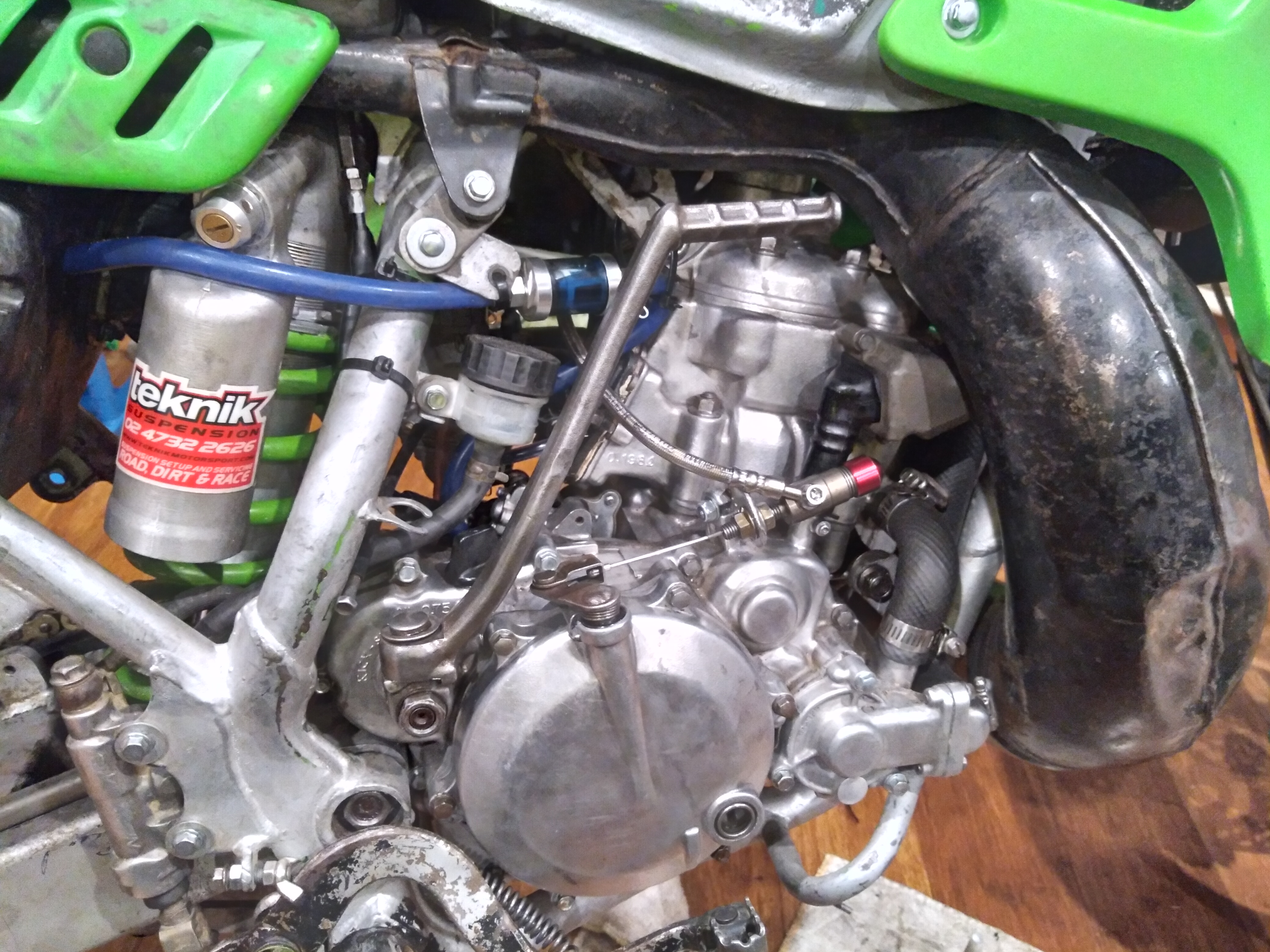

Welcome to kdxrider.net. She looks a lot different in the 2nd pic than the first!
Goatfish
Posts: 36
Joined: 09:59 am Jun 30 2020
Country: Australia
Re: 1989 kdx200sr noobie rebuild
Post by Goatfish »
Hahaha. I have probably as much time putting a shine to it than riding it so far. I must be married now. Is this what it feels like

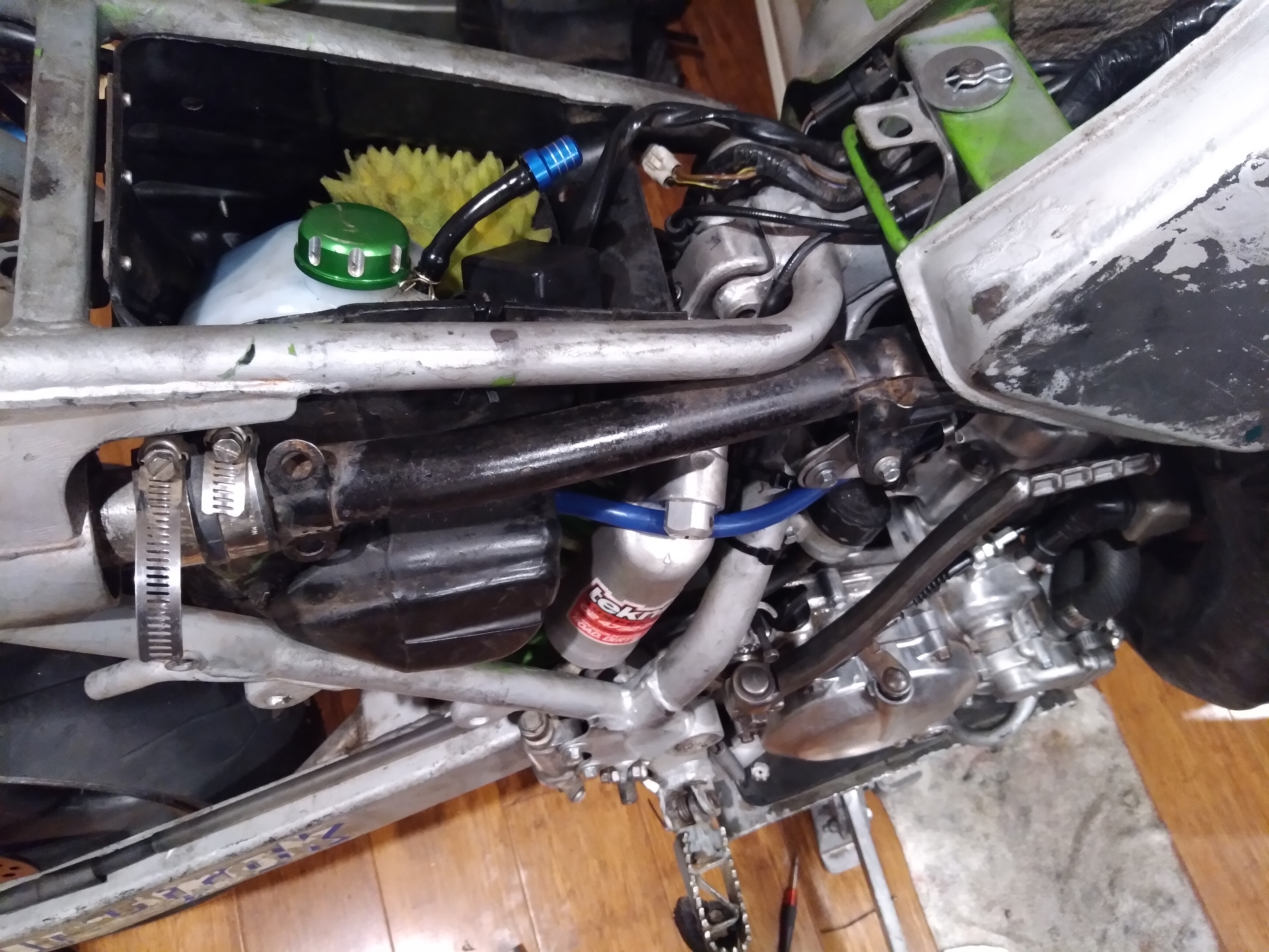

That hydraulic clutch is cool.
What is the blue thing? crankcase vent filter?
Goatfish
Posts: 36
Country: Australia
Post by Goatfish »
kick wrote: 11:48 am Nov 08 2020 That hydraulic clutch is cool.
Yeah I was not expecting much when I ordered it but it seems that china pitbike products are not that bad. Lets see how long it lasts.
KDXGarage wrote: 04:31 pm Nov 08 2020 What is the blue thing? crankcase vent filter?
Its another ebay fuel filter that is being used as an oil filter/viewing port. It screws open to make bleeding line easier. Hooked up to a universal radiator overflow that is hiding in the airbox and filled with 2t oil. The original oil tank was missing. I clean airbox after rides so figured just top up oil then.
I dont do proper enduros with it. I would not trust this set up for proper enduros as the line could get bashed against a rock but for light pottering around like I do, it hasn't had any problems. Yet.
