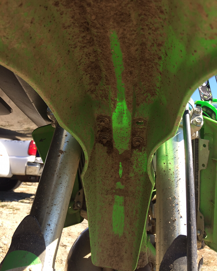

Momma warned me there’d be days like these. Actually, it was KDXG. I kept trying to serve 2 masters with the fork height. 27mm has been great in the woods, but got me poor results at the track. This is not the worst of it. I had one endo where the front locked up, not just rubs...black scrapes. Almost went over the bars.

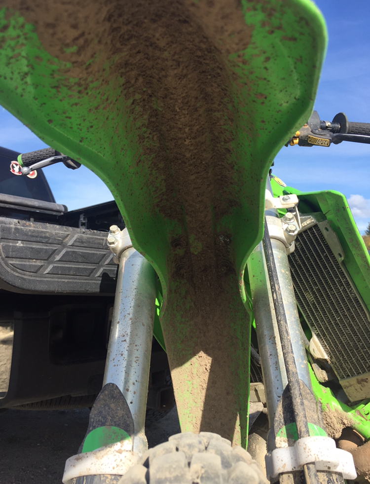

Re: KX Fork Height
I went back to the stock KX setting of 5mm, and feel a lot safer. Low CR bars and no spacers... so still feels fine. Will have to see how it goes in the woods, next time.
Track setting so far:
8-C / 11-R.
And I finally ordered the 5.2 shock spring.

Re: KX Fork Height
Did you shorten your forks internally?

Re: KX Fork Height
Very funny! I could use some Kawasaki suspenders.
No I did not do anything to the forks. They are just rebuilt to KX 125 stock specs. I was bottoming them all the way down regularly (using the 27mm spacing) and some softer settings.
I do need to throw the zip ties back on just to see how much of the travel I am using now. Somehow I left them at home last Sunday.

Re: KX Fork Height
I hit the gnar with the KX forks (still at 5mm MX height setting). Seemed great. 12C / 15R. I think it just took a couple rides so it seems normal.

Re: KX Fork Height
Im afraid I will make $5k with no hybrid help, thank you very much! But i do have a buddy at work who is a big hybrid fan, and reminds me about it often.
I have 2000 KX125 forks, how about you ?
Since I didn’t do actual measurement before swapping, I keep planning to do the theoretical difference in front end height with some of that super fancy 6th grade geometry.
It is a bit more nimble. Maybe just a little lower. With the forks dropped. But without shortening them internally I did not think it was worth dropping much and having to worry about the fender hitting. I survived the one lockup I caused and don’t need that joy again.
