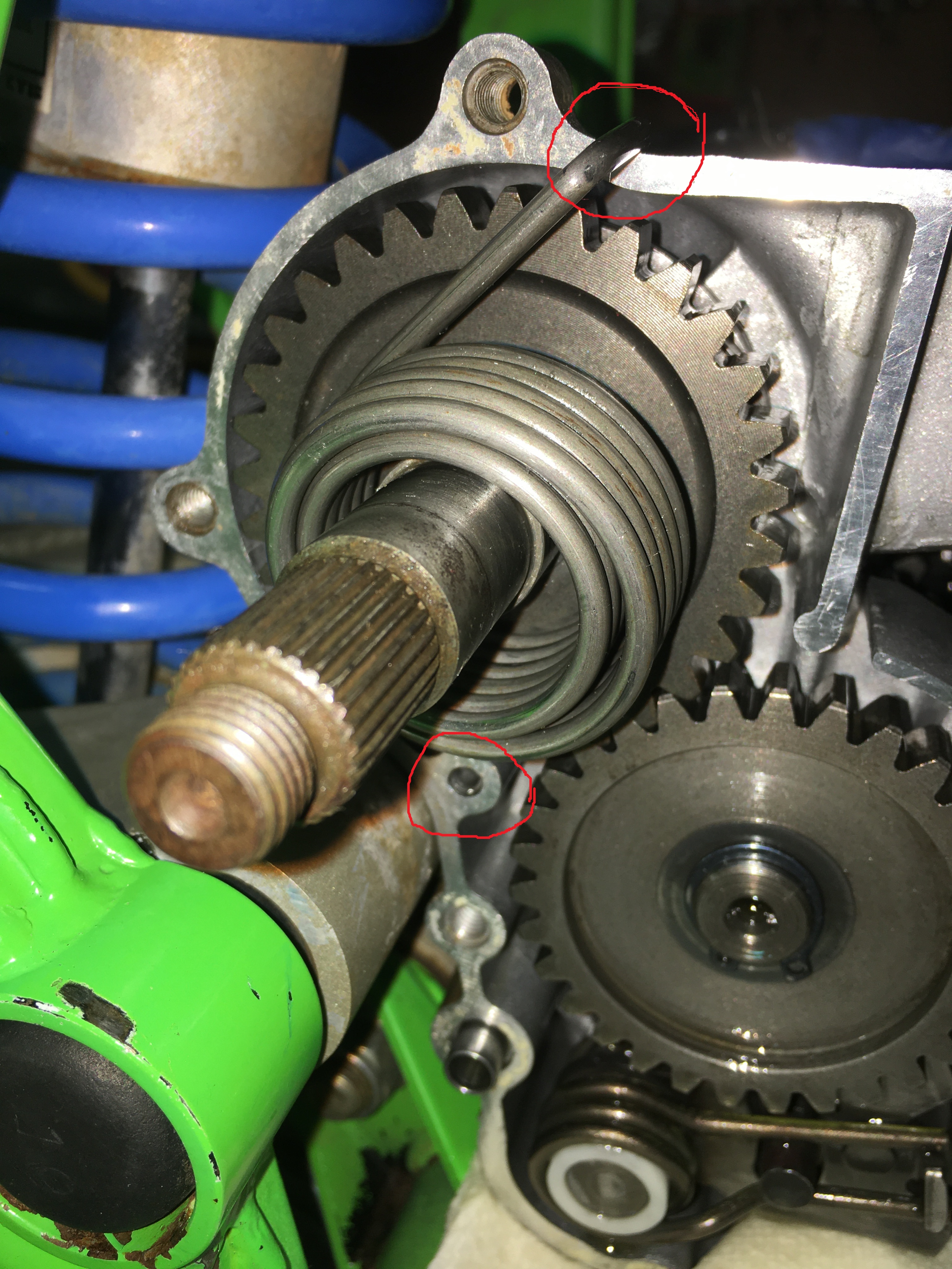

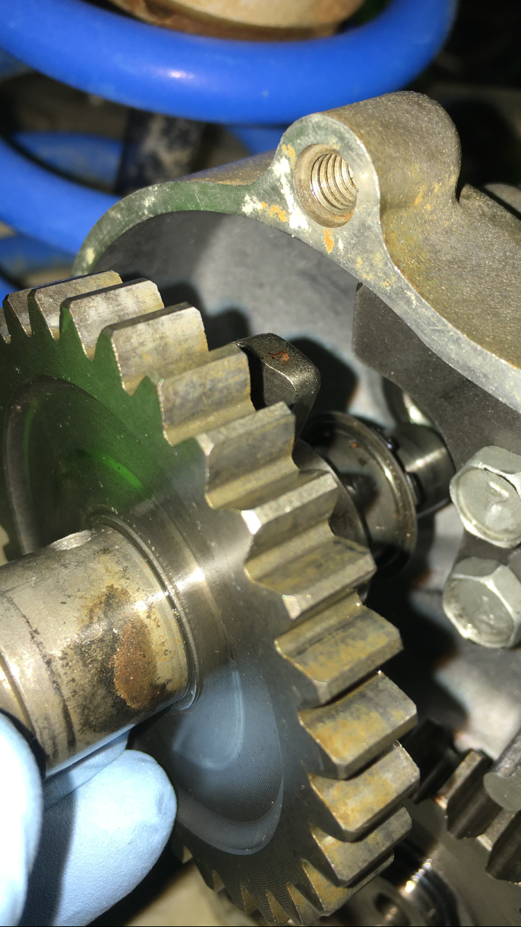

Trying to reinstall my kickstarter assembly into the side case. My manual does not address the correct positioning of the ratchet tab on the back of the assembly in relation to the ratchet 'guide' on the inside of the case. Logically, it would seem that the ratchet tab would be placed just to the left of the ratchet guide (see pic below) when inserting the kicker assembly and meshing with the kicker gear. If this is correct, it puts the spring end which goes into the side case at the top of the case (at rest) and I will have to carefully move it clockwise to place it in the hole in the edge of the sidecase just to the left and below the kickstarter shaft (see pic). BTW, I didn't put the plastic piece/washer inside the spring; just trying to demonstrate the positioning to you. I wanted to be sure this is all correct before I move that spring around (unless I shouldn't).
Please let me know if I'm off base here. Thanks! Chuck

My manual clearly shows you have the right hole circled in red.

I absolutely agree; that's the hole it was in when I removed it. My question is really in relation to my positioning of the ratchet tab and is it correct that I should 'tension' the spring half a turn clockwise from its resting position to place it in the hole. Seems like a lot of tension to place on it at rest given that it will tense even more as you kick through a cycle. I realize that it needs some tension to bring the kicker back up after each cycle, but really wanted some assurance that this is correct. I've already had to buy this replacement kicker assembly as the previous owner buggered the kicker spring up on the previous assembly. Just trying not to mess it up 'again'! Thanks

Yes it gets tensioned half a turn, that is the holding force that keeps the kicker from flopping around at the top of its stroke.

Yes, it’s more tension than seems necessary. It what it is. Grab a pair of needle nose and carefully wind it into its home. It might not sit perfectly flush in that hold either.
