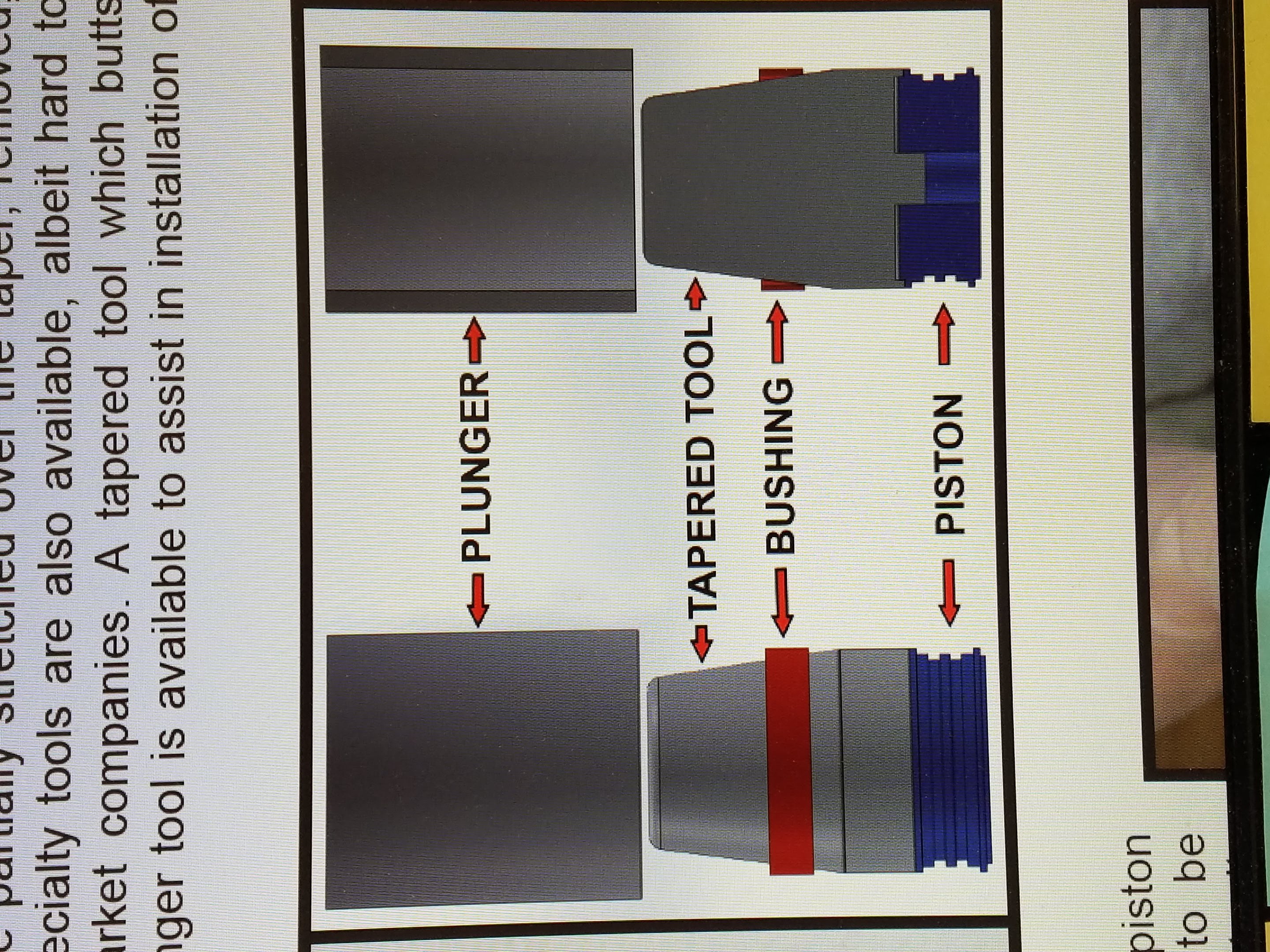

I have a question about special tools for the KDX that I know you are uniquely suited to answer, being a "special Kawasaki tools enthusiast". So, I've decided to take apart, clean and inspect my rear shock instead of having a shop do it. Looks fun. There are a couple special tools that I can still get, from rocky mountain ATV, but there's one thing I don't see for sale anywhere on the internet. The piston bushing installation tool. (Not the shock seal bullet tool, and not the shock seal head setting tool) The piston bushing installation tool lets you slightly stretch and then slide down into place the piston bushing around the piston. I don't even know if my current piston seal/bushing/ring (it has different names) is worn, but if it is I want to be ready to replace it.

Now I know that some people have had luck stretching it down over the lip of the piston with their bare hands, but from what I've read a lot of people can't do this and end up messing up and destroying/distorting the bushing unless they've done it a bunch of times before already.
I have a diagram of the tool that I'm looking for! Isn't that nice?
Rear shock piston bushing installation tool.jpg (1.52 MiB) Viewed 2789 times

I have never seen 44 mm tools. I just notch cut them back in the day, like a Race Tech Gold Valve position band.
The last band I did was for one of my 46 mm pistons. I just stretched it on by hand after having it in boiling water and the piston in the freezer. After installation, I put the non-sticky side of symmetrical EDIT!! (electrical tape) tape around the piston and wrapped it about ten times. That shrunk it down a touch. I think the shock body will compress it down to size.
I have a 46 mm tool from Zip Ty Racing. Someday, I hope to find someone with a lathe to cut it down to 44 mm without charging $200 set up fee, minimum labor charge, etc.
Technical Touch USA had KYB 44 mm bands and pistons. Tucker and Western Power Sports used to carry them, so most any local dealer could get them.
Bladders, shaft nuts, bumpers and seal heads, too

@KDXgarage, I have a lathe. Unless it's hardened or configured in such a way to make setup difficult, I can do this for you. Got lots of time right now. PM me for details.
