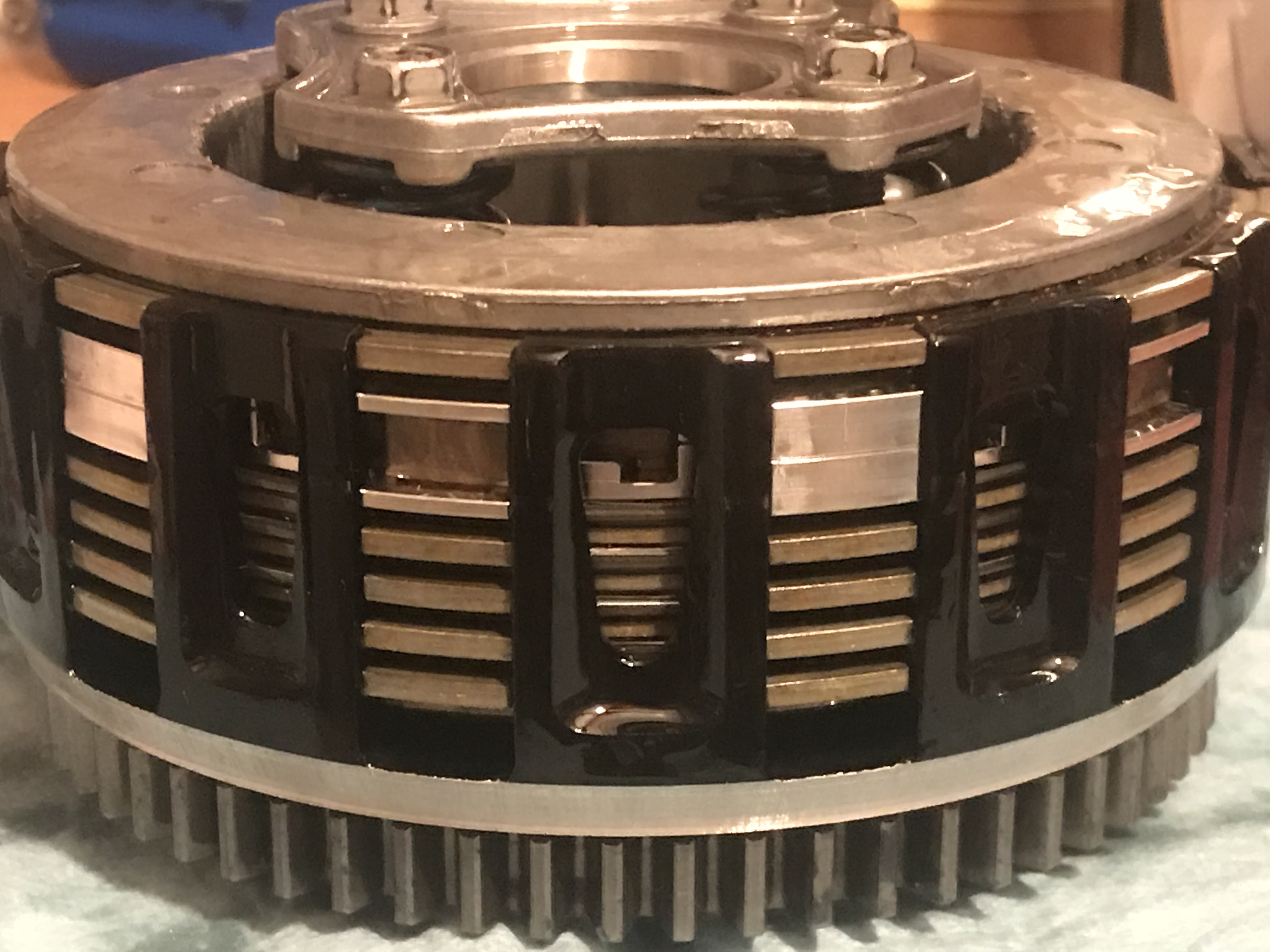

I installed one of his clutches a while back and used all stock parts (with the modified YZ125 outer basket) but I did have to have a little extra machined off the back side of the inner clutch hub. Without the extra machining, the installed clutch was too tall and causing problems.
You can see my solution at the end of the linked posting...
viewtopic.php?f=77&t=16033&start=40
This final pic is my completed clutch set up after the extra machining work and utilizing stock parts such as washers, springs, etc.
