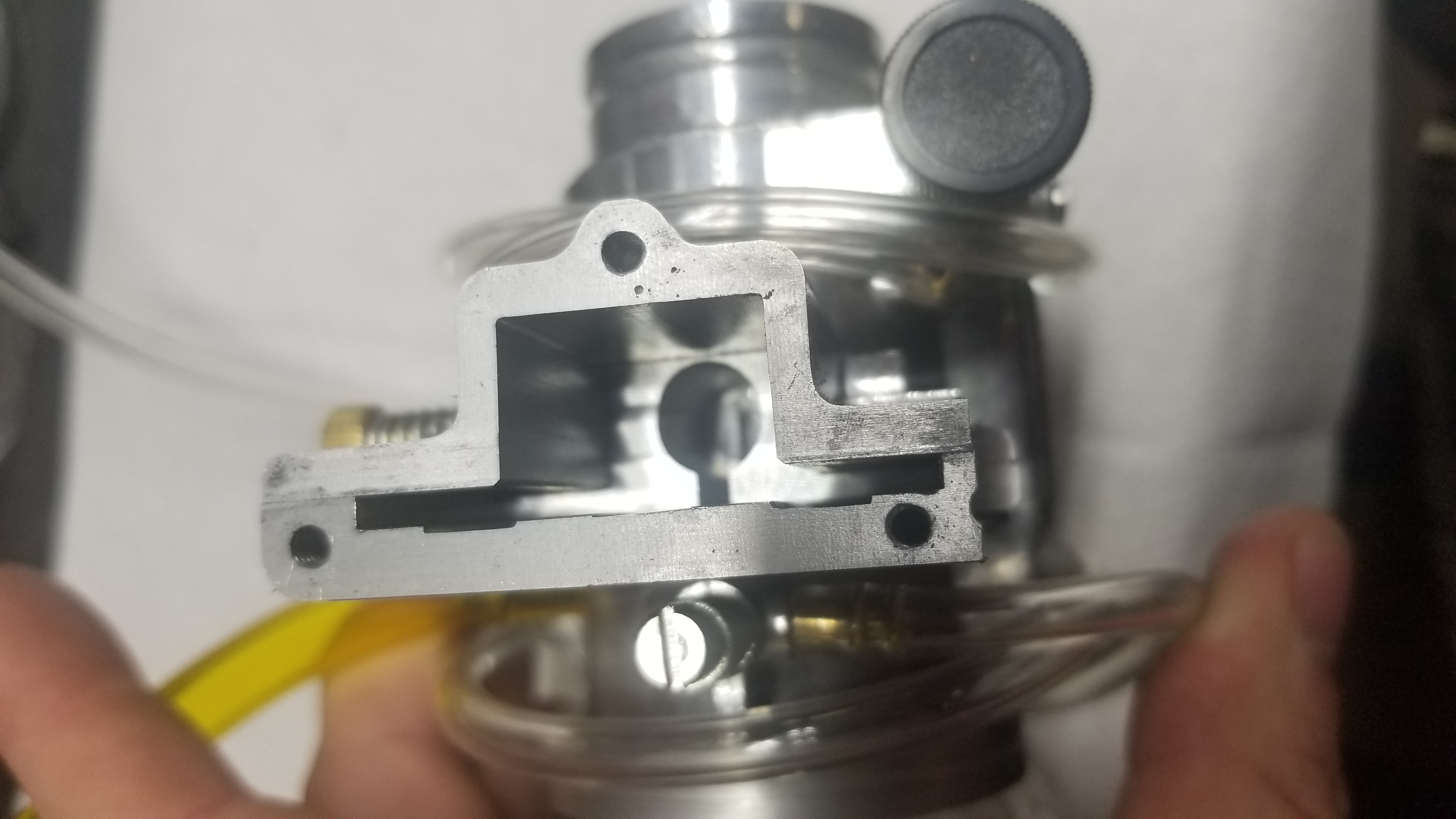

The physical appearance of the Lectron is nice, its almost a polished surface. They also include the aluminum bowl mounting bracket which is nice to see as I know that was an extra option in the past not standard. The right-hand side of the carb has been milled by about 5.5mm. I assume this was a correction to fix fitment issues others have had. There was also a small portion of casting on the cap that was milled down as well. A cap bolt as well as a carb body bolt are relocated to accommodate this. While this work serves its purpose, it is rough machine work and leaves ½ threads from the original carb design exposed. That is purely an aesthetic observation doesn’t seem like it would affect operation in any way. The gasket appears to be installed when the machining is done making it a matched set and any future gasket would need trimmed and drilled for the application. There was some roughness on the flat side of the slide bore but it didn’t seem to be causing any “sticktion” to the slides movement.
relief cut top view
relief cut top view

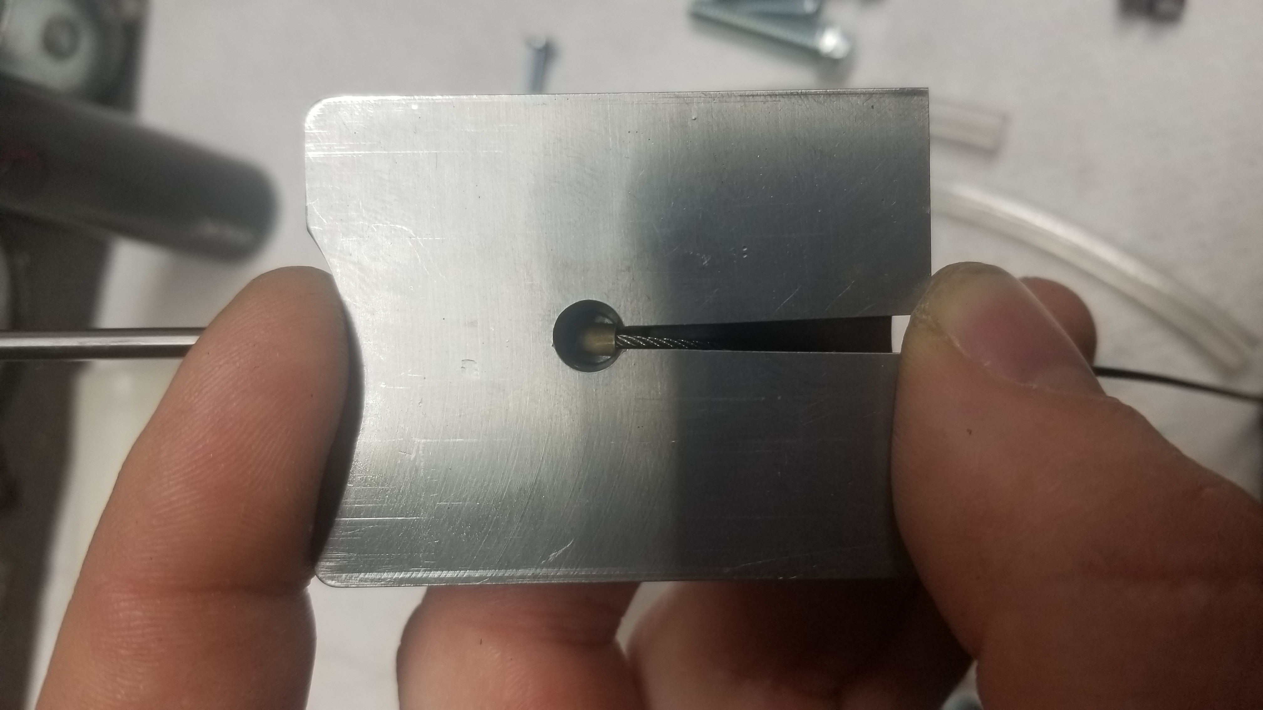

The throttle slide is nice overall, I was a little discouraged by the cable engagement as it seems like it isn’t distributed over much surface area and could cause wear of the cable end or slide. The top side of the slide has a sharp square edge from machining that seems like it would benefit from some slight chamfer work to reduce the slide bore wear. Needle adjuster mechanism is nice seems to work smoothly. The right-hand choke location sucks plain and simple but what are ya gonna do right. It’s perfectly functional once you get to it.
