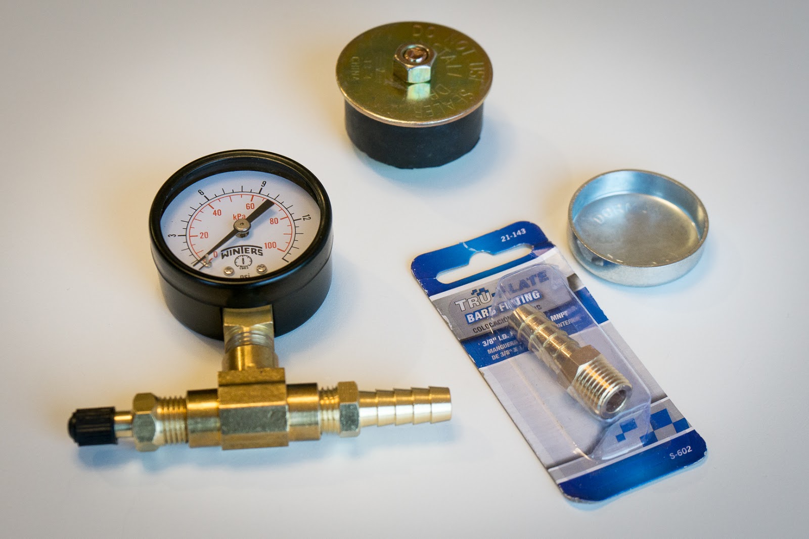

Kngnthn76 wrote:
Jason wrote:You MIGHT want to do a pressure test and vacuum test before splitting the cases.
Never done that before. What is needed to perform the tests?
I'm putting one together with parts from Amazon (parts list below)...
(For plugging the exhaust - you can get these individually at a auto parts store)
(For plugging the intake - sold individually at an auto parts store. I'll drill and tap it for the hose barb))
