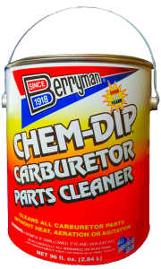

DO NOT Soak Keihin PWK Carbs in Carb Dip!
Carb dip damages an internal gasket in the jet block area. Don't "carb dip" the Keihin PWK's used on some KDX's. (1988 and newer, full-sized)

you can dip the carb in dish soap, Pine sol, dip, or whatever, but all the jets and rubber/plastic needs to come off first, Ave only long enough to break loose the gunk. not over night!
normally the stuff that loosens varnish will also etch the slide, so be very careful how long you soak ;-)
