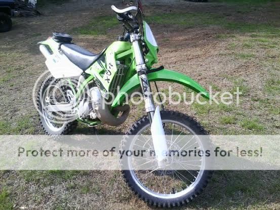

just did this with 2000 kx500 forks trees and axle with a 2001 kx 250 wheel and 08 rm 250 fork guards

mine came revalved for woods riding for a 180lbs rider from ZR1 Suspension all done by the previous owner
