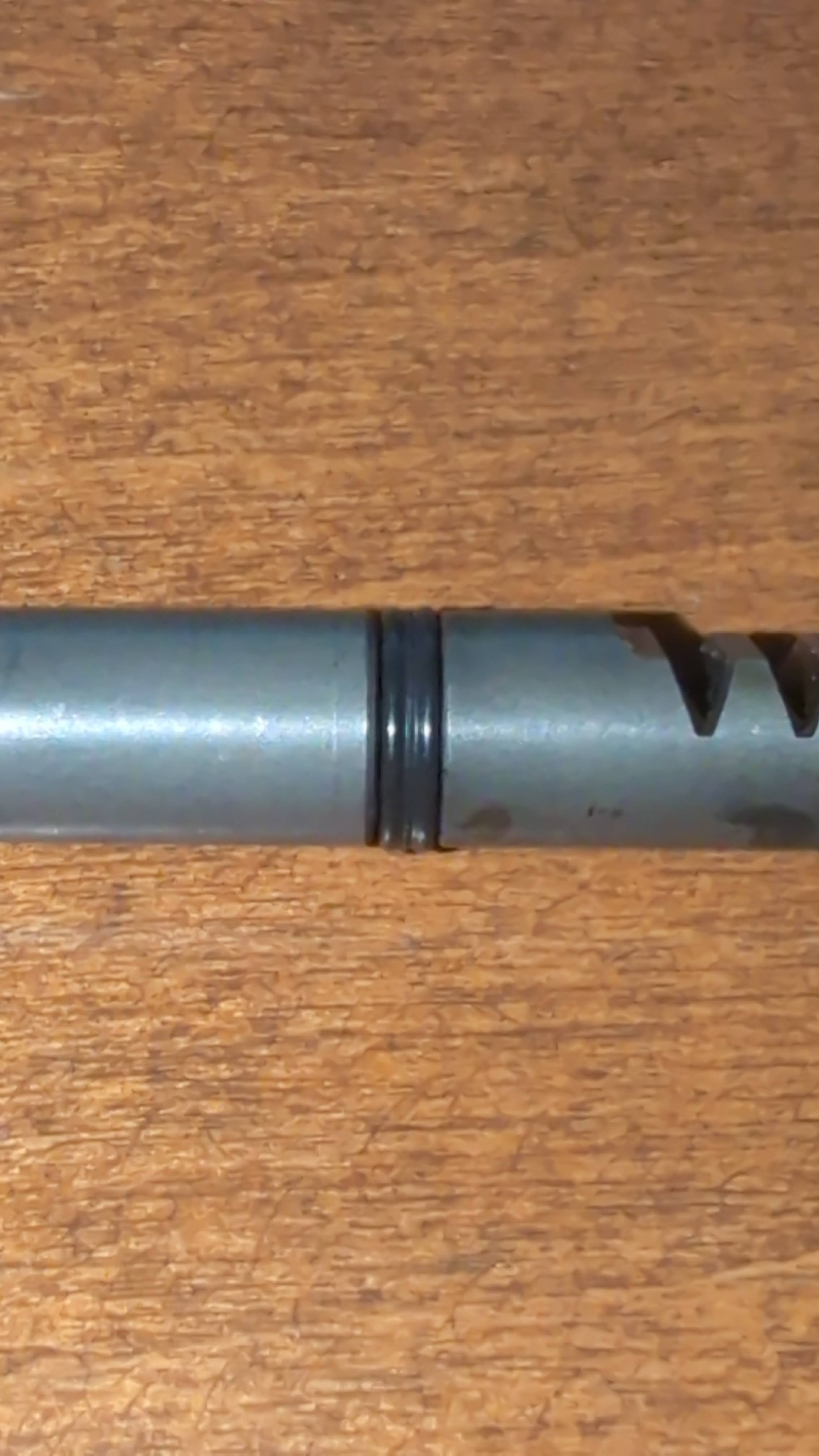

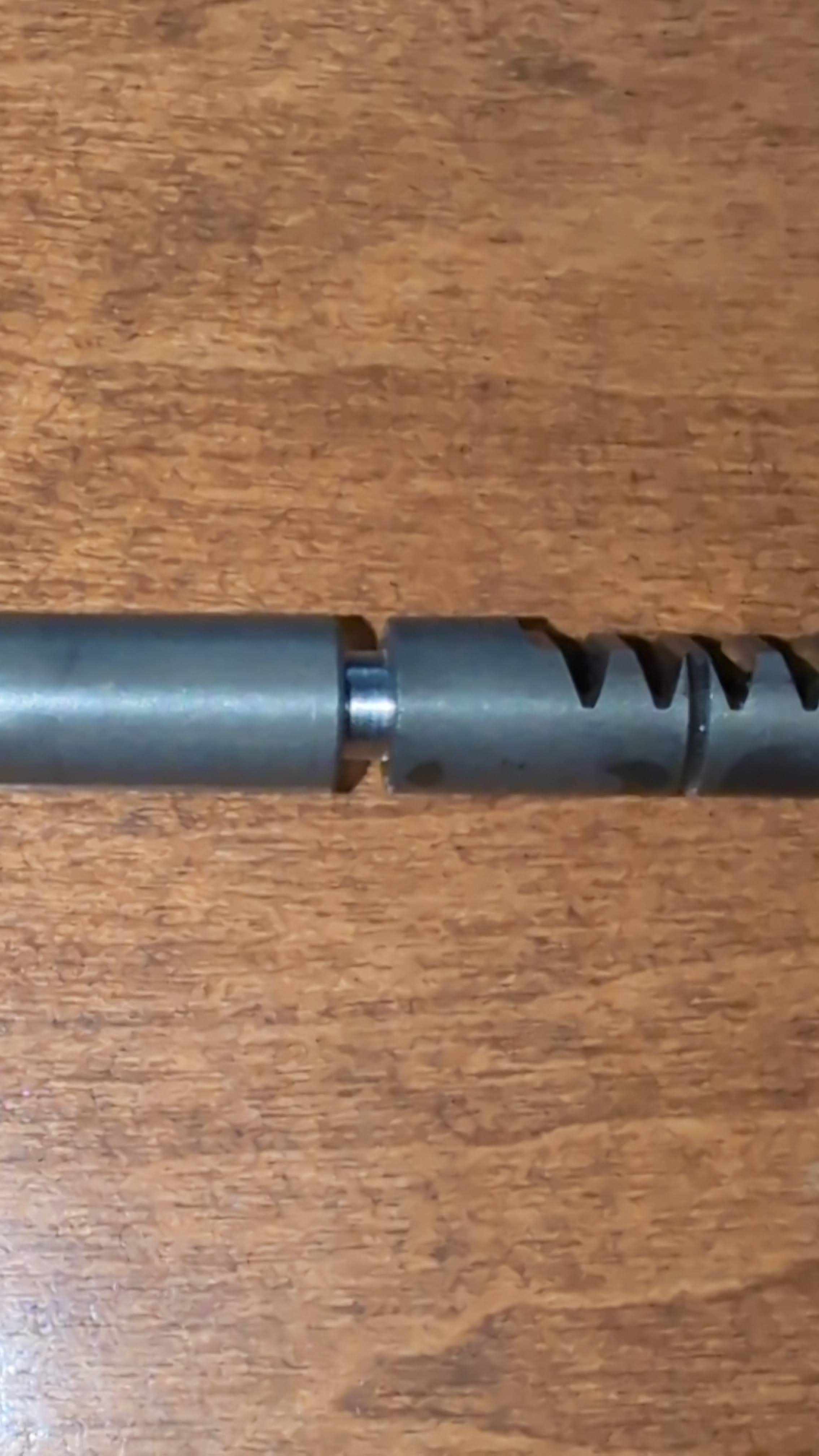

Re: Kips sub shaft o-ring
New cut groove with and without 008 Xring
- unnamed (1).jpg (289.51 KiB) Viewed 25783 times
- unnamed.jpg (276.71 KiB) Viewed 25783 times

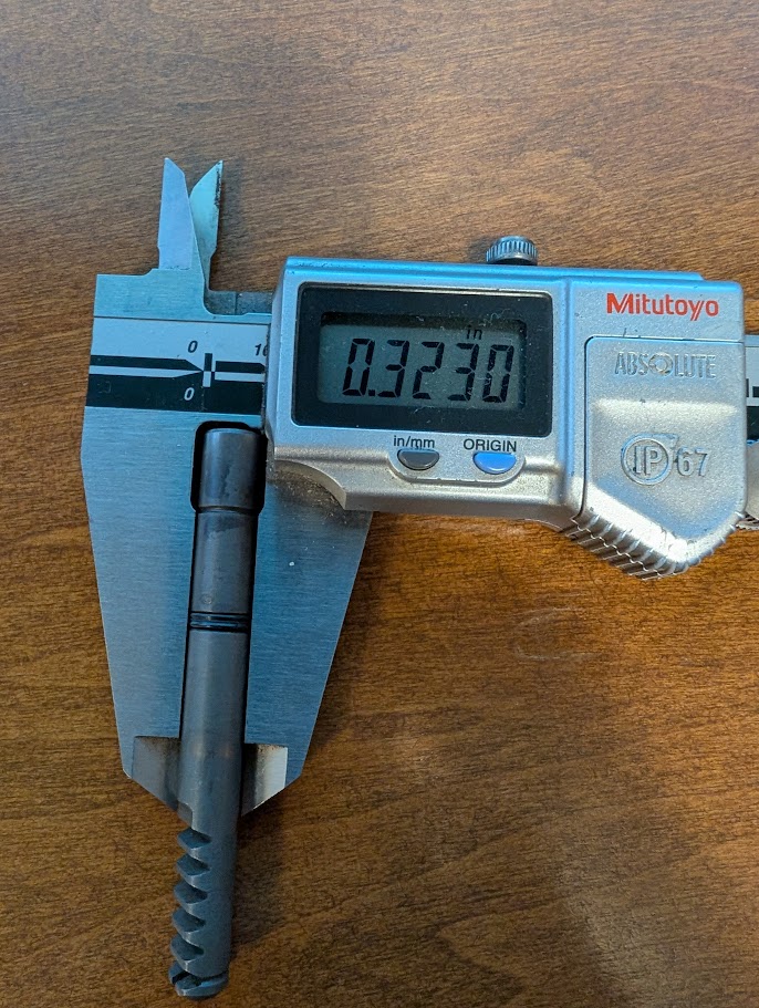

Measurements........
It's real pain to get an accurate measurement of the new OD with the x-ring on. This was more so by feeling the friction of it touching. A bit of a squeeze and it might read .318 or so.......... but am happy with this, and based on my previous measurements I see no reason why this won't work perfectly......
Apologies it took so long, when you got a guy dong it for free, in the evenings, and I'm not pushing him as it's snowing outside right now so I ain't riding, it took a bit of time.......
- PXL_20260406_004436613.jpg (216.82 KiB) Viewed 25783 times
- PXL_20260406_003738167.MP.jpg (98.08 KiB) Viewed 25783 times

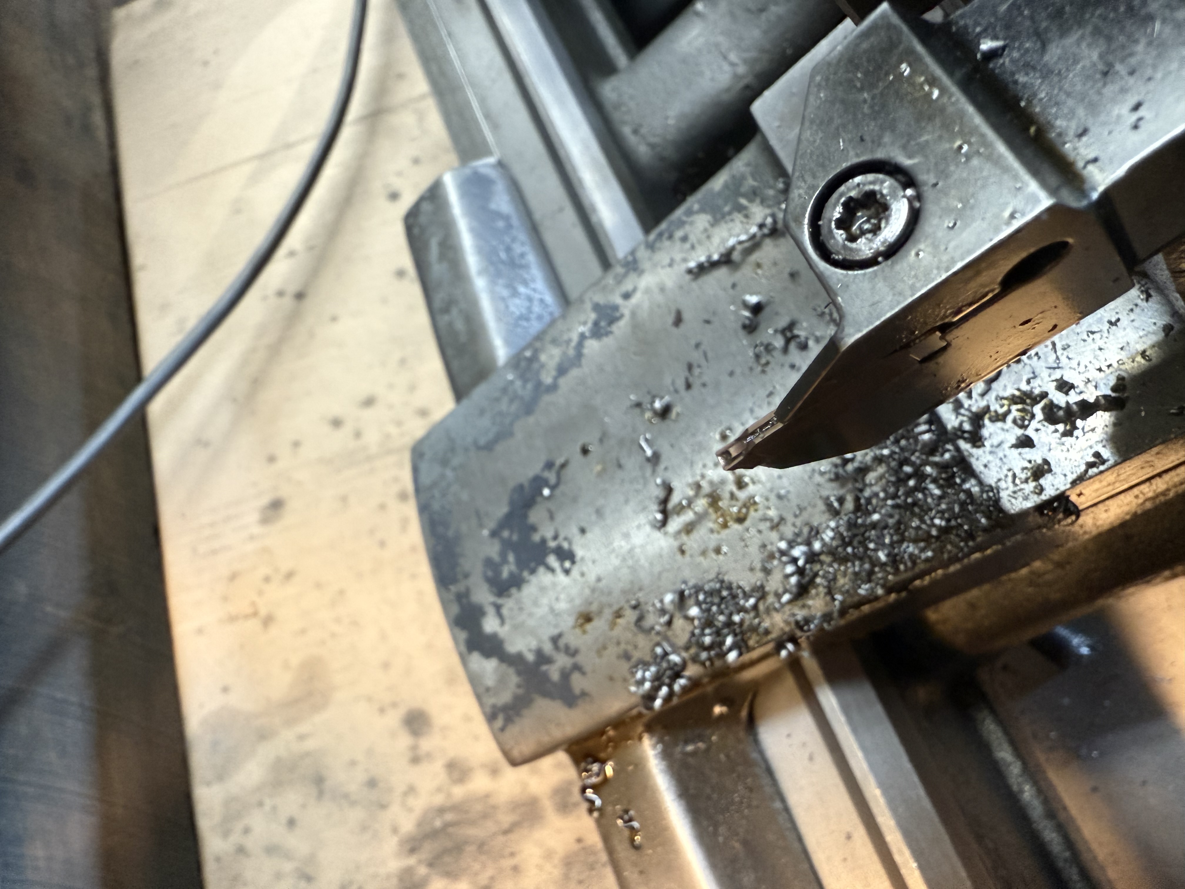

Jamie, if you get a chance to take a photo of the carbide cutter setup that you have your machinist use to cut this, that'd be much appreciated. I am not a machinist, but rather a DIY'er who happens to have acquired an old manual lathe and 2 milling machines for home shop fabrication use, therefore my tool bit selection and knowledge is limited in these realms, but always improving through every little project such as this... Same with you, Kawibunga, if you know what tool bit/holder type setup your guy used for the tiny groove. I'll figure it out on my own, but also having a professional reference always helps in my learning process.jamiethegiraffe wrote: 11:33 pm Apr 05 2026 Hell yeah! Nice work Kawi! Thanks for sharing with us. The info about being able to cut the shaft with a good carbide insert is much appreciated.

You could either grind one yourself out of a HSS blank, or use a carbide insert parting/grooving tool that's just slightly smaller than the groove width that you're cutting.Chuck78 wrote: 06:13 am Apr 06 2026Jamie, if you get a chance to take a photo of the carbide cutter setup that you have your machinist use to cut this, that'd be much appreciated. I am not a machinist, but rather a DIY'er who happens to have acquired an old manual lathe and 2 milling machines for home shop fabrication use, therefore my tool bit selection and knowledge is limited in these realms, but always improving through every little project such as this... Same with you, Kawibunga, if you know what tool bit/holder type setup your guy used for the tiny groove. I'll figure it out on my own, but also having a professional reference always helps in my learning process.jamiethegiraffe wrote: 11:33 pm Apr 05 2026 Hell yeah! Nice work Kawi! Thanks for sharing with us. The info about being able to cut the shaft with a good carbide insert is much appreciated.

I was looking for the type of carbide insert that would be best for this but you have answered that, a parting tool would clearly be small enough for this task. Being hardened steel, HSS may not be the best choice.

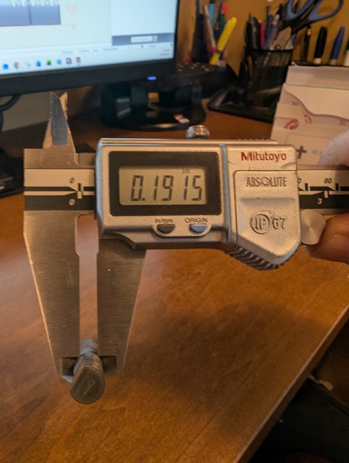

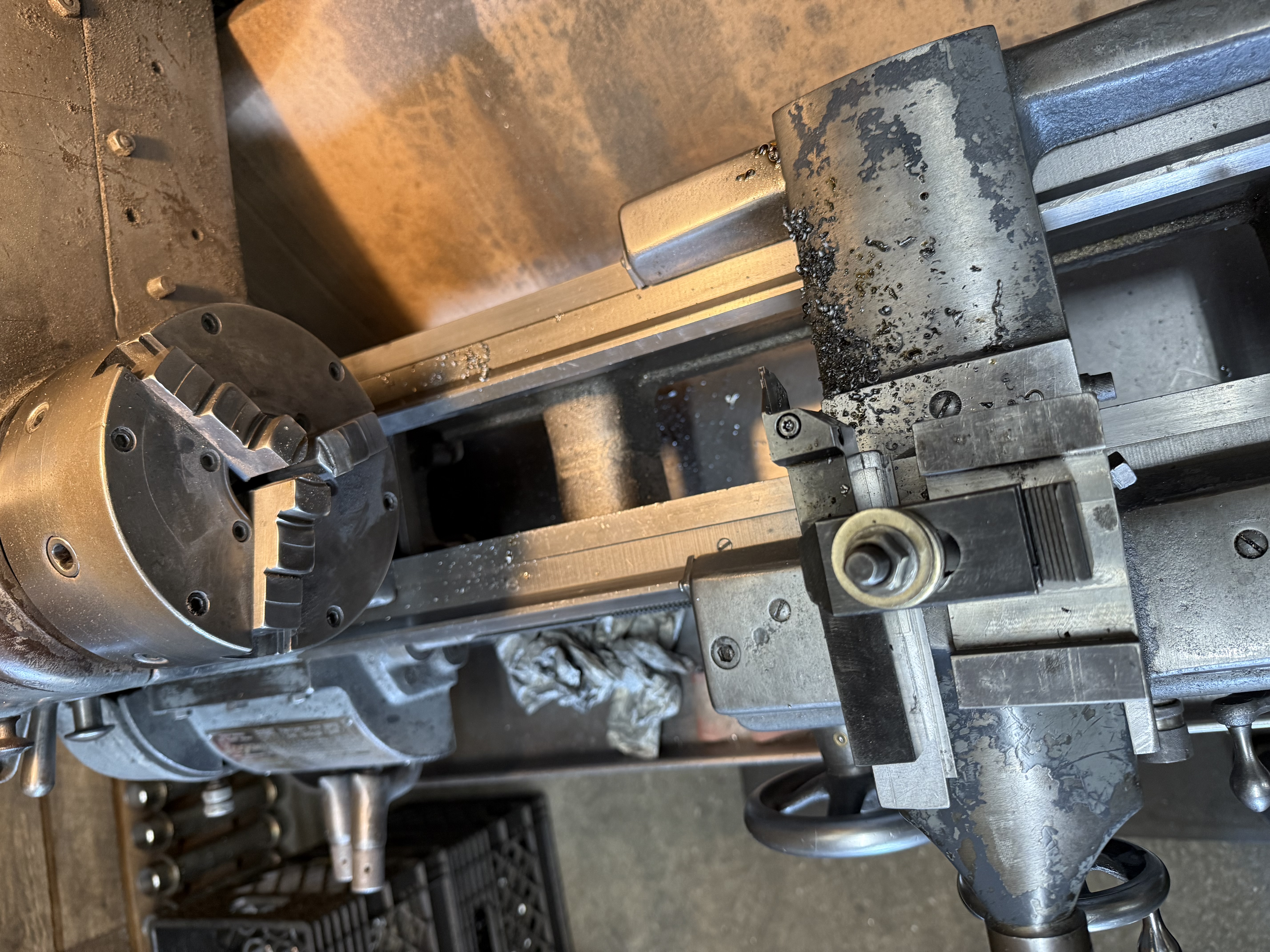

My machinist got around to cutting my shaft this weekend. Looks to be .1915” final dimension (same as Kawibunga’s).
He used a .079” carbide grooving tool to make the cut. Said it just snuck into the existing groove in the shaft. This is similar to a parting tool, but it isn’t angled like a parting tool normally would be.
Here’s a couple of pics for ya Chuck!
