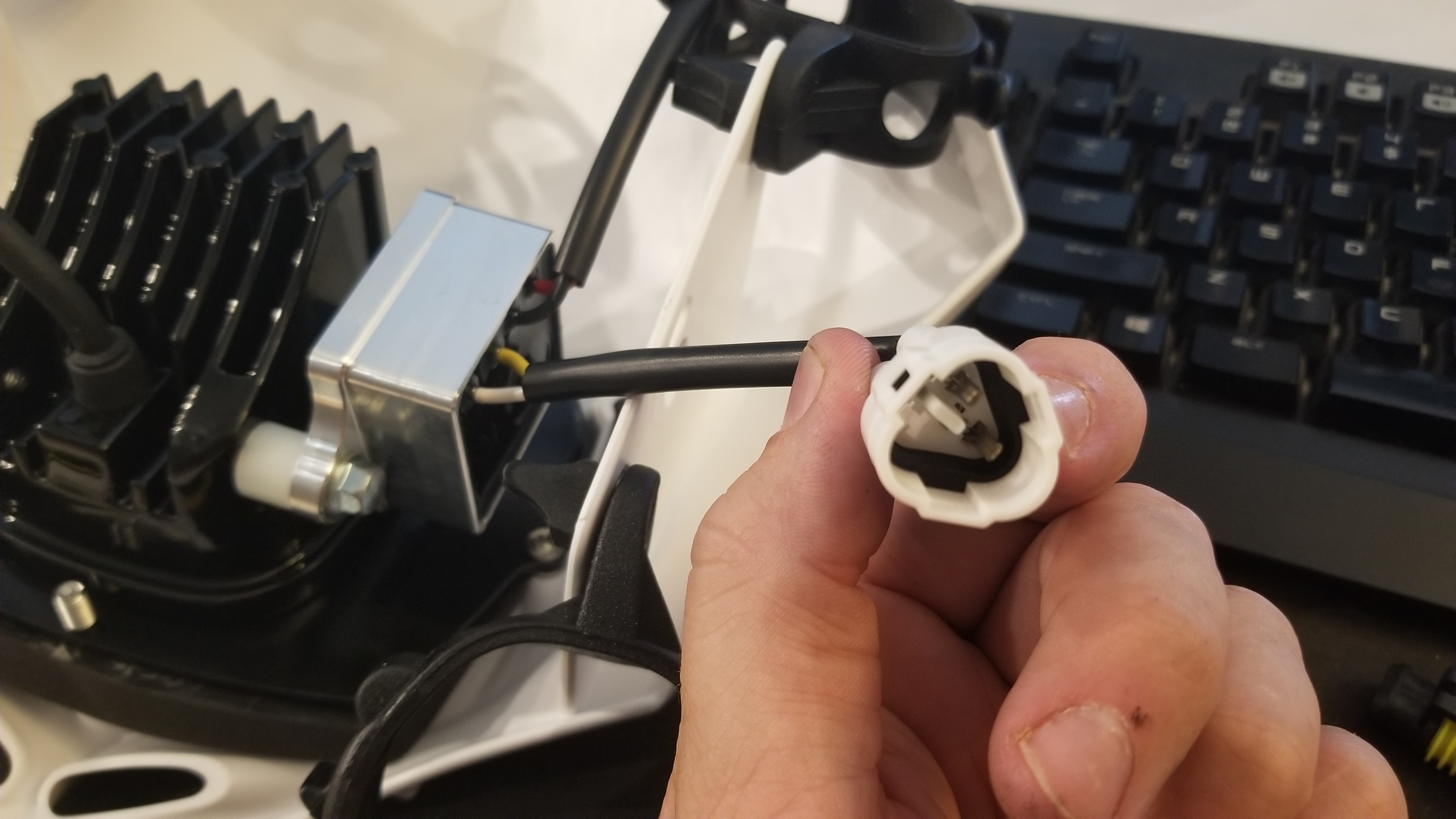

So I went ahead and got the lower output light as I didnt want to worry about wattage. Go to wire it up and I realize that I have no idea what I doing. Took seat off to be able to trace wires and follow them, easy enough, AC wiring makes sense.
My only question is, do i just wire this light up as normal? Yellow to red(chassis) and white to black(chassis)? Leaving the regulator in place of course, but will the taillight work with this wired in? Do I need to eliminate it?
I read a thread about someone installing a trail tech reg/rec and how they wired it but does that apply in this situation?
I guess it also raises the question of how do I wire the stator too? Will that change anything in the event that I need to move grounds/eliminate taillight?
In my head, I am assuming that the rectifier on the light will stand alone and just needs hooked up, but god help me if I am wrong and zap my bike :please:
