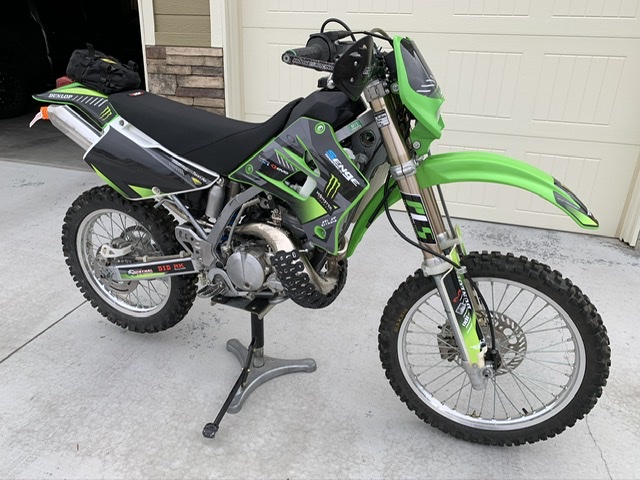

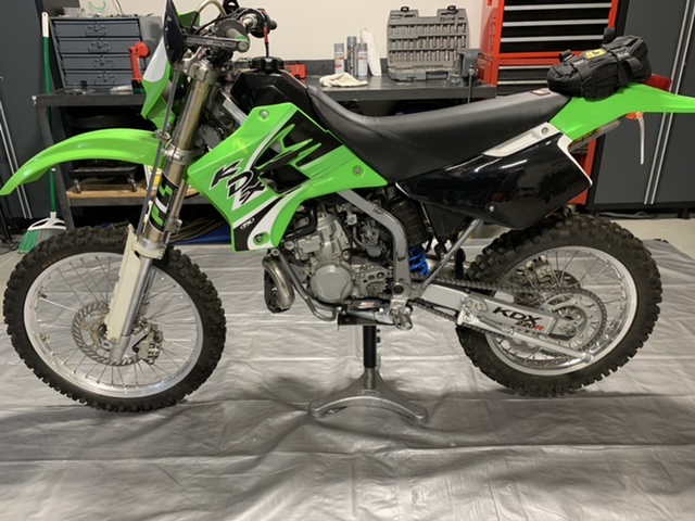

KLX Fork Conversion complete
Posted: 09:59 am Jan 13 2020
by Owyhee1
2003 KDX 220
2003 KLX Forks, brake line, lower triple tree
1994 KX250 upper triple tree - to retain rubber mounts & oversize bars
Small hose clamp on frame stop - works perfect for tank clearance
Everything bolts up perfectly, stock odometer, caliper, front wheel.

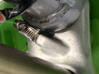

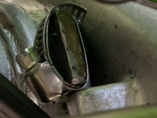

Can you post a pic of your hose clamp/ frame stop?
Everything looks great!
Re: KLX Fork Conversion complete
Posted: 06:15 pm Jan 15 2020
by Owyhee1
This is all I did, haven’t ridden it yet, but should work just fine

The KLX is a direct bolt on. No mods needed, except the frame stop, as noted above. I purchased a klx front fork assembly complete with brake line, which bolts right up, not sure how you would attach stock kdx brake line. Otherwise you can use all your kdx parts, wheel, brake, headlight, odo, etc. I used a kx500 upper clamp to retain rubber mounted bars, as noted above.
Posted: 08:58 am Mar 04 2020
by Owyhee1
Posted: 04:56 pm Mar 08 2020
by Owyhee1
First ride out with KLX fork conversion. I weigh 155lbs in street clothes. We rode some the Rabbit Creek 100 course, which is fairly whooped out in sections. The KLX forks aren’t any stiffer than the stock KDX forks, but seem more planted, and look awesome. After riding some single track, I may need stiffer springs.
Posted: 07:23 pm Mar 08 2020
Congrats on getting out and testing them. Stock springs are 36 or 38, depending on where you read. That's a touch stiffer than 1995+ KDX (0.35).
Did you try the compression adjusters any? What did you have them set on?
Your KDX looks really nice!
Posted: 10:03 pm Mar 08 2020
by Owyhee1
Thanks KDXgarage, the compression is set in the middle, I will try a few more clicks stiffer. I will ride some single track, my usual ride, before I change too much.
