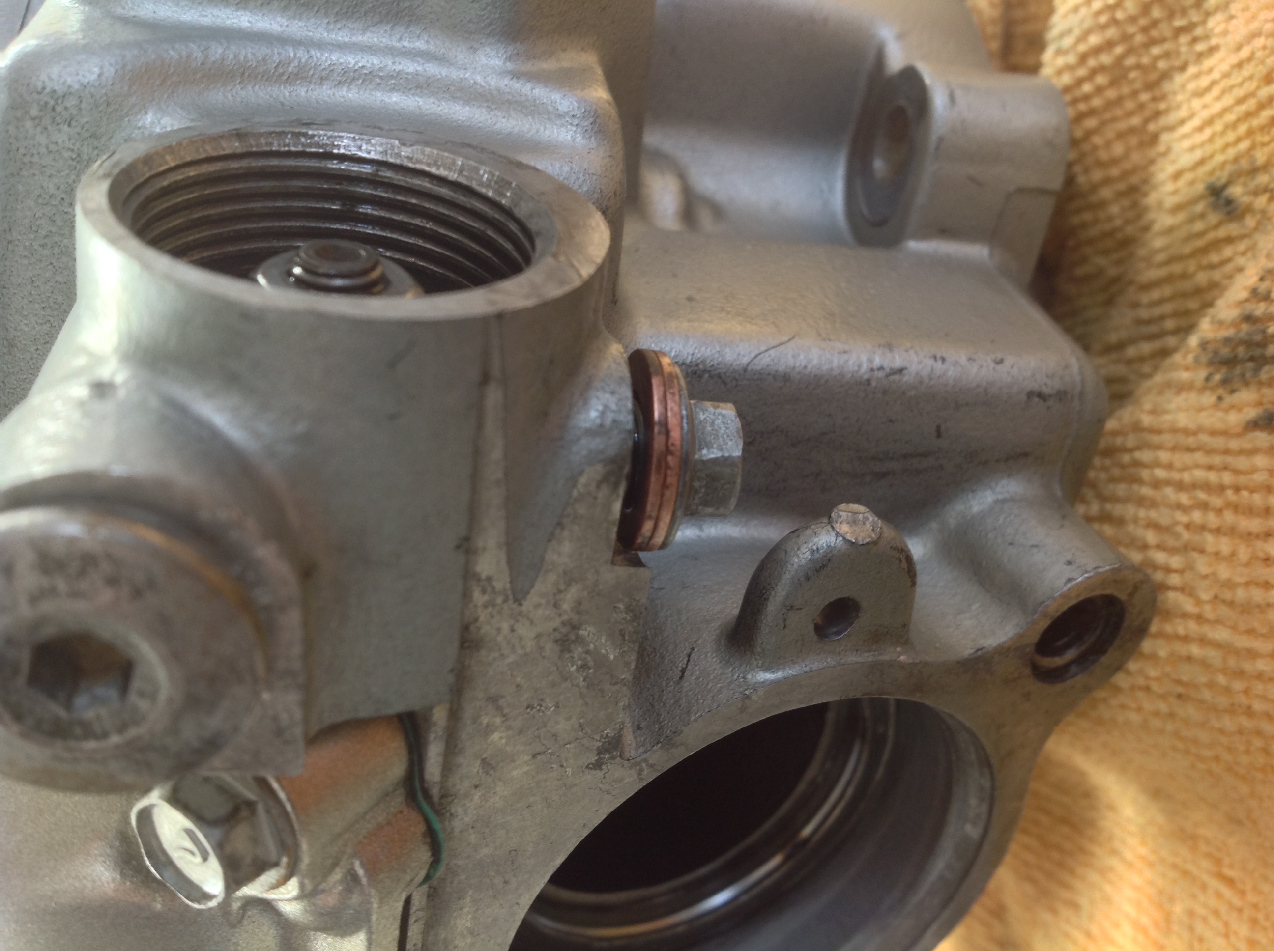

To you guys that know these bikes better.. How much tension should there be when actuating the kips valve? There's a definite break over force required to get past the detent ball in mine. The issue I have is that something is holding it open once it gets past the detent. I am see it start to ruturn, but it doesn't have the force to make the full return... I'm thinkin it's in the actuator arm somewhere.
Re: Kdx220 stops increasing rpm at 1/2 throttle
Posted: 02:34 pm Apr 14 2019
by tmosely1

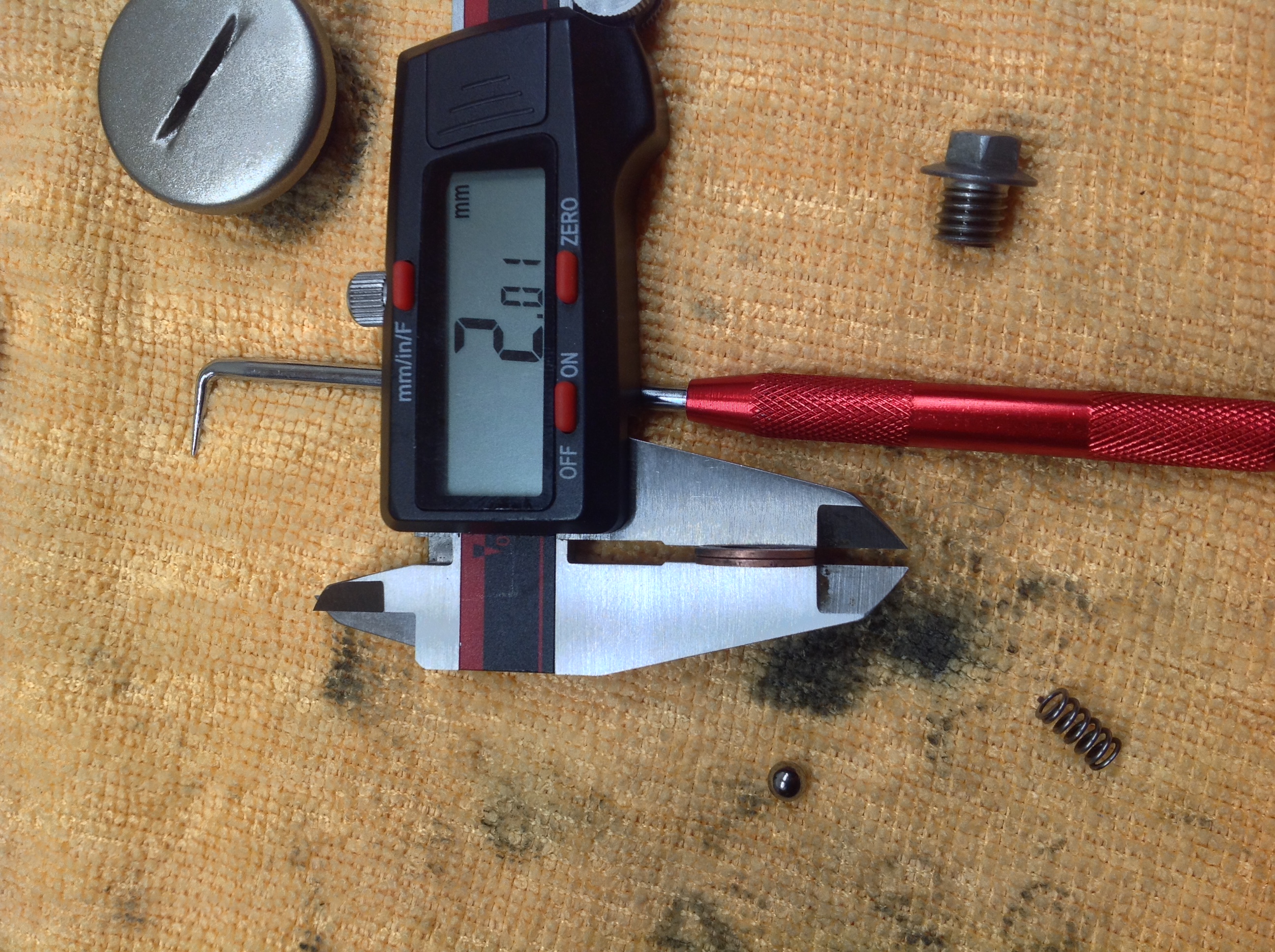

So the kips valve opening and rotational pressure is controlled by the detent ball and spring. Mine already has a pair of copper washers to shim it out. Is that oem correct?
Re: Kdx220 stops increasing rpm at 1/2 throttle - kips issue
Posted: 03:17 pm Apr 14 2019
by tmosely1
Schematic and manual seem to confirm that is correct... Anyone have any idea what the oem thickness is? Possibly they have been over crushed and are providing too much drag?
Posted: 07:49 pm Apr 14 2019
by rexemouse
I just did my 220 and mine has 2 washers. The detent definitely adds some initial resistance.
If your cylinder was just plated, the power valve rod bores can become really rough. I gently honed mine with a drill and some fine grit sandpaper, and this really smoothed things out.
