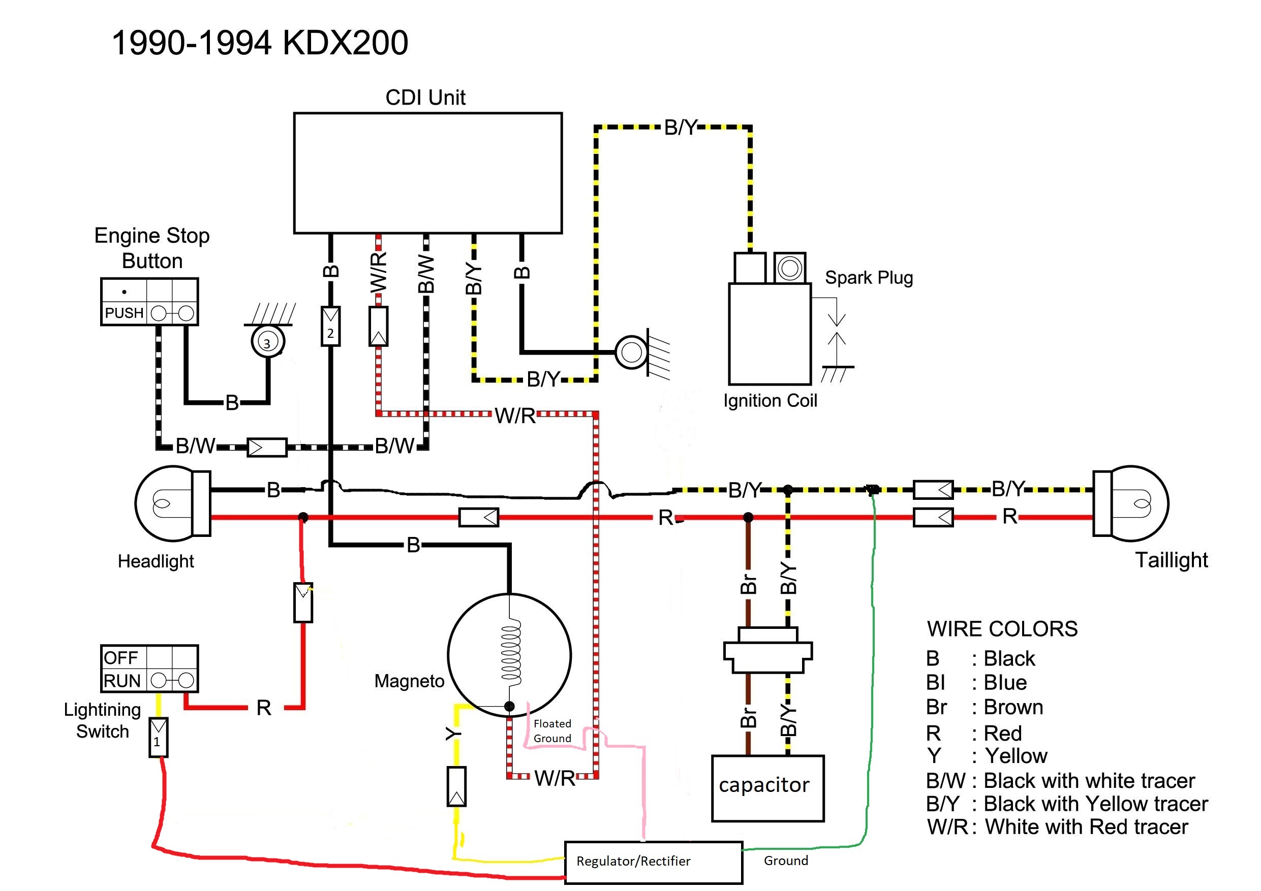

Re: rectifier / floating ground ? (ac to dc howto)
Posted: 08:26 pm Jan 05 2020
by Toonces
Does this look like I'm on the right track? Please excuse my crude graphics.
Reg-Rec - Copy.jpg (409.87 KiB) Viewed 36323 times
Posted: 04:35 pm Jan 06 2020
by bufftester
That will work, but you will only charge the capacitor when you have the light switch on. Not a big deal, but when you initially turn on the switch and the cap starts to fill you'll get dim output for a few seconds.
Posted: 06:18 pm Jan 06 2020
by Toonces
Thanks man, you have been a huge help. Looking forward to finishing this and posting results.
