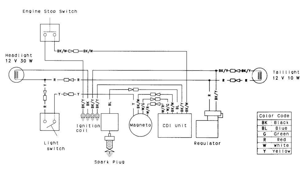

Hello, I'm posting my question here because it's a similar topic. I've had a 1992 KDX 250 for a few days now. It has an incomplete electrical system, and today I tried to complete it to activate the lights.
I don't understand much about this, but I built it exactly as shown in the diagram below, and when I turned on the light, it blew. One possibility is that I have a faulty regulator, but looking at the diagram, there's one thing I don't quite understand. Why does the regulator only have two connections? Isn't it supposed to have one input and one output? AC-DC.
Looking at the diagram, I connected the yellow wire from the magneto to the light switch and from the light switch. I connected two wires, one to the front light and the other to the regulator and taillight.
My question is, what does the regulator do here? If the headlight receives power from the magneto before passing through the regulator,
I hope I've expressed myself clearly. I apologize, thank you.

Posts: 1167
Re: rectifier / floating ground ? (ac to dc howto)
Shunt type regulators simply bleed off excess voltage directly to ground at a high frequency, dozens of cycles per second of switching on and off, short circuiting the extra voltage to ground, which basically leaves your charging system always working at full output even if there is minimal or no load.
A series type regulator will rapidly cycle the disconnecting and reconnecting of the power coming from the state or at a high frequency, 60 or 100+ cycles per second.
We have shunt type regulators. They just bleed off excess voltage to ground.
Posts: 3539
As Chuck said, we have shunt regulators, and it's A/C not D/C. Using a multimeter start the bike and set the multimeter to AC Volts. Measure at the output of the regulator and at idle you should see around 10-11 volts AC, at higher RPM it should go up to around 13V, but no higher. If the regulator is bad you could see it run up to 15+ volts AC which would blow out your light. Very important to make sure your grounds are clean and connected to the right terminals for it all to work.
