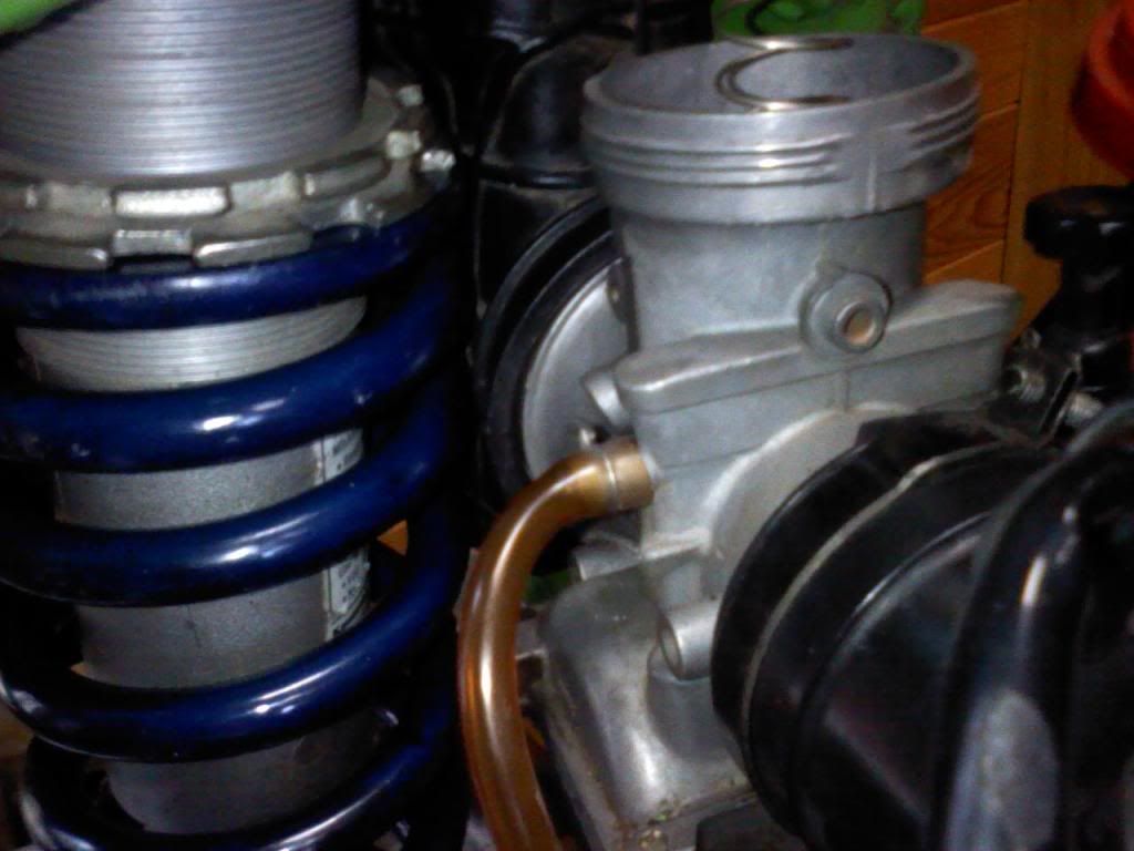

this is the best angle i could get..sorry i had to take it on my phone

Have you put your pipe on yet? I was asking b/c it almost looks like the engine is tilted too far back, causing the carb/boot junction to be right at your shock. If your pipe is way off, that might tell you something.

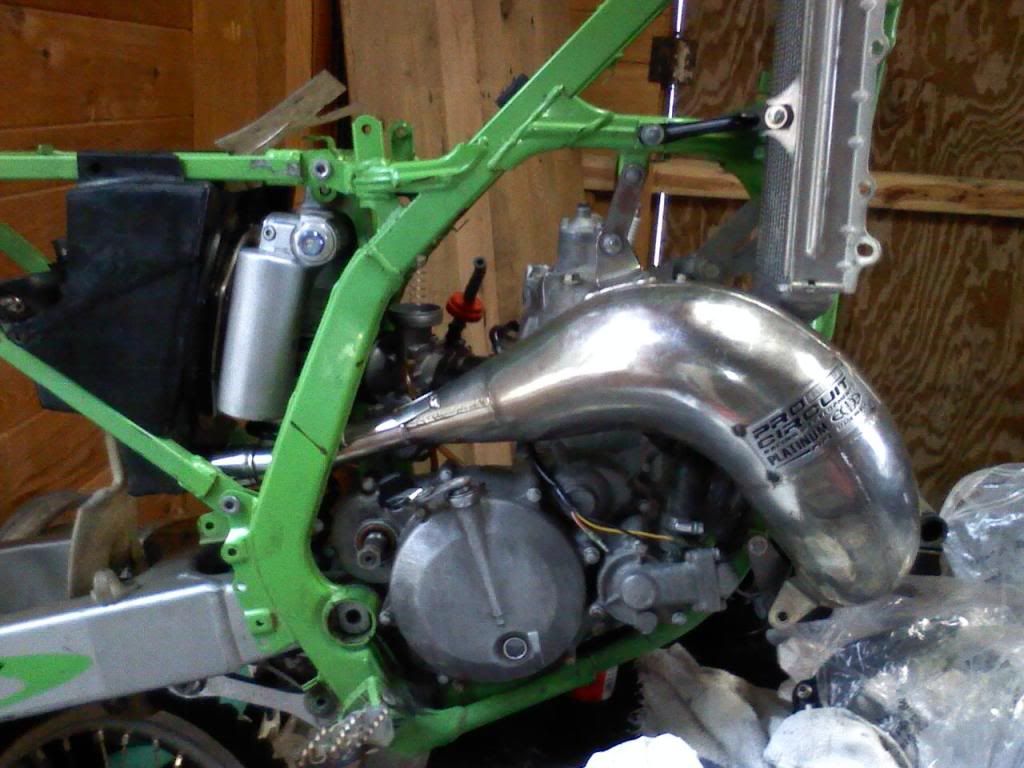

the project is at my parents house right now...im going back wednesday of next week and ill snap some more pics of the pipe fitted up...for now this is the only picture i have of the pipe and airbox on at the same time...
The KX boot was way to big..it actually hit the back of the motor where the carb fits in...thats why I decided to go with the KDX boot which was a whole lot smaller...i have noticed that the KDX boot seems a little fatter around the area where the spring is than the KX boot...the boot is from a '91 KDX..could that be the problem? the motor is a 2000 year model....one last thing...would it make a huge difference if maybe i got some zip ties and pulled them around the boot to "thin it up" a little bit...or would that affect the ammount of air the carb sucks in?

It does look like your motor is tilted back just a bit too much. The boot/carb joint looks like it is almost into the spring. I suppose you could try squezing the boot with zip ties. I'd be worrying about them breaking sometime in the future and your spring knocking the boot loose from the carb
Does the tank fit?
You may have to back up a bit and redo the front and lower two motor mounts. Your pipe might stay like it is if it does not end up hitting the front tire.

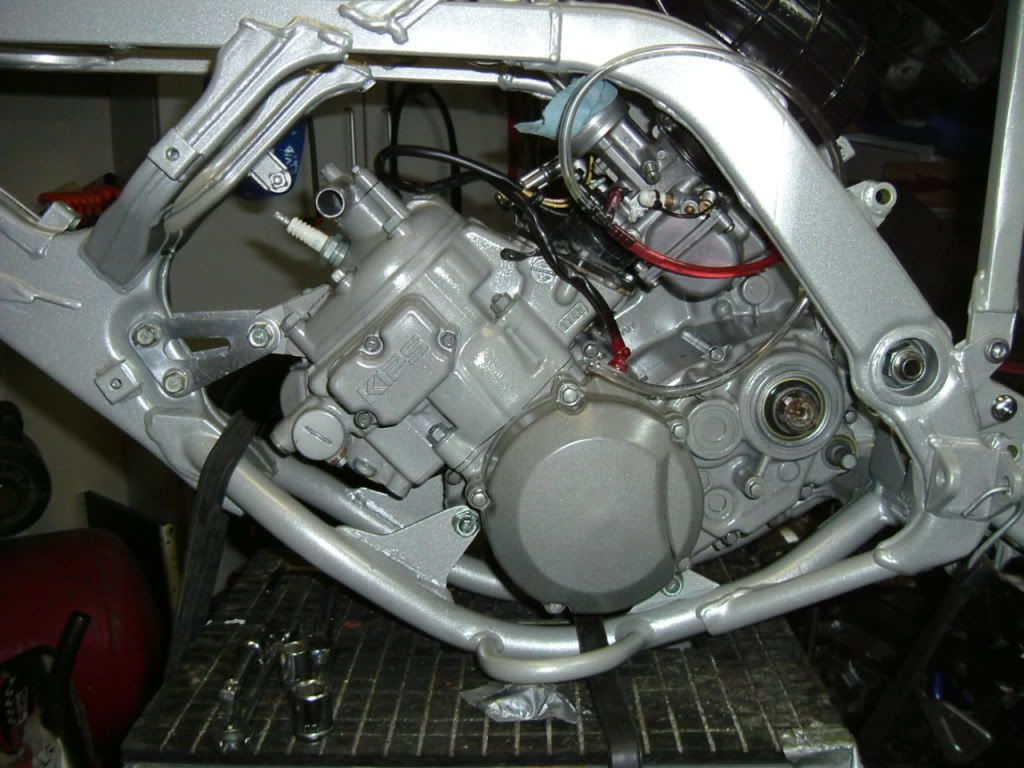

Here's mine yours looks pretty much the same.Image

I dont believe the motor can be moved any farther foreward as the swing arm pin doesent allow it to move...the bottom of the motor is about 1mm to 2mm from the frame so i dont think it can move any farther foreward or down...i may try to cut a larger hole in the air box to allow the carb. boot some room to be moved over a few mm's and clear the spring. any other suggestions....or does this sound like a good idea?

I saw your lower mounts. Your motor is just about on the frame rails. It does not look like it can go much closer.
Redoing the air box sounds like the way to go. It is a KDX boot on a KX box, correct? Those two parts weren't necessarily meant to go tegether so if you are having to make an adapter plate anyway, that plate can be used to shift the boot to the left.
