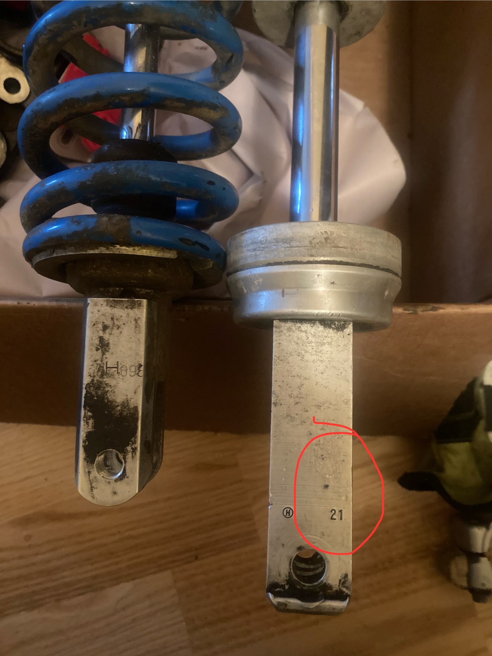

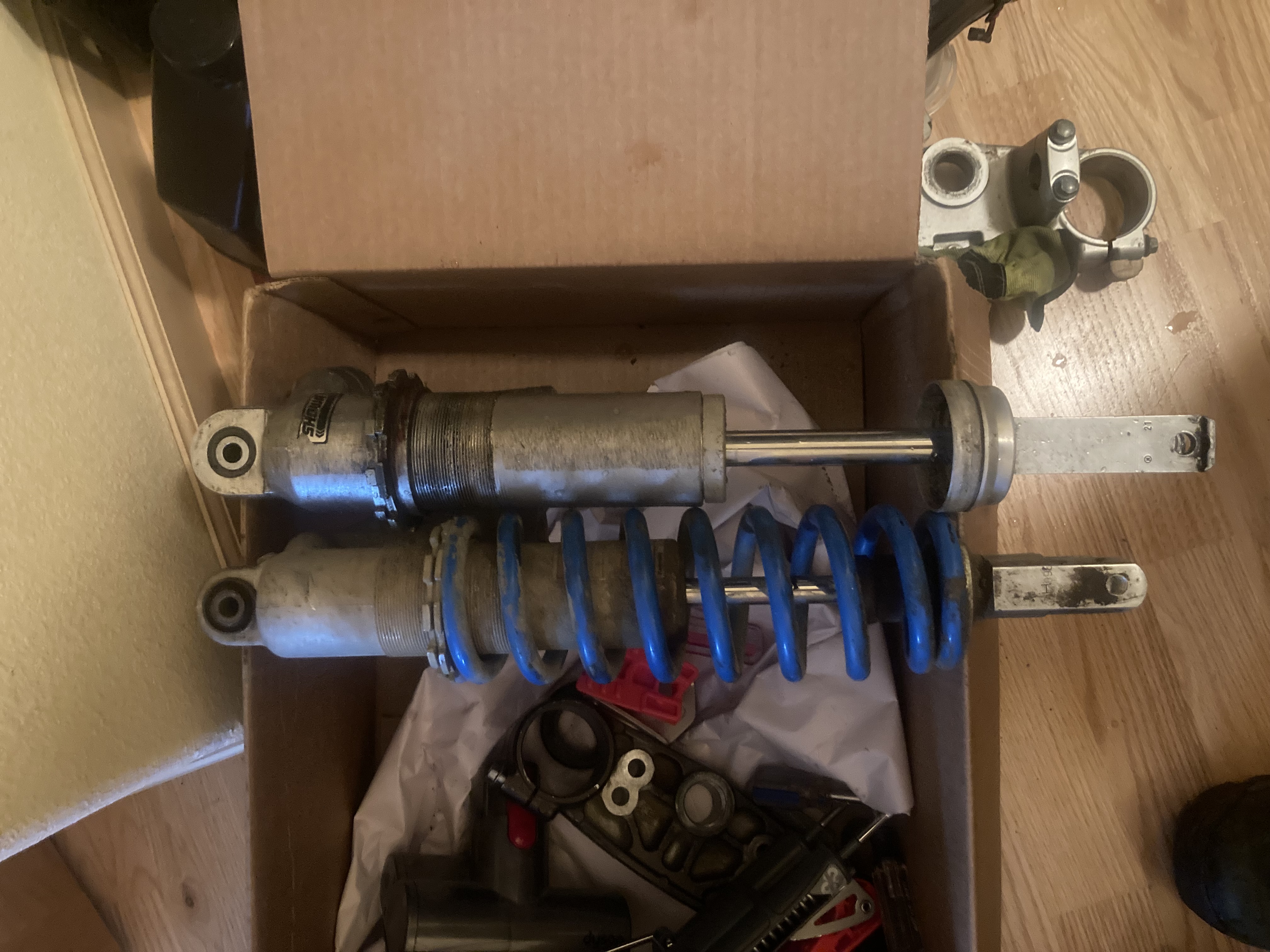

Ok, stripped a lot of the bike down tonight. I guess I'm lucky! the rear linkage looks to just need a cleaning and repacking, everything still actually moves! The rear shock has some oil on the shaft, so it's good I was going to overhaul it anyway. So right now I have 3 ebay shocks, a DRZ, a 2005 RM, and a 2006 YZ (I was hoping to get the titanium spring, but accidentally made an offer on the wrong one!). I also wanted to see if maybe the YZ 46mm body could be adapted to the KDX shaft easily for something better than the 44mm KDX shock body. Well comparing the two, the reservoir on the YZ comes down way too far to be of use.
Now, comparing the DRZ shock to the KDX..... it's only a touch longer, and if I redrill the clevis from the 2005 RM and build the DRZ shock with that, I think it'll be very very close to KDX length. I'm definitely going to experiment with that.
I was happy that all the linkage bolts came out easily, and were clean with a little bit of lube on them. Even the swingarm bolt came out easily.
I just need to find a service/rebuilt kit for the 44mm KYB shock now.

Chopperpilot wrote: 11:59 pm Jan 25 2025 Now, comparing the DRZ shock to the KDX..... it's only a touch longer, and if I redrill the clevis from the 2005 RM and build the DRZ shock with that, I think it'll be very very close to KDX length. I'm definitely going to experiment with that.
Cool, that sounds like a pretty excellent combo from the parts you have!

So, after getting the YZ front forks squared away and pulling the top end off to see what it needed (sending it off for a replate and might as well do the big bore while there) I started on the rear shocks. Right now I just have the KDX shock dismounted and I squeezed a 2003 DRZ shock in it's place to 'see'. Today I disassembled the two Showa shocks (2003 DRZ and 2005? RM 125) to see about swapping up parts in them. The 2005 RM shock has the longer clevis, but looks to be able to be drilled to a shorter overall length than the DRZ setup. The DRZ has a shorter body though. Well here is the DRZ body with the RM shaft (larger 18mm shaft). The red circle is a mark I made where I believe the clevis can be drilled for the KDX knuckle without having to clearance anything. A slight bit more could be had with some beveling/sanding.
Anyway the DRZ body with the RM shaft, if the RM clevis is drilled to a shorter overall length looks to be like it could be within 5mm of the KDX length.
I also had gotten a YZ shock off ebay with the intent to see if the 46mm body could be used with the KDX shaft, it cannot, the reservoir is way to long on it. I then wanted to see if perhaps the spring was a slightly smaller diameter but would fit on the Showa, and reduce the interference with the engine case at top out, this will not work either. The spring outer diameter appears to maybe be a couple mm smaller than a showa spring, but the ID prevents it from being able to slip over the showa bottom spring retainer piece that stays on the shaft. So now I will just see if maybe the HS compression adjuster can be put onto the KDX shock, maybe?
Having the Showa shock be the same length as the KDX shock will definitely ease up on the clearance required of the engine case as the knuckle moves further away at shorter lengths.
My next move will be to take apart the KDX shock and compare total travel (minus bump stops) between the KDX and the Showa DRZ/RM combo. One interesting thing is that the RM shaft is noticeably longer than the DRZ shaft. The RM seal head had a top out spring that limits the free extended length of it and the DRZ seal head did not have this. I'll also use my drill press and drill the clevis out for the shorter length. I figure I can tap the other side just like the KDX setup so that there's no need to put a nut on the other side of the clevis.

I wouldn't offset drill that clevis too much at all, it will generate more side load the shaft, not a good thing. A slight bit should be fine but I would still consider clearancing the crankcase rear portion for the majority of the clearance.

Oh, I'm not going to offset drill (I didn't say that though). I just made that mark when I was sliding the knuckle into the clevis. I wanted to accurately eyeball the center of the hole in the knuckle and make a vertical reference point on the clevis for where the centered hole would be.
Possibly a touch higher with clearancing the clevis and knuckle some.

OK, got some interesting data today. All this was measured from the frame on a stand with forks and front wheel on, and using a tape measure at the end of the swing arm from the garage floor. Looked at swing arm travel without a shock mounted and found that the dog bone links (pull rods) limit upper travel if the shock doesn't. With a 110/100 shinko 505 (fresh) and pulled all the way back on the swing arm (not realistic) the dog bones prevented the tire from stuffing into the fender, just lightly scraped an edge. I believe total swing arm travel was somewhere around 14". Droop was stopped by the knuckle hitting the frame. You really see the progressive nature of the linkage system when you watch the knuckle horn (where the shock would mount) move about 1:1 at full droop and then rapidly moving much faster than the swing arm the further up the travel you go.
I then mounted KLX650R 115mm dog bones on it and found that they essentially moved the swing arm up 1/2" apparently at the top and bottom of travel. The tire would stuff into the fender with significant interference (again with no shock mounted).
Next I installed the RM shaft into the DRZ showa body and installed the clip to hold the seal head in place (no spring or oil or reservoir bladder). Because I found that up travel was limited by the tire/fender/dog bones, I drilled the RM clevis slightly longer than I previously thought about, trying to get a little more height/ground clearance/maybe travel (but still shorter than the DRZ shock setup). This ended up with 3/4" gain in 'ride height'. I had to bevel the RM clevis to allow full shock droop to be the stopping point instead of the clevis hitting the knuckle. Next I checked travel and here's where things got 'interesting'. Total swing arm travel (with the frankenshowa fully drooped out) was only 9"! Now the piston stack/seal head are 'taller' on the RM shaft vs the DRZ, the RM shaft is also longer than the DRZ shaft. The RM shaft was still able to go fully into the shorter DRZ body though and appeared to stop when the top of the clevis hit the cover of seal head. I'm not sure what to make of this, I'll probably try the full DRZ setup in the bike and see what that does for travel, but eyeballing the two shaft setups, I don't see the extra 2.8" of travel by using the DRZ shaft (isn't the KDX supposed to have 11.8" rear?). So next thing will be taking the spring off the KDX shock and mounting it in the frame and seeing the 11.8" of travel. Full disclosure, I used a tape measure but was still eyeballing everything, so if we were talking about a 3/4" discrepancy, I would blame my non precise measuring technique. Oh the RM/DRZ shock combo had 118mm of shaft exposed for travel.
