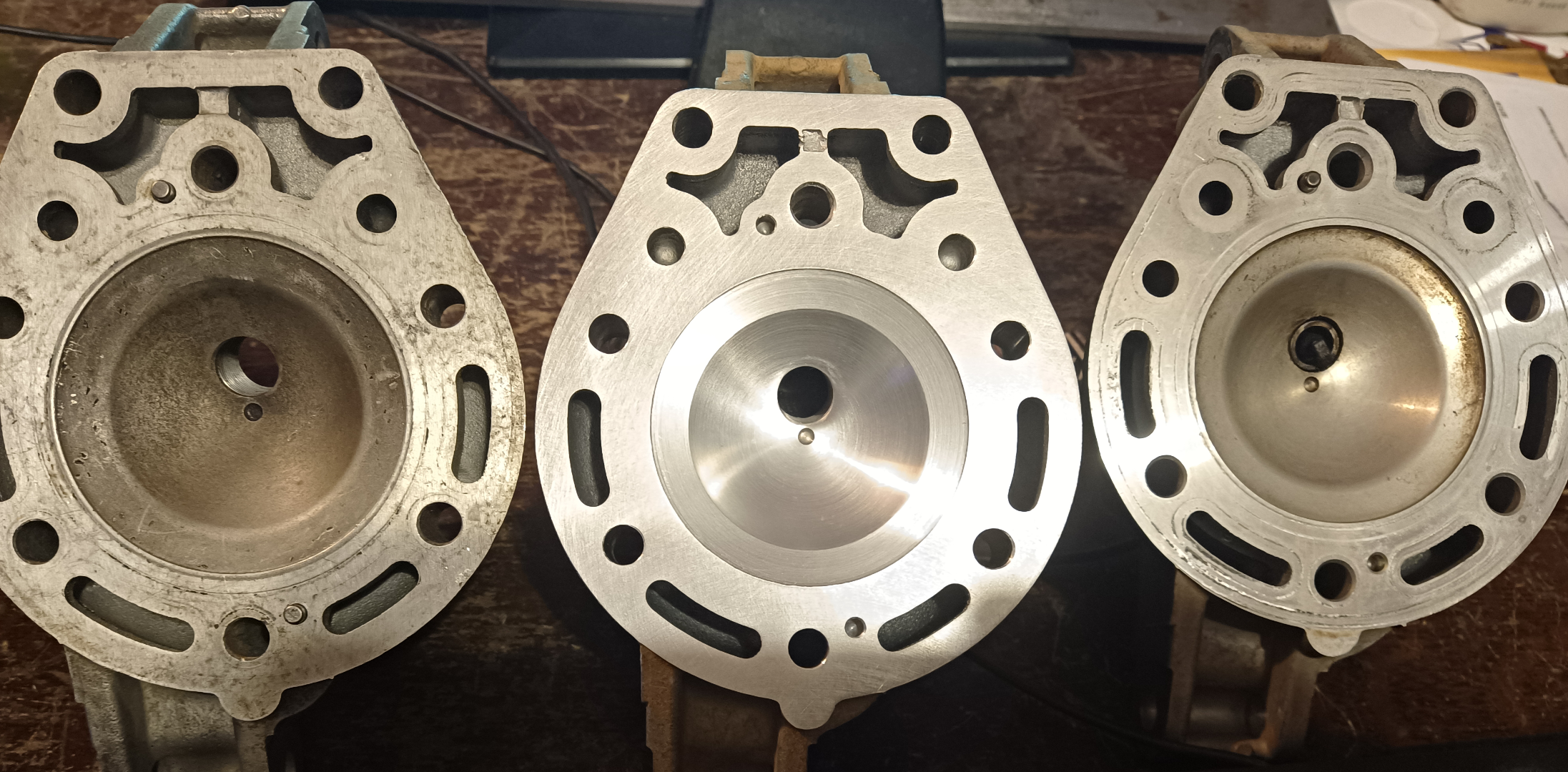

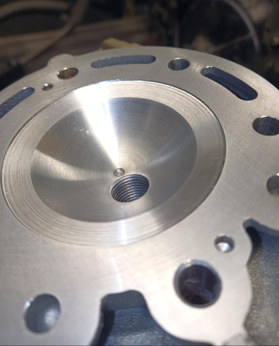

An RB modded head will have been completely rechambered, with a nice crisp transition between the squish band and the combustion chamber / dome, and a nicely machined and smoothed surface.
Most others I believe would have the stock chamber and squish band, and would just be milled on the head gasket surface to reduce the piston to squish band height ("squish height") & increase compression ratio as an intentional side effect.
The 220 runs significantly better with an RB head, but will also be well improved over stock with just a milled head, although the higher compression ratio vs an RB head will limit the top end power while increases low end throttle response and torque. The 220 does quite well on low end torque through it's porting, so a higher compression head isn't necessarily needed, but the tighter squish band clearance is absolutely critical.

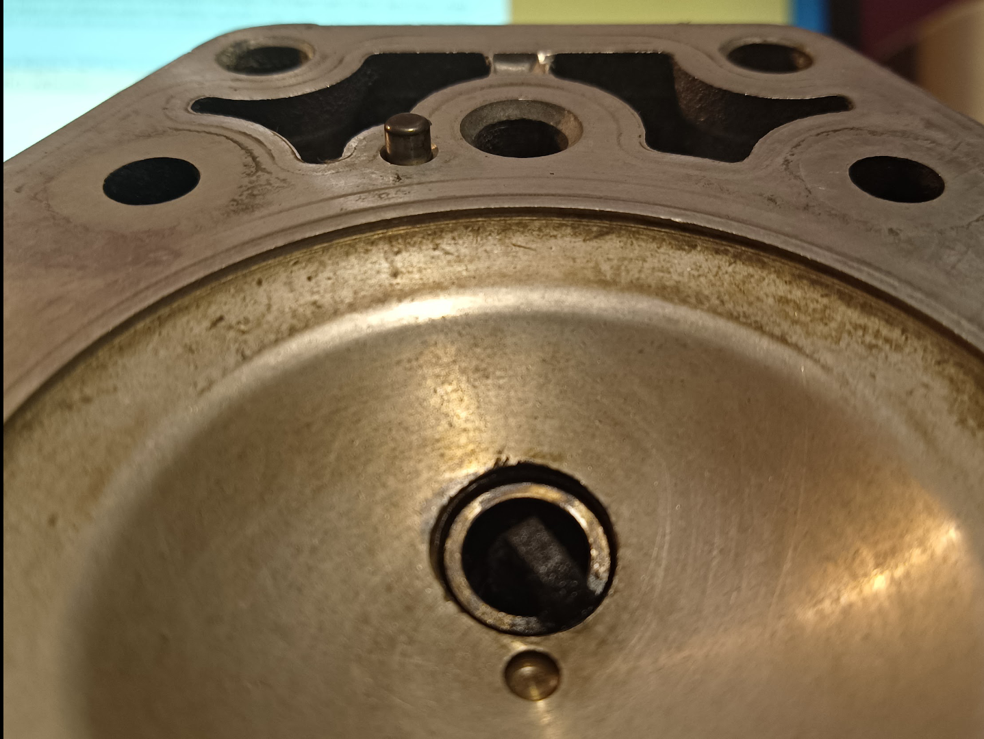

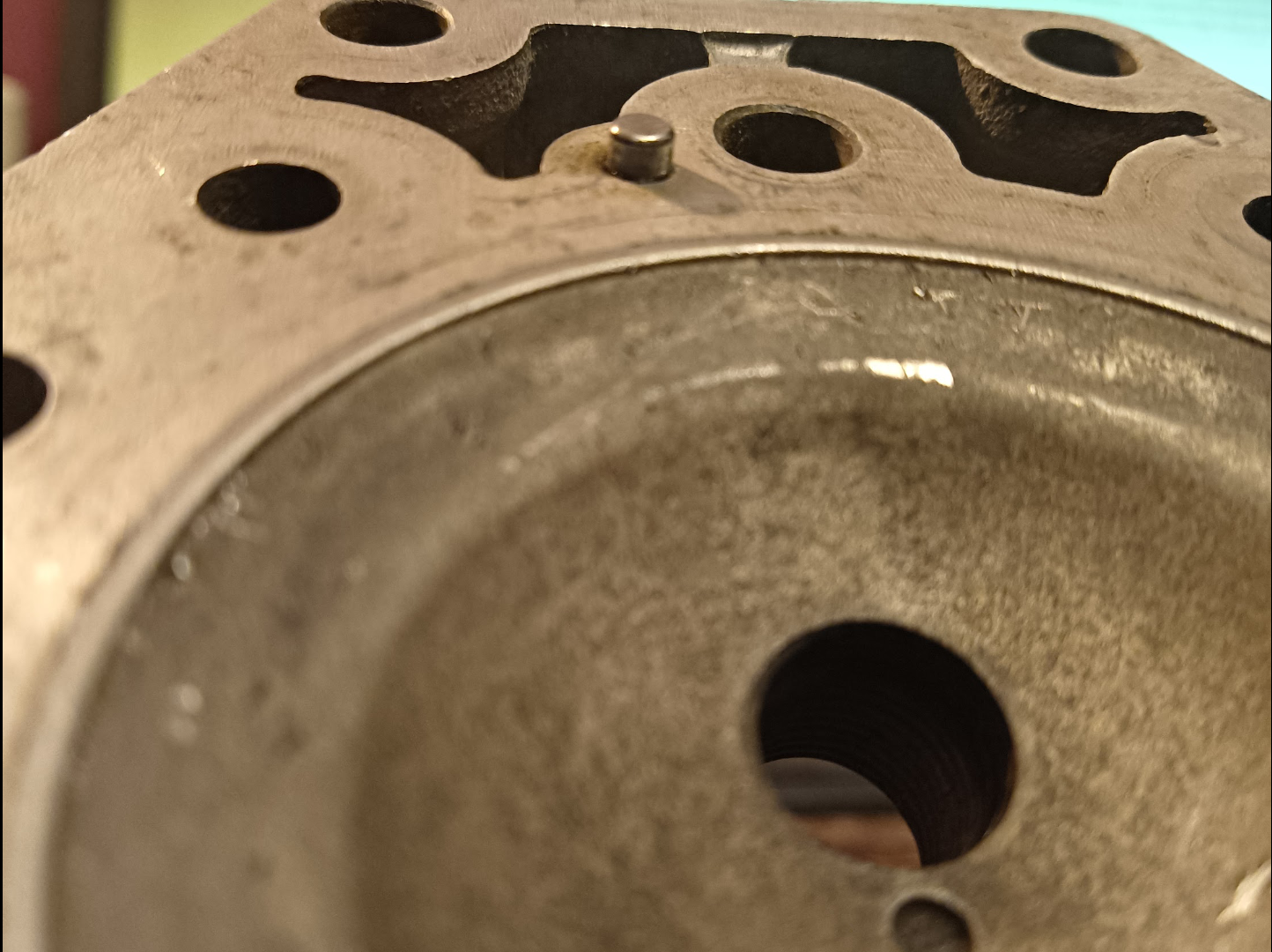

Looks like maybe not?

I'm fairly certain that is totally stock, not shaved, definitely not rechambered as Ron Black the great KDX tuning master once had done.

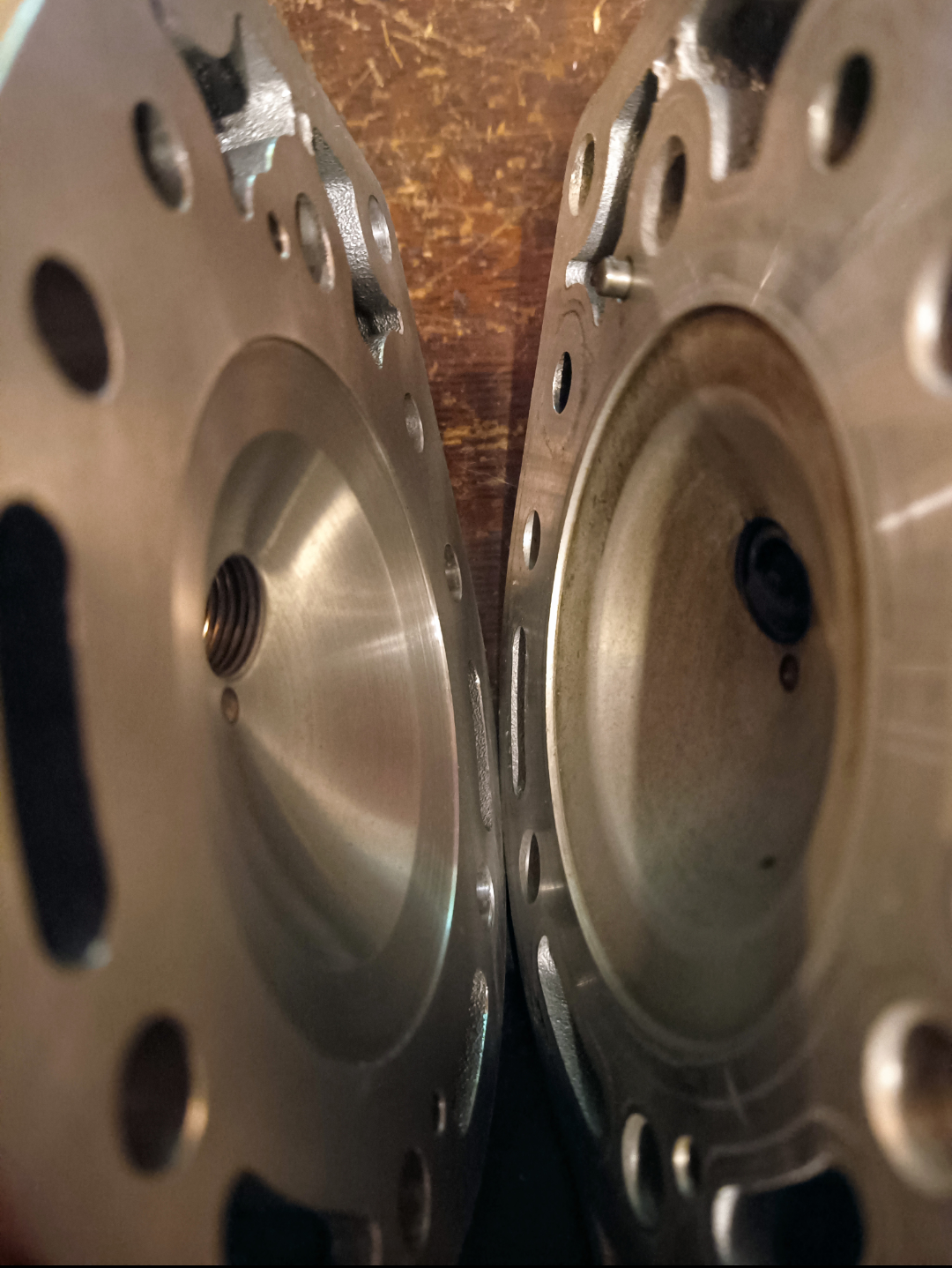

My apologies, I'd forgotten to go back and add a photo of what I believe is a Fredette head (milled only) vs RB head (milled & completely rechambered) vs stock.

Stock 220 head:
Milled 220 head (Fredette?):
(with some detonation damage marks, this is a fairly high compression head requiring high octane, octane booster, or race fuel)
RB 220 head, milled and rechambered, similar compression ratio to stock (higher octane pump gas recommended) but a tighter squish clearance and sharpened transition between squish band and combustion chamber dome):
Ron Black 220 vs stock 220:
All 3 220 head versions:

Just milling the head via Jeff Fredette does similar enhancements, except that for one, it will require higher octane than an RB head as evidenced by the light detonation marks on the head I have pictured that's just milled and not had chamber volume alterations and squish band alterations done.

Chuck, that's amazing! Great photos for e different cylinder heads & tons o' notes! Thank you.

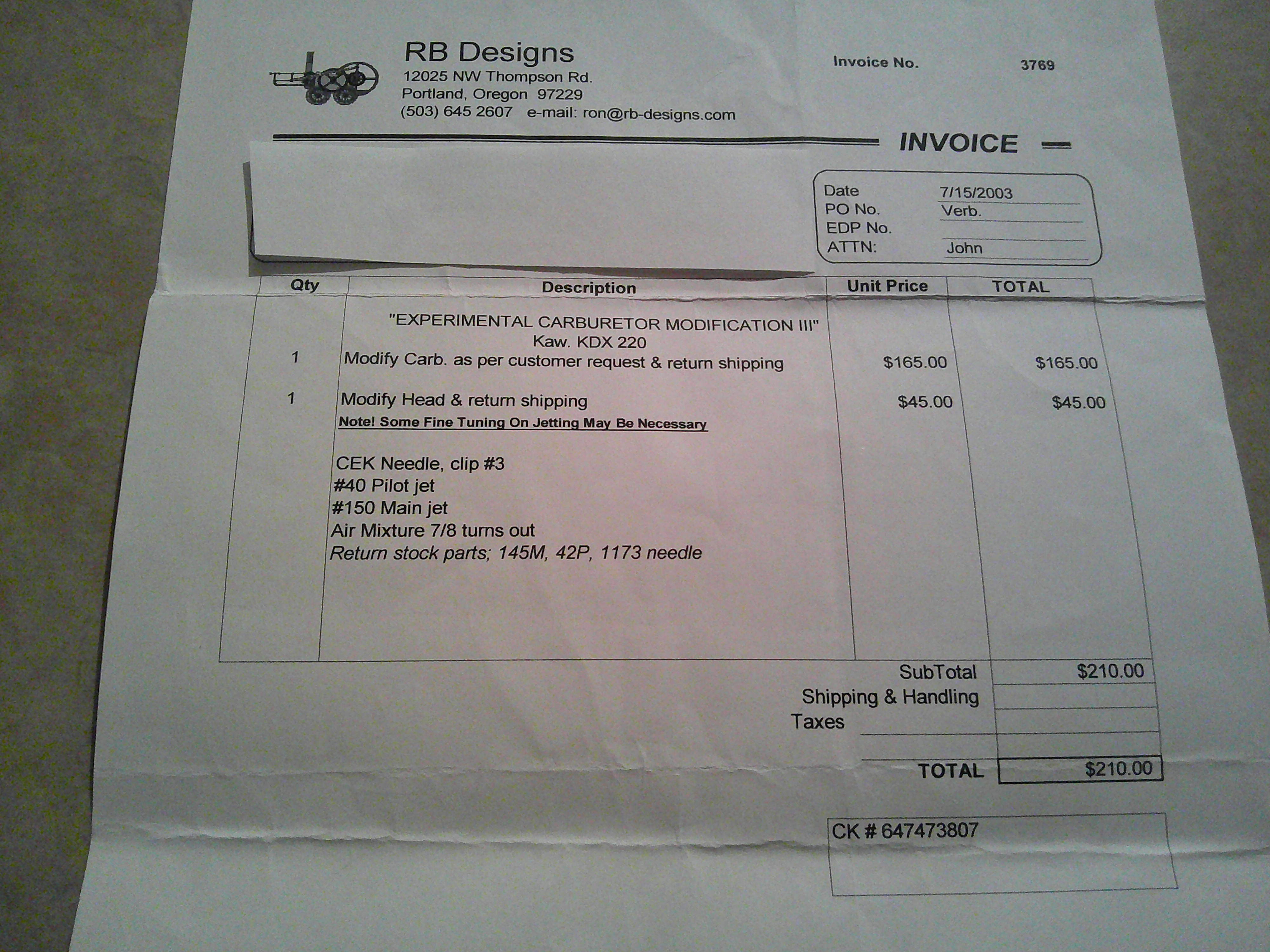

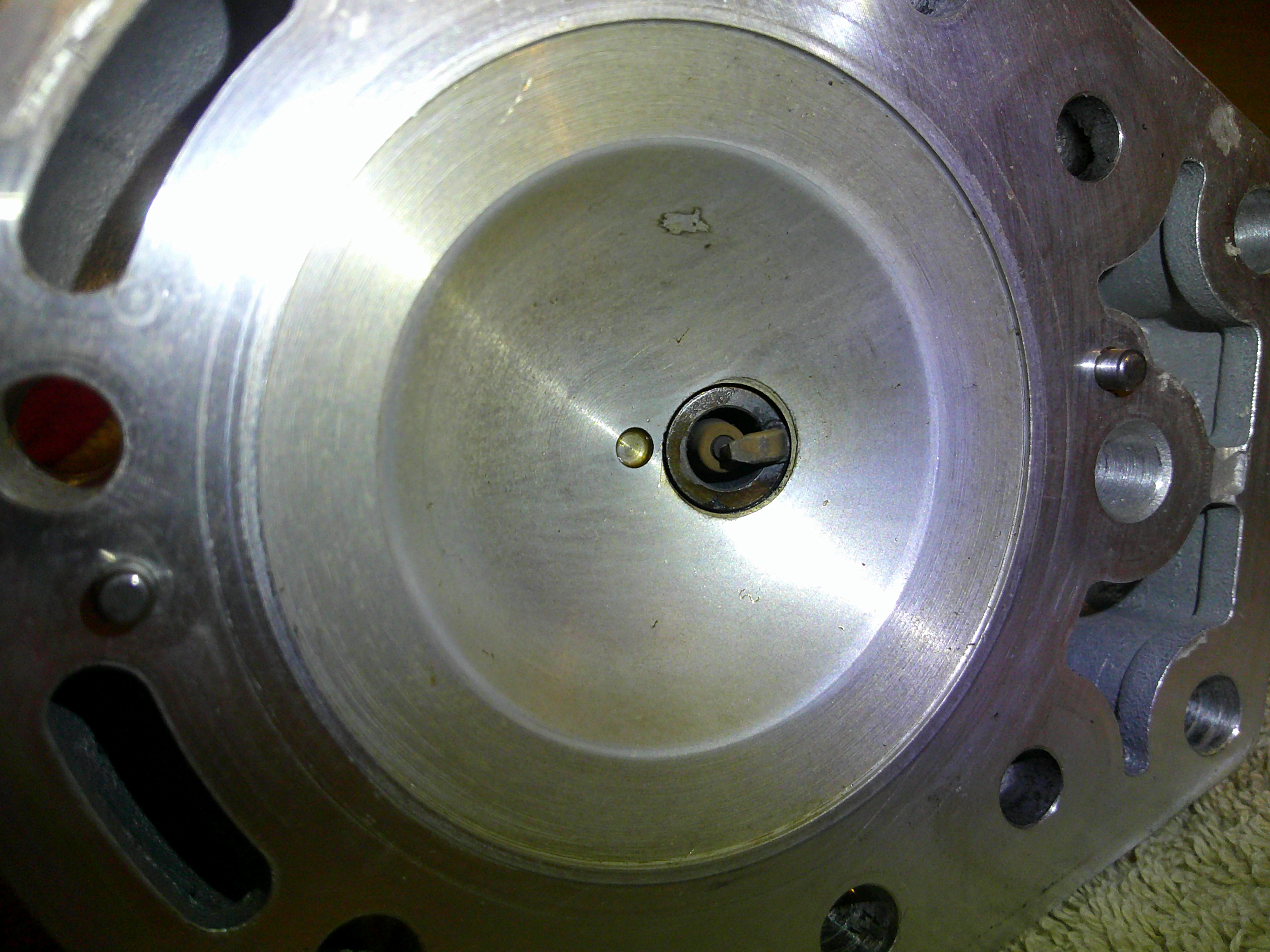

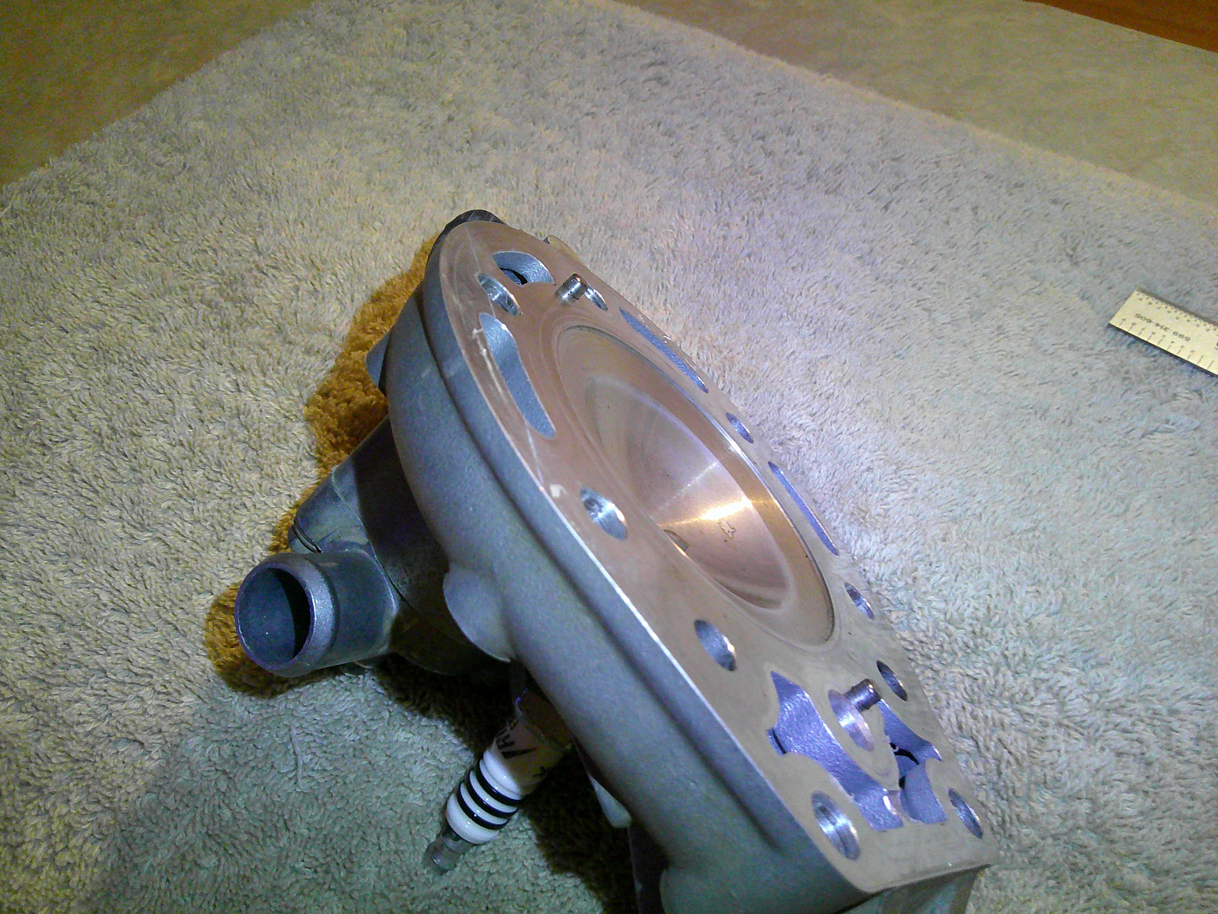

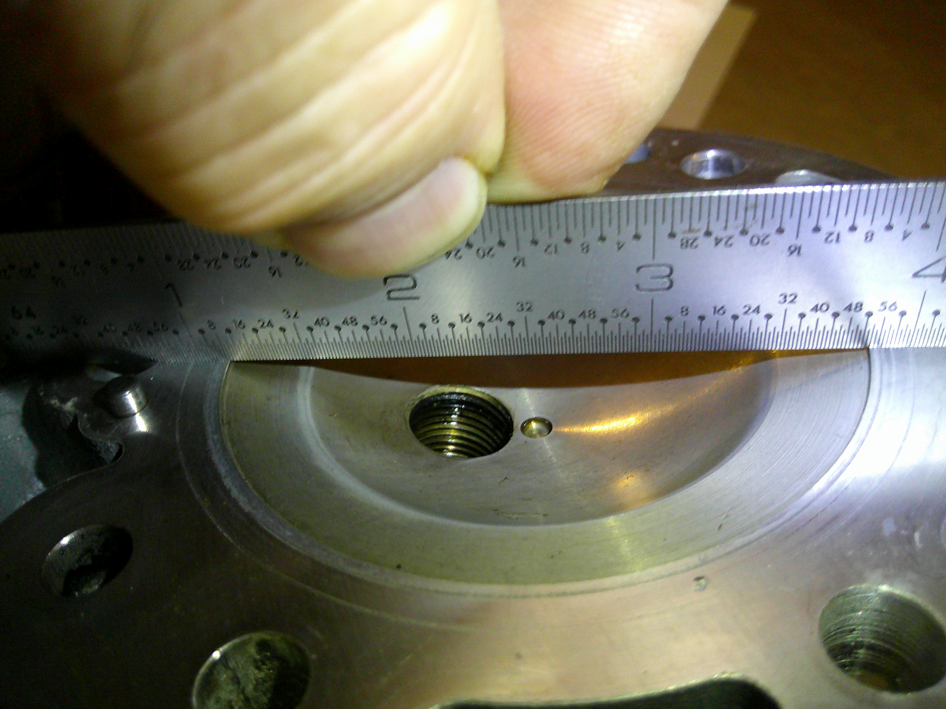

Here is my spare RB head.

Molly's those are amazingly clear photos and it's amazing you have the 2003 paper invoice. Thank you.

Interesting, your older RB head looks to use the stock dome, for much higher compression than the RB heads I have here... Your VP Race Fuel's higher octane is necessary then...

The RB head I have on the engine now Ron did May of 2022. No pictures of it. I had purchased the top end from a member here & had Fredette
port the cylinder & he sent it to Millenium for replating. Also, May of '22. I have receipts for that work also.
