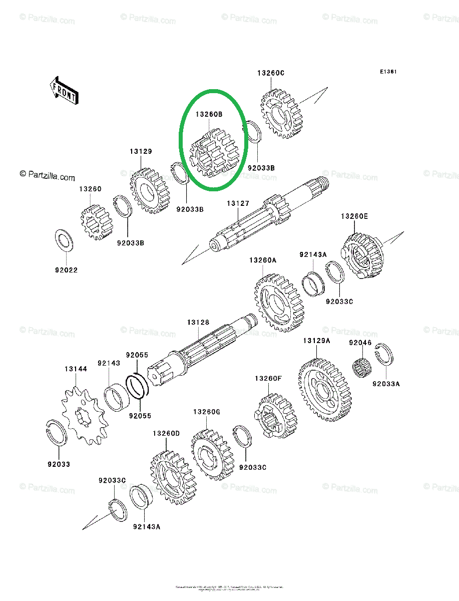

Is this the only gear you need?
2001 KDX Transmission.png (111.5 KiB) Viewed 5355 times

No I’m most likely gonna need all of the gears bc I have more than 1 chipped gear
Re: Transmission gears
Posted: 12:45 pm Sep 06 2024
OK, look for 2 shafts and gears from a 1995 - 2006 then. The shafts don't have the same part number on 1989 - 1994 KDX200.

Joeymf wrote: 01:58 am Sep 06 2024 Another question I have is can I swap gears from a 89 into my 01
The 3rd/4th gear set part # 13260-1006 then yes it fits from the e series, same part # and tooth count 15t/17t, the output shaft is also the same part # 13128-1164 so if you find a good complete gear set from the e series it's also good for a spare,3 other gears also cross over between the 2 series if those might be the other gears you need.
https://en.impex-jp.com/catalogs/moto/k ... 91193.html
https://en.impex-jp.com/catalogs/moto/k ... 88958.html
