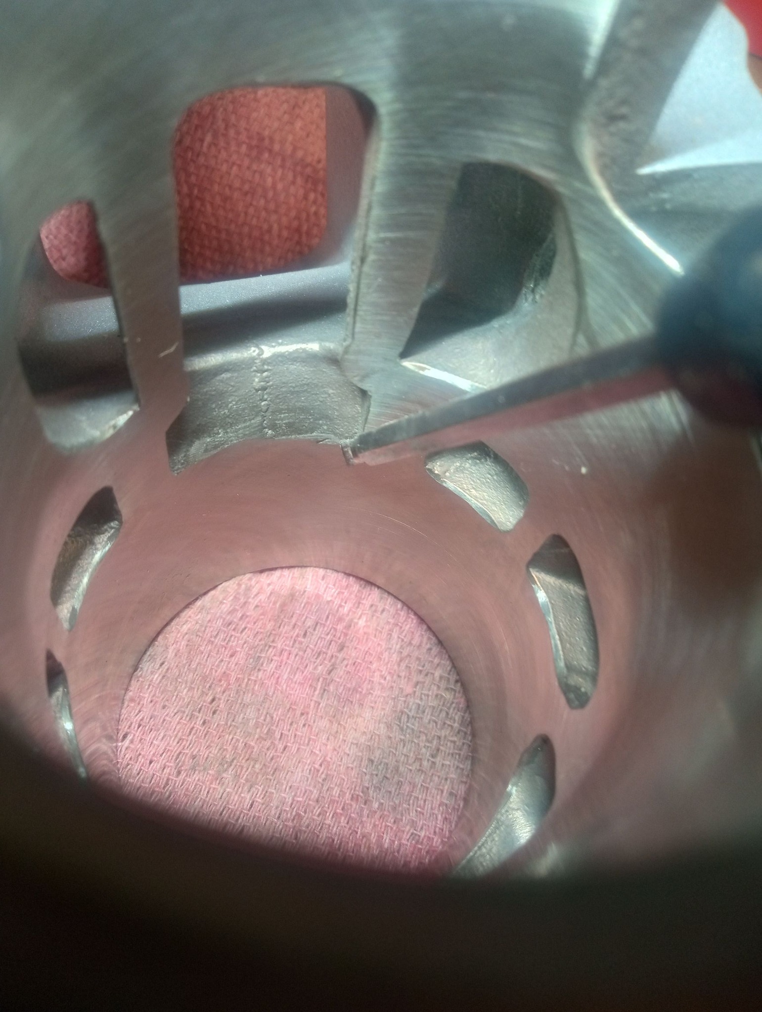

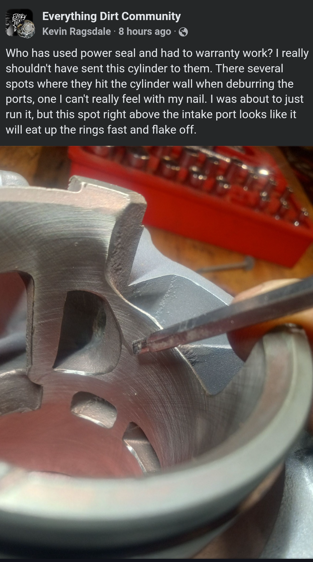

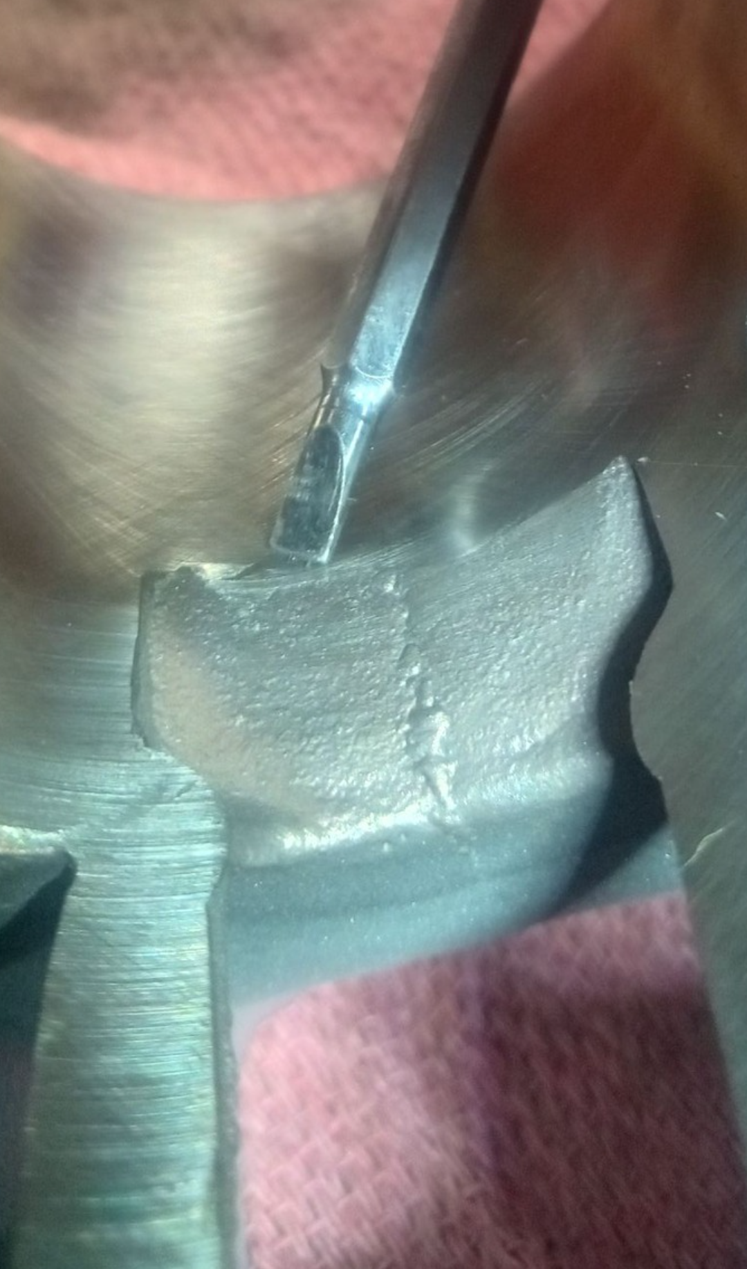

PowerSeal was looking like my more favorable option again, but I think I'll sway either to Millenium still, or else send my cylinder to Boyko Racing or Tom Morgan Racing for port cleanup and port chamfereing and deburring beforehand and then PowerSeal would be a perfectly fine choice on just the plating work... Some poor work is being reported from PowerSeal similar to what I've seen and experienced for many years now.

That's some disgusting deburring, I can do better with a needle file

I think the original poster and I both have realized that we may be best off going through a small time professional engine builder for cylinder plating, as they will do more well scrutinized and careful chamferring, deburring, and general inspection of the cylinder condition before sending it off to be plated by the companies who we would otherwise just send our cylinders directly to. I was less than pleased with all the above mentioned work steps after getting my Powerseal cylinder back, although not as bad as the guy in the screenshots
