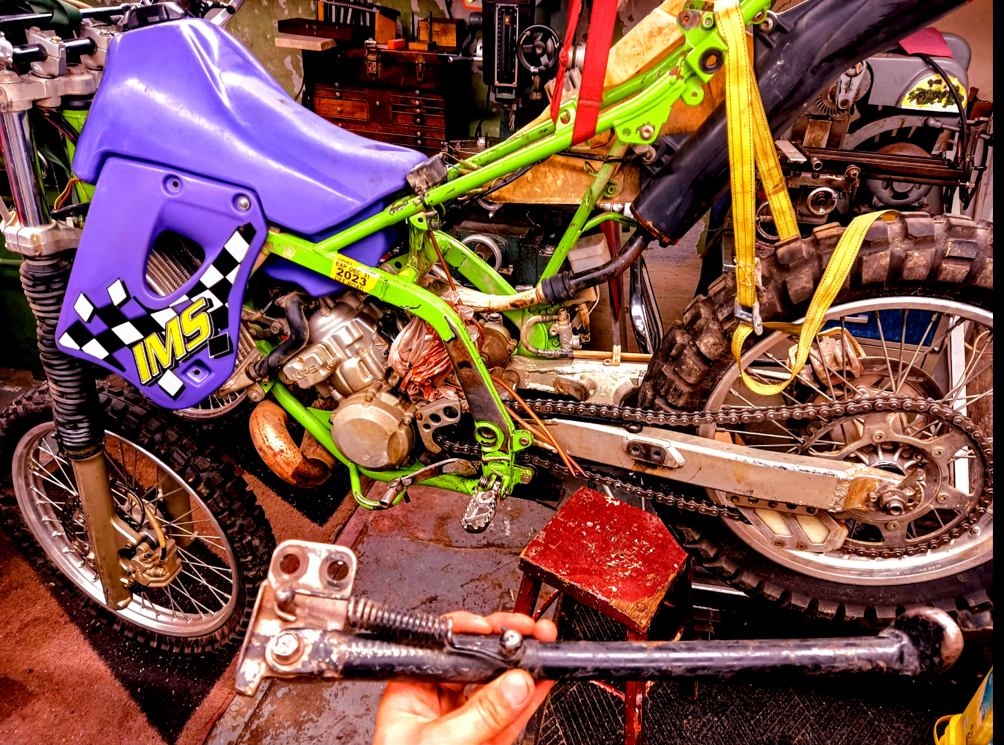

by Chuck78
I might potentially sell the kickstand I have here. It's been bent, heated, and straightened, all by me, as they often suffer frash damage or are leveraged on when strapping the bike down to trailer/truck bed and bend inwards, andno longer properly hold the bike up.
I have no plans to run it on either of my KDX220's, but it was holding the '99 up in the shop before I hoisted it up at working level to use as a testbed for developing a modern Showa 50mm shock fitment to it. Eventually, I'll be modifying the frame to accept a Trail Tech billet aluminum kickstand intended for Yamaha YZ125/250 or YZ250F, as I have done to my other '97 KDX220 already (that original kickstand now resides on a '93 KDX250, worked perfectly except the bolts were too long & the '89-'94 probably has the same blind holes (dtilled/threaded through the welded on kickstand mounting lug, but not drilled through the swingarm itself) as the KDX250 from the sounds of it, so you'll likely need to cut/grind down the bolts shorter, clean, & install with threadlocker, and then you're good.
I can bolt it back on and check it's alignment to see if it's gotten bent again since I straightened it years ago. I suppose I don't mind selling it, especially now as I found a triangle type slip-in motocross kickstand thing at the Tornado Single Trax trailhead 2 weekends ago when everyone else had left... It's a sign that I should unload the OEM stand I suppose!

by Chuck78
Here ya go, I had it sitting across the room from me as I typed the first reply!
