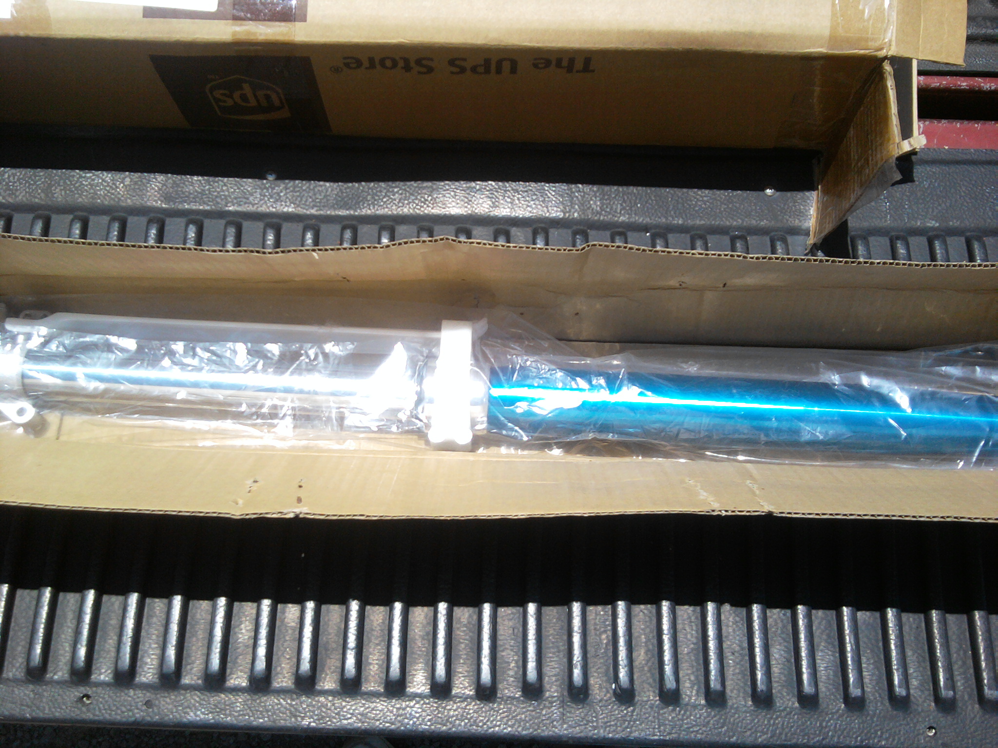

I have not had mine open, but I do own a new set of those forks for my "I'm going to rebuild it one day" 1993 KX125:
