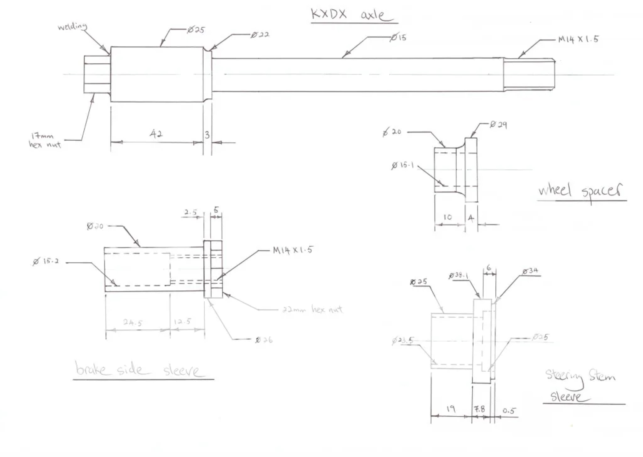

Thank you. I seen you offer up making the spacer for the top KX triple clamp. Is that something I can get from you? I have everything ready to go except a solution to that spacer. : ). Thank you

I might be able to make one. Let me see if I can find the specs I drew up for it.

This is the drawing Jeff Fredette used for the sleeve (bottom right hand corner) I just put in Doakley’s 220 with the conversion.
Please note you can have them machined out of different materials, but he recommends stainless steel, which is what we did. If you guys want him to do you one he would probably do a gross of them and make them available for sale.
The one he did for me fits like a glove.
