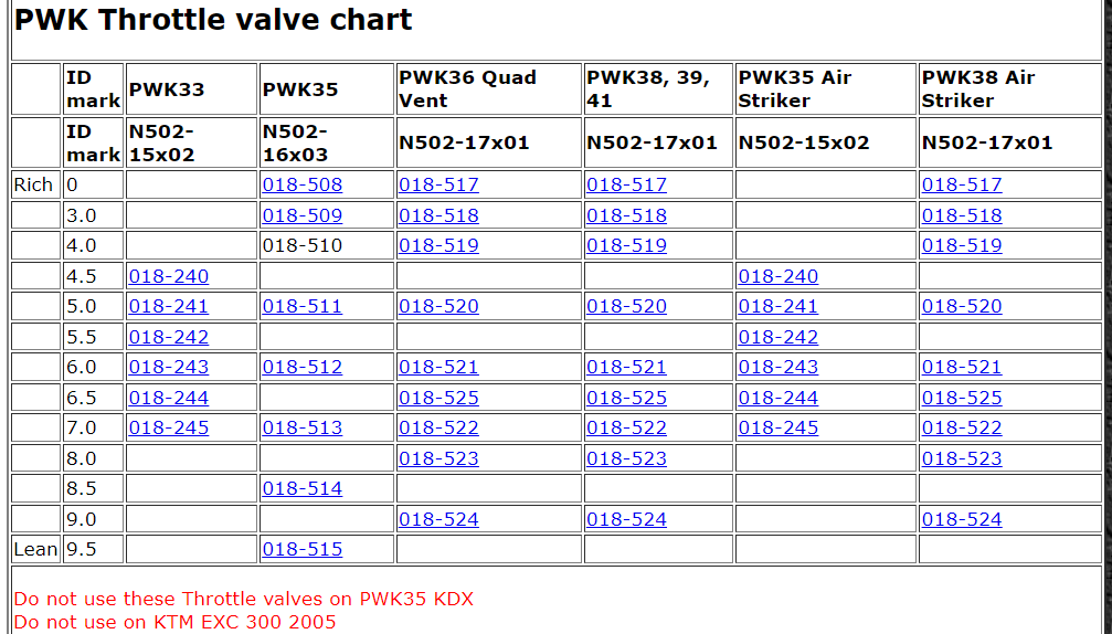

There must be something different about the KDX carb. I haven't heard of people having problems with genuine replacement slides but its interesting that Jets R Us says "Do not use these throttle valves on PWK 35 KDX." They're referring to every slide. I wonder what it is that would make them print that specifically? The KDX and one model year KTM 300.
I have a 33 and bought a 35 air striker so no experience with the factory 35.

That's interesting, I have never seen that the KDX PWK 35 takes a different slide than the KDX220 PWK33 or any other standard PWK35.
