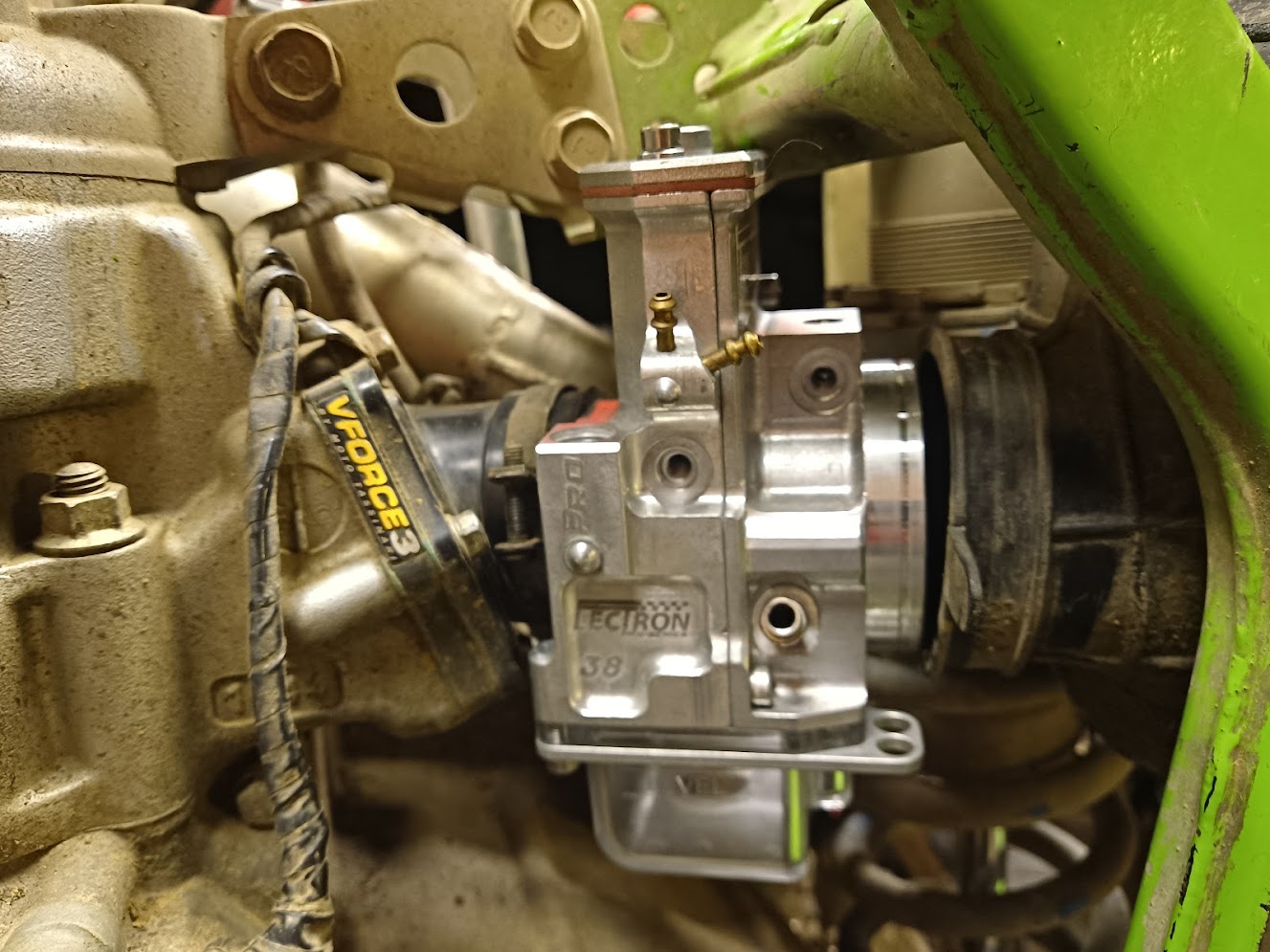

The GREAT NEWS is that on my '97 220, I found exactly what I suspected from my first test on the '99 220's stock intake - that the VForce3 reed cage and intake and the Boyeson RAD Valve reed cage/intake (that both make the 34mm standard Lectron a very poor fit that is NOT recommended), actually make these short body Billetron carbs fit BETTER than with the stock intake/reed cage!
Since the airbox to carb to engine path is angled from the outboard airbox connection & inward to the center intake on the engine, the further back you push the carb, the further away it gets from the head stay engine mount brackets and frame tabs! This is a huge win for us here...
Billetron Pro + VForce3 top view clearance
The 45 degree angled corners on the top cover touch the frame's welded on headstay mounting tabs with the VForce3 or Boyesen RAD Valve, but with either of those, the carb is able to rotate a lot closer to level horizontally left & right than with the stock intake/reed cage, but still not quite vertical.
BilletronPro + VForce3 angled top view clearance
one more clearance shot. I'll pull the top cover to see how much gasket surface we have to work with, and we very well may be able to shave this thing down with no harm to anything, after all, Lectron takes a LARGE amount of material off the side of the 34mm carb to clear the KDX better. I highlighted in my videos to them how they only really need to shave the top side and top cover edge within 8mm of the side corner though.
Billetron Pro + VForce3  top clearance to shock crossmember dimpled in area
My Lectron 34mm is installed with the ill-advised VForce3 intake, and fits poorly and sits at a very noticeable angle, but it still RIPS, and works pretty awesome. This Billetron Pro fitment doesn't quite sit level as-is, but the angle is almost level within a few degrees and is very acceptable to me, and far closer to level than I've been running the Lectron 34mm.
I'll probably take the carb body to a metal working belt sander and shave some material off in the next few days to see how much better I can get this scrap test fitting body to work out, but even as-is, just running the VForce3 or Boyesen RAD Valve + Billetron long body adapter in the airbox bell, this will fit pretty darn good and give is the closest thing to fuel injection type performance that we'll get for our KDX's!
...to be continued

Out of curiosity, I mocked up what the uncut stock Billetron Pro Series carb would do as far as fitment without alterations, into the aftermarket reed cage intakes for our PWK35/33 bikes, as well as the airbox.
With a little bit of lubrication and twisting, I was able to wrestle these 46mm & 62mm bearing press sleeves into the 42mm i.d. Boyesen RAD Valve & Moto Tassinari VForce3, & the 59mm KDX airbox boot...
Granted these were all a very tight fit, and will require a bit of wrestling + larger hose clamps, but this shows that the Billetron Pro Series carbs will actually fit our bikes directly with little or no alterations if one decides to go that route.
The Boyesen RAD Valve may be my preferred fit for these for multiple reasons, particularly if not having the spigot turned down from 46mm to 42mm.
I'd still probably change out the lower rear out of the three head stay engine mount bolts with something with a button head or conical tapered socket pad for more clearance, and file down bit two 45° angle corners of the carb top cover gasket area on the inside right side of the carb vs frame contact points.
This is pretty great news for fitting these pricey modern advanced billet carburetors that are the closest thing to fuel injection performance that we'll ever get.
Although I still would recommend having the outside diameters of the long body adapter and the spigot turned down for ease of installation.

Re: new Lectron Billetron Pro Series fitment on KDX200 / KDX220
Posted: 11:35 pm Jun 28 2023
by Chuck78
Photo from above with VForce3 reed assembly intake pushing carb rearward & out of way of hex head engine mount headstay lowrr rear bolt;
(You could run a lower profile button head bolt in place of the 12mm hex for better clearance if running stock Kawasaki OEM intake and reed cage, otherwise carb top will contact boot head as in my 1st mockup photo above. This photo shows extra clearance gained by using VForce3 reed assembly)
I just shaved the corner of the top cover and carb body slightly on the scrap test fit Billetron body, to get it to rotate closer to vertical in relation to contact point with the 45° corner of the Billetron's top cover to the frame crossmember upper engine mount bracket.
It really didn't fit bad before when that corner was limiting the rotation to vertical, and it fits slightly better now (within 1.2° of sitting perfectly horizontal L-R), after shaving some material off the corner without really compromising the narrowest gasket surface location on the top cover.
Afterwards, I decided to take my old Lectron 34 mm that was hanging here this whole time, and stuff it back in.
WOW, it looks a lot smaller (more slender) vs the Billetron on overall appearance, until you get it in place and realize it's significantly longer front to rear and significantly taller. I would have to say the Billetron fits SIGNIFICANTLY better. I'd even prefer to run an unmodified Billetron Pro Series, stock uncut dimensions larger than the PWK35 spigot & bell, stuffing it into the airbox & a Boyesen RAD Valve intake coupler, vs the 34mm! Really contacts the frame pretty strongly even after Lectron buzzes the offending corner off and shaves down the ribs on the top cover... And of course the old versions have choke on the wrong side for most, directly under the engine mount but "sorta accessible." I did see that they sell a remote choke that replaces the choke handle/knob, and is approximately a 5" or 6" cable.
I haven't had to take this carb off but 3 times - for 2 metering rod adjustments, and once when mixing different pre-mix oils and then letting bike sit for a month, the float needle got really sticky from the oils after the gas evaporated and was stuck closed and bike would not start....
I've not had any other metering rod carbs or other non-stock carbs on these bikes to judge the fitment of. But WOW, I still really really like the performance this 34mm Legacy / Power Jet Lectron even though it is quite a tight fit!
