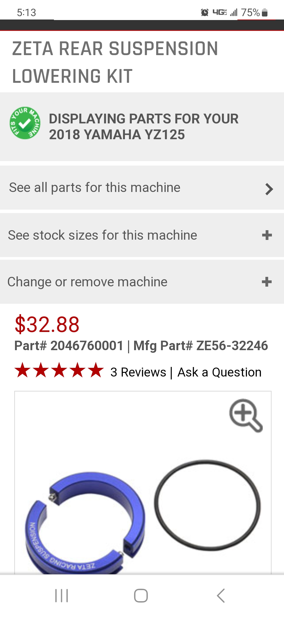

So, I am going to rebuild my shock with nee seals and replace the bumper. Has anyone lowered the rear by internal means? I found a spacer from Zeta for a 2000 kx250. Just wondering if it would fit.

I assume such a product would not work, as it is for a 46 mm body, not the 44 mm of the KDX.
Look at racetech.com to see if their spacers would be suitable for you. They do it differently.
Shop for a new seal head assembly, not just the seals. Just in case you were thinking of rebuilding the stock seal head. The stock steel head is peened over and a nightmare to rebuild.

Ewbarger, I lowered (shortened) rear & front suspension by 50 mm (2 inches). Modifications are internal and reversible. Got my parts, spacers & springs for my weight, from RaceTech. They also tell you good starting points for pre-load. 50 mm is about as far as you can go. It's necessary to shorten front & rear to keep OEM frame geometry. The result is perfect. Lower seat and lower center of gravity, plus correct spring rates makes it so much more fun to ride my KDX.
Re: Rear shock rebuild
Posted: 11:04 pm Apr 14 2023
by billie_morini
Ewbarger, I can't see how that Zeta ring can be used. Here are BEFORE (OEM) & AFTER (shims inserted) photos of rear shock. FYI, the shim stack is not 50 mm thick. It's 16 mm (0.6 inch). The swing arm & linkages provide relationships that factor with shim stck thickness to achieve desired lowering.
