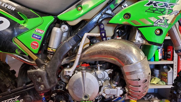

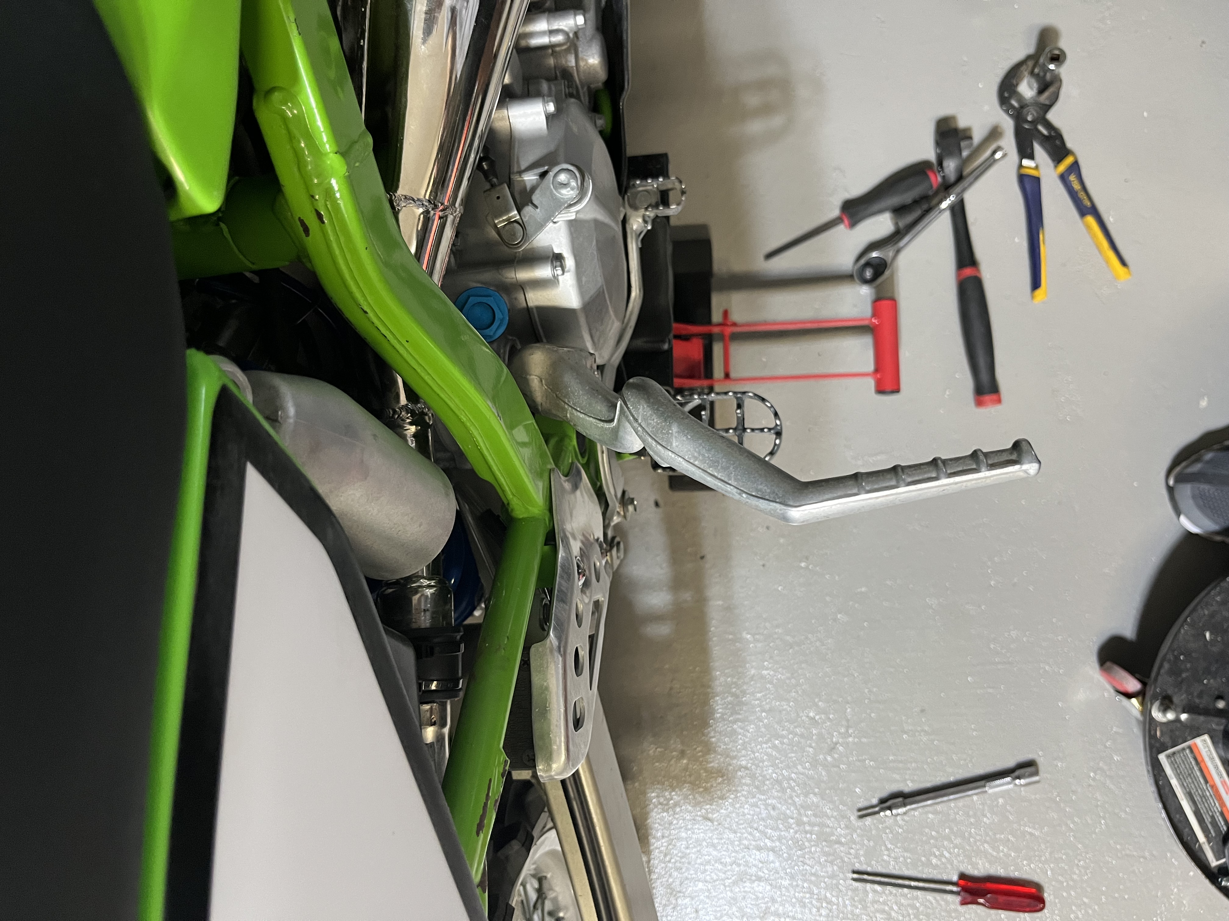

Well, its definitely not a direct fit, but I think its worth the effort. It folds up and sits in there nicely, better than the KX250 or KX125 arms did:
Just a couple issues I am working though:

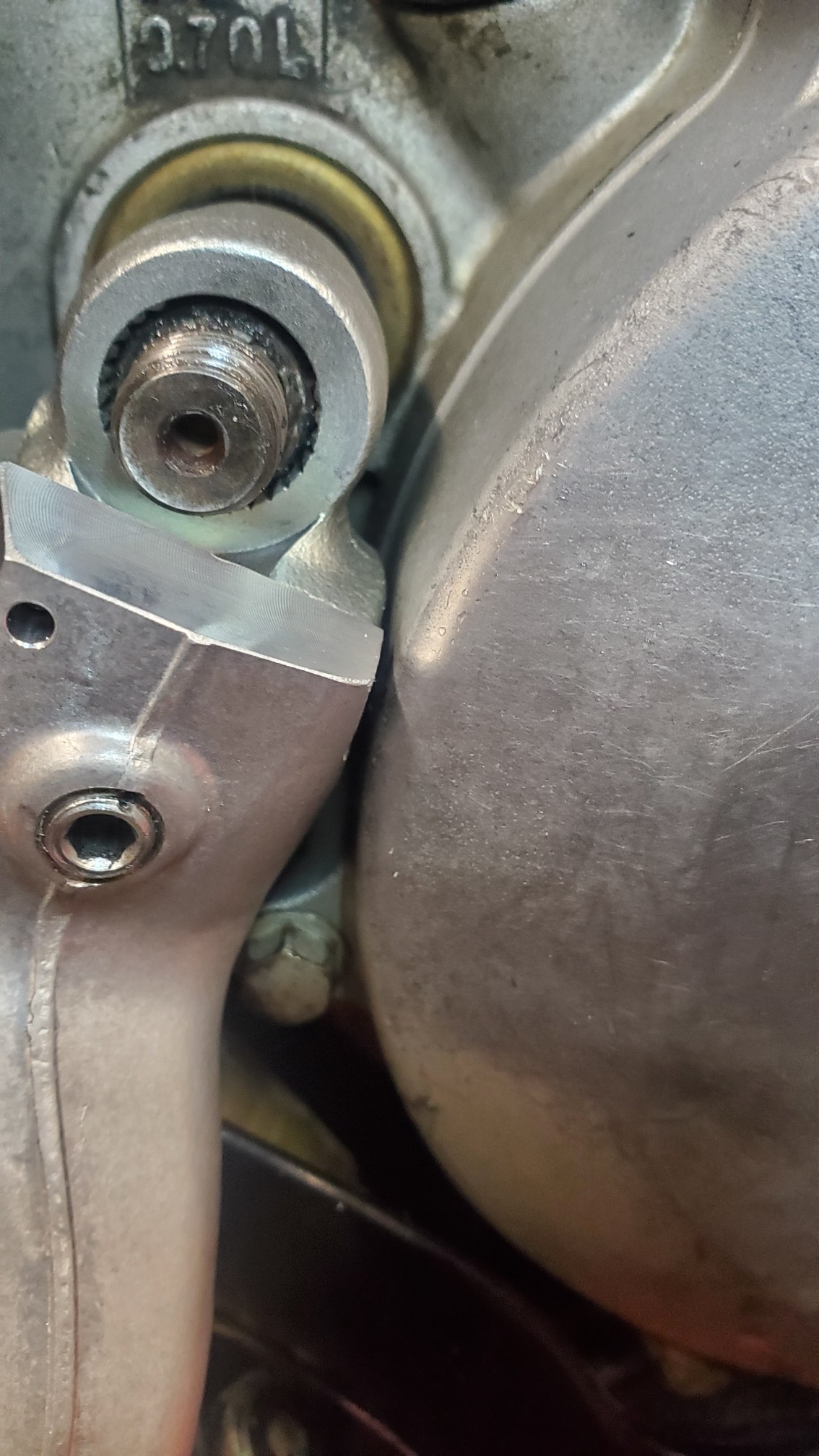

The nut that holds the kickstart knuckle to the shaft, is that normally a 17mm hex? I had mine fall off a while ago and replaced it with a nut I had laying around that's a 19mm hex. There isn't enough clearance around the nut to use a socket or wrench to confidently tighten the 19mm hex bolt. I need to get the right nut I think it will be fine.

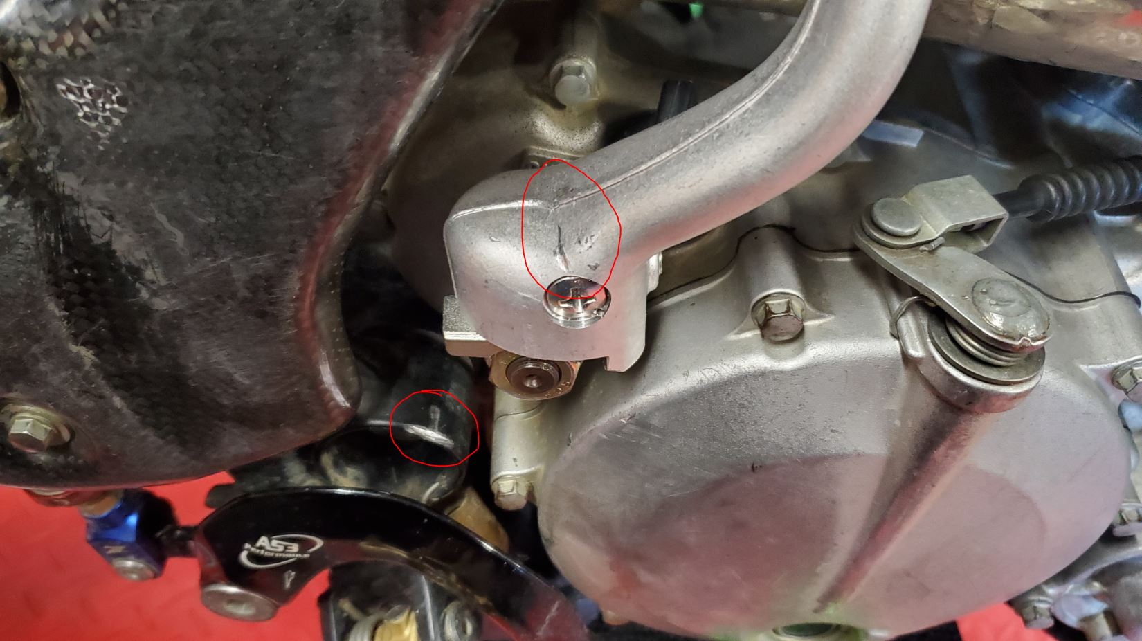

Had to grind/file some of the arm down so it didn't hit the clutch cover when fully rotated. It now hits my peg first, but I still think I'd like to get a little wider footpeg on there to help it even more, gets a little close for my liking.
Also had to do some grinding on the arm in the circled area that was hitting the frame when it went around. Its also hitting my frame guards, will need to trim those too:

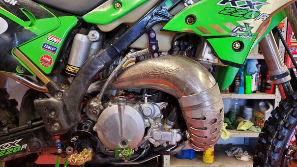

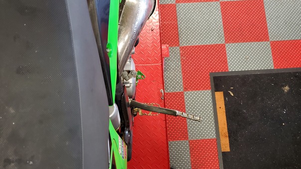

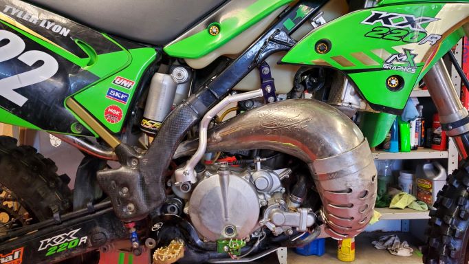

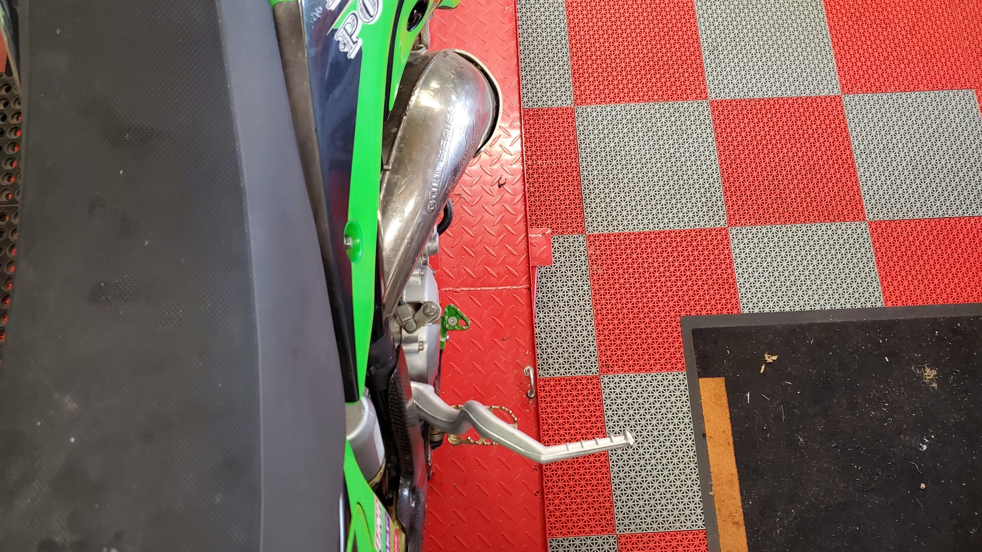

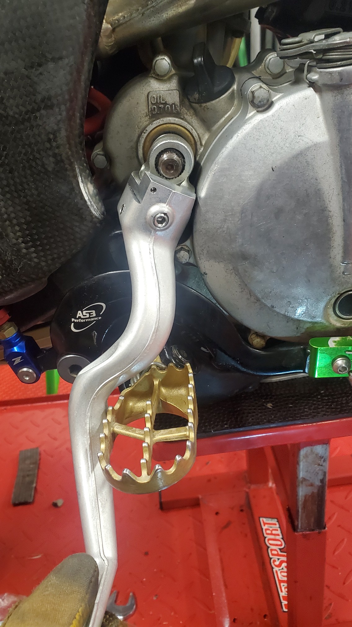

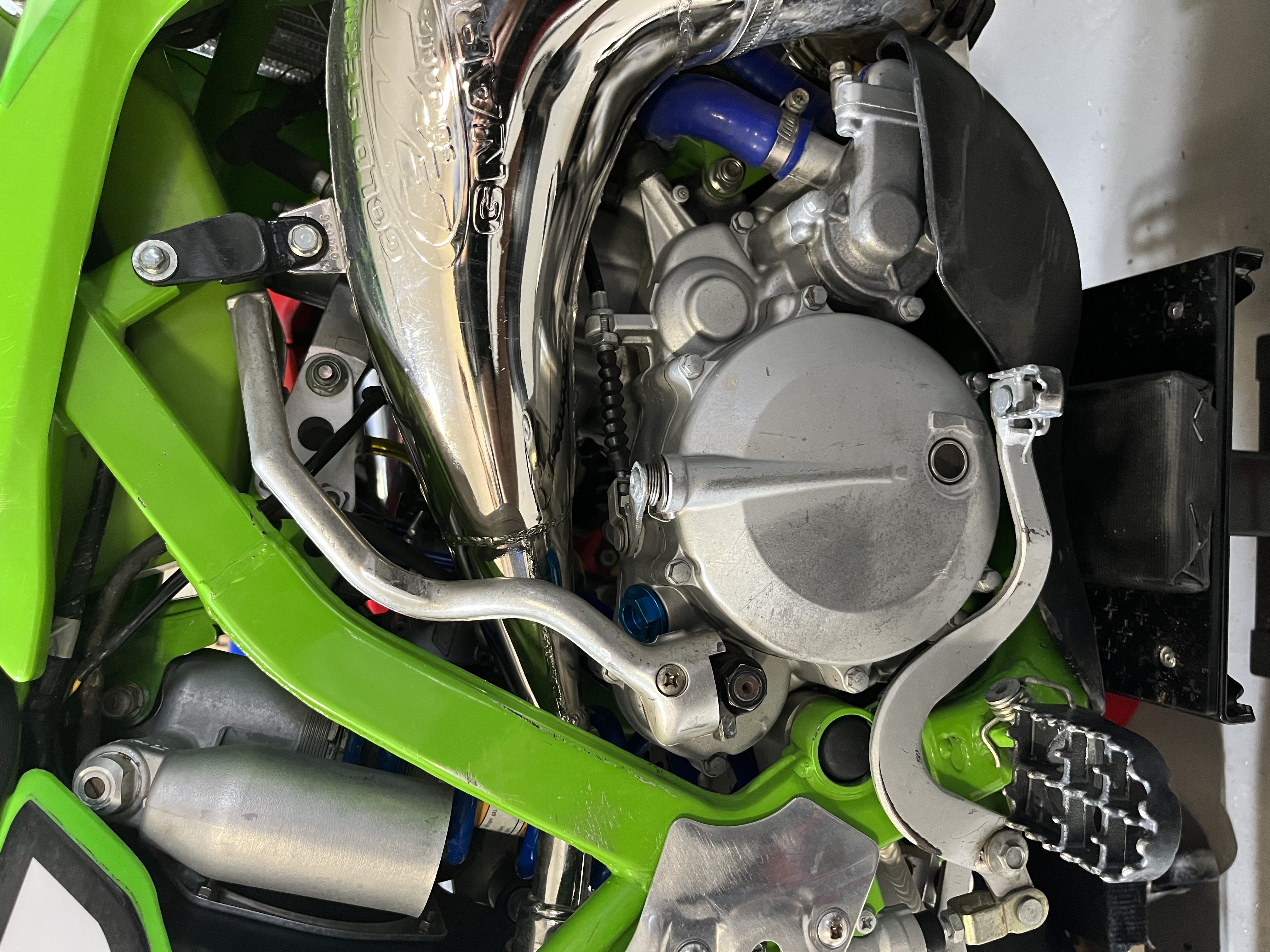

Here's how the different shifters fit, if anyone is interested, keep in mind though, it is with an 05 KX125 frame:
Stock - fits good, but wears out fast, pivot is open at the top for gunk to get into:
KX250 - fits pretty good, has a sealed pivot, like how it doesn't stick out far, but always hits the frame:
Re: KX250F Kickstarter on H-Series?
Posted: 11:31 pm Nov 28 2022
by Tyl3r

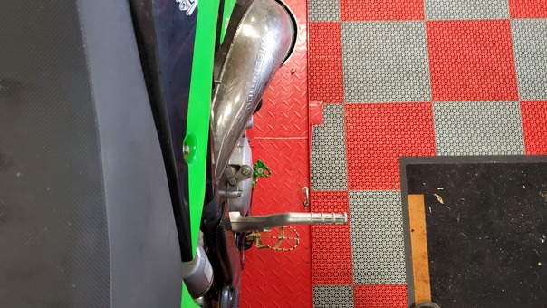

KX125 - doesn't really fit too well, hits the pipe and frame, foot hits the peg before it goes all the way around, has a sealed pivot. I tried really hard to force myself to like this one and I couldn't:
KX250F - Fits nice, does not hit frame, has a sealed pivot, needs some material removal to not hit clutch cover at full rotation. This is my favorite one so far:

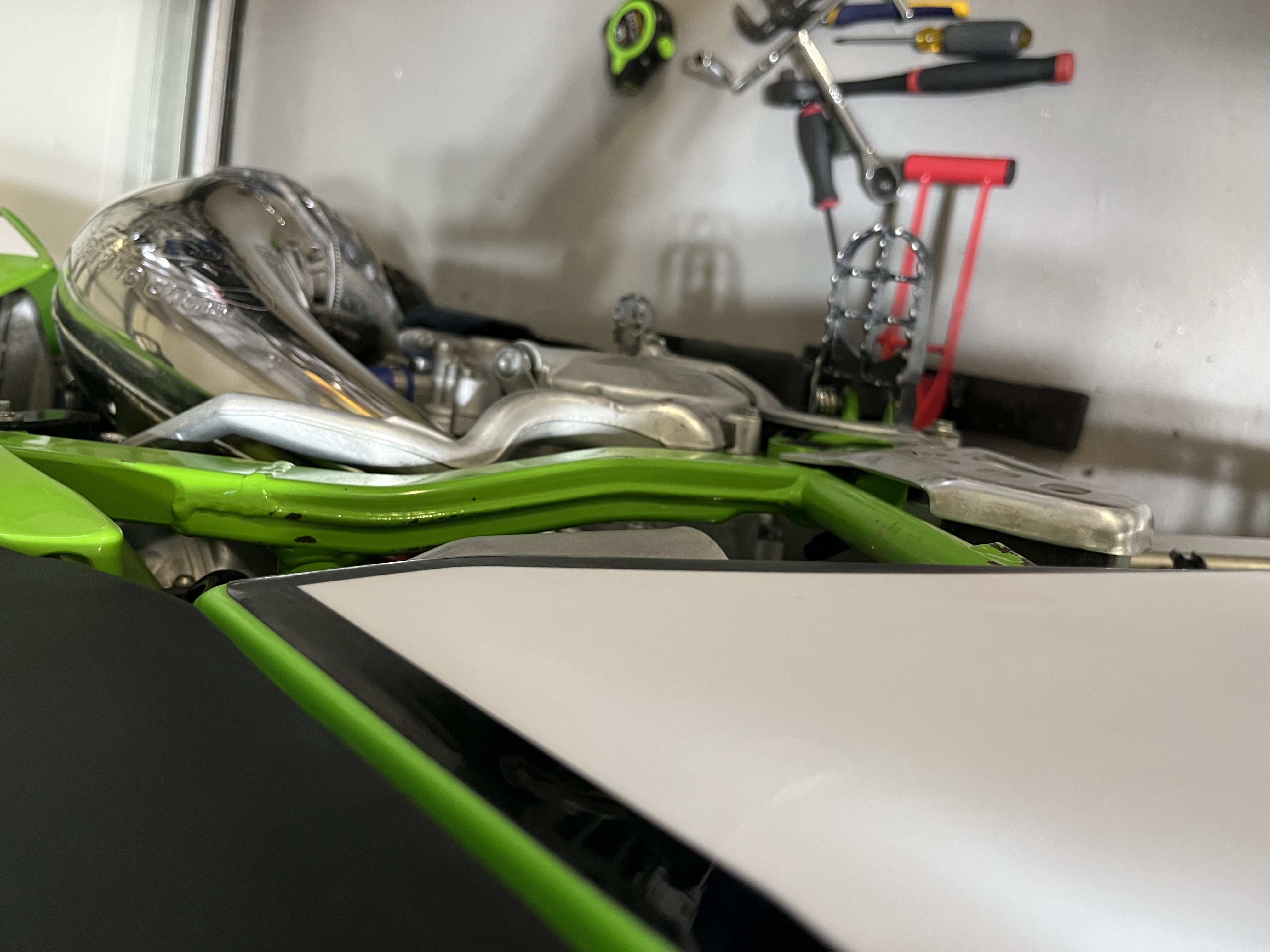

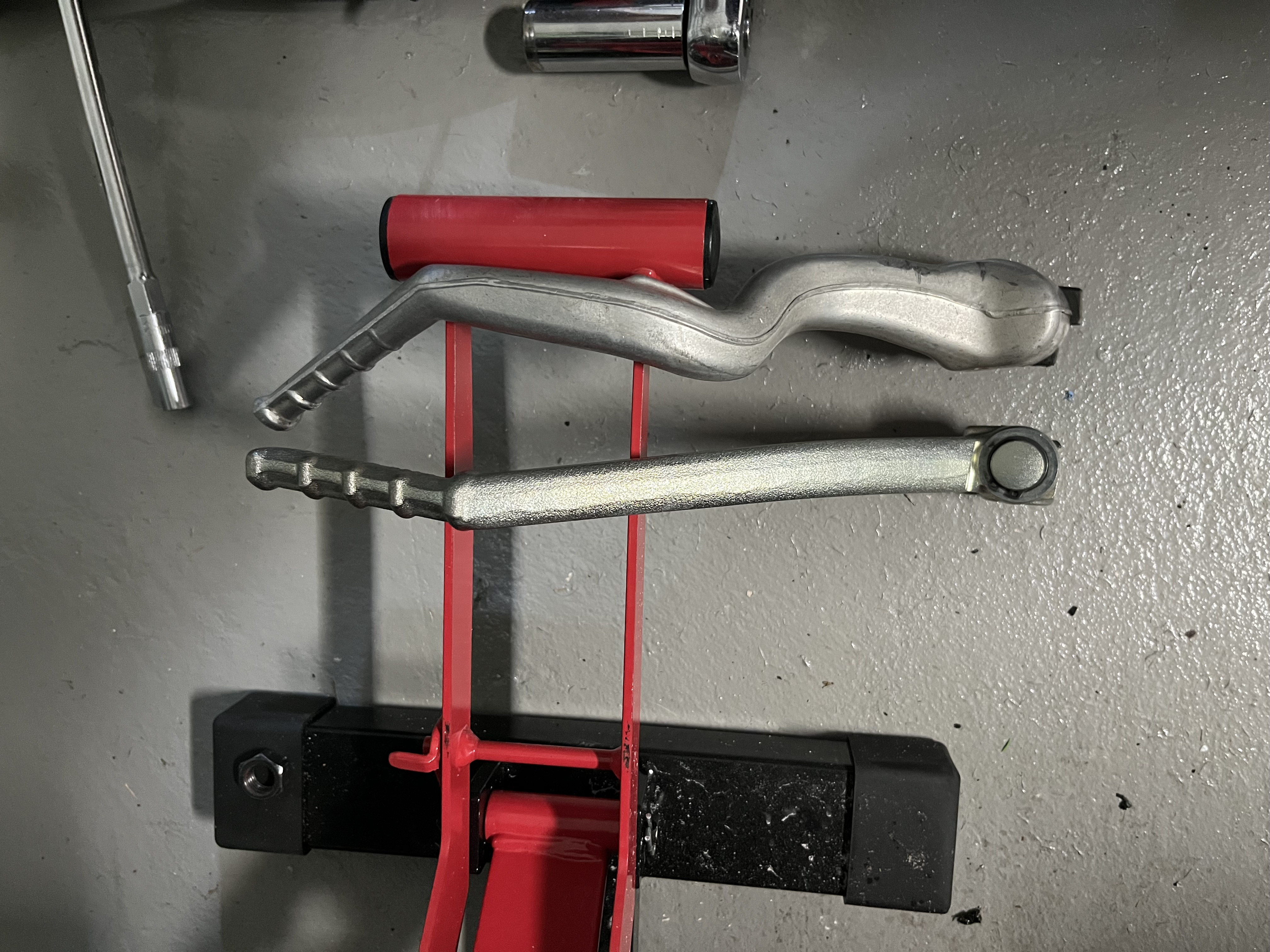

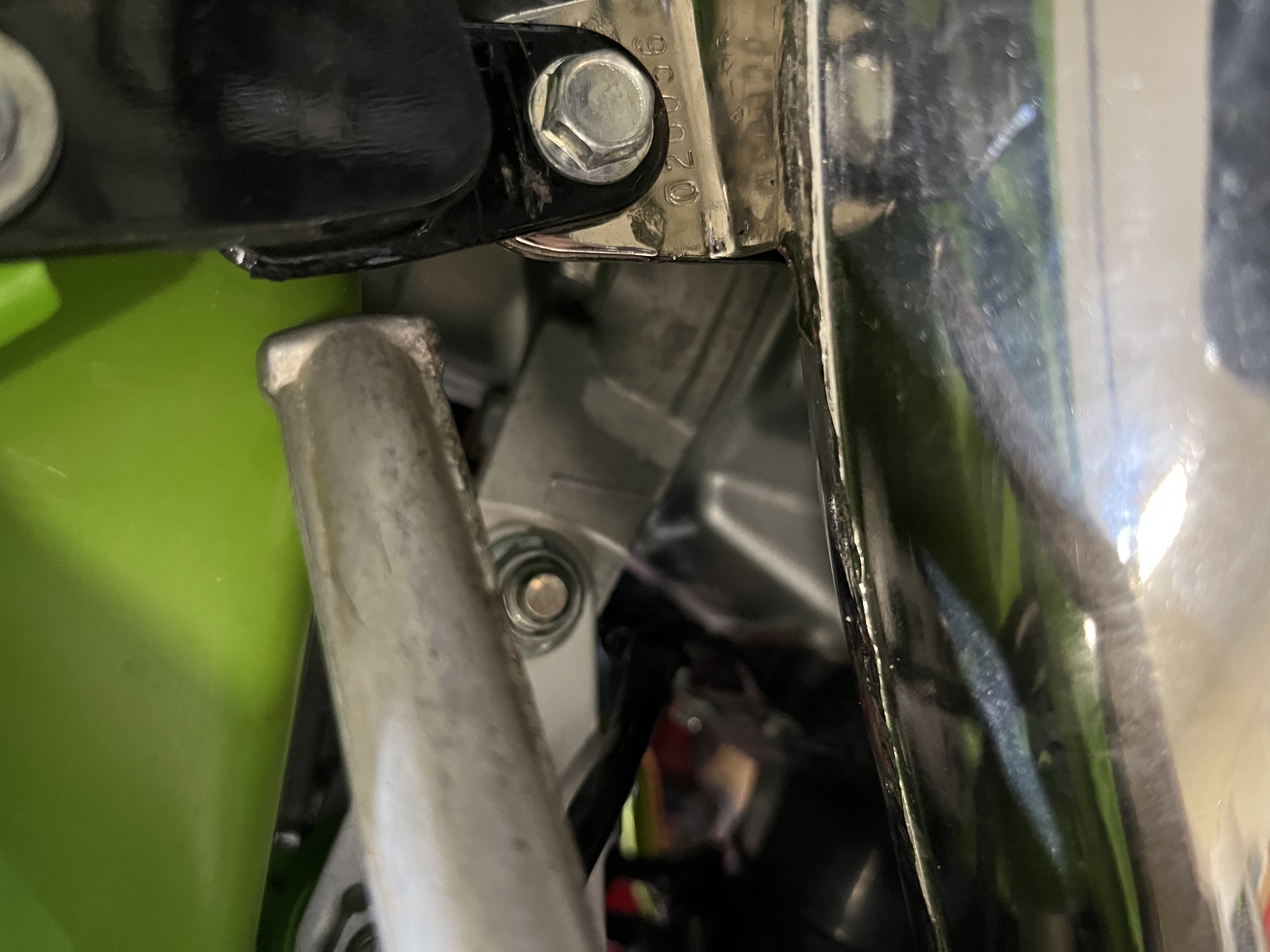

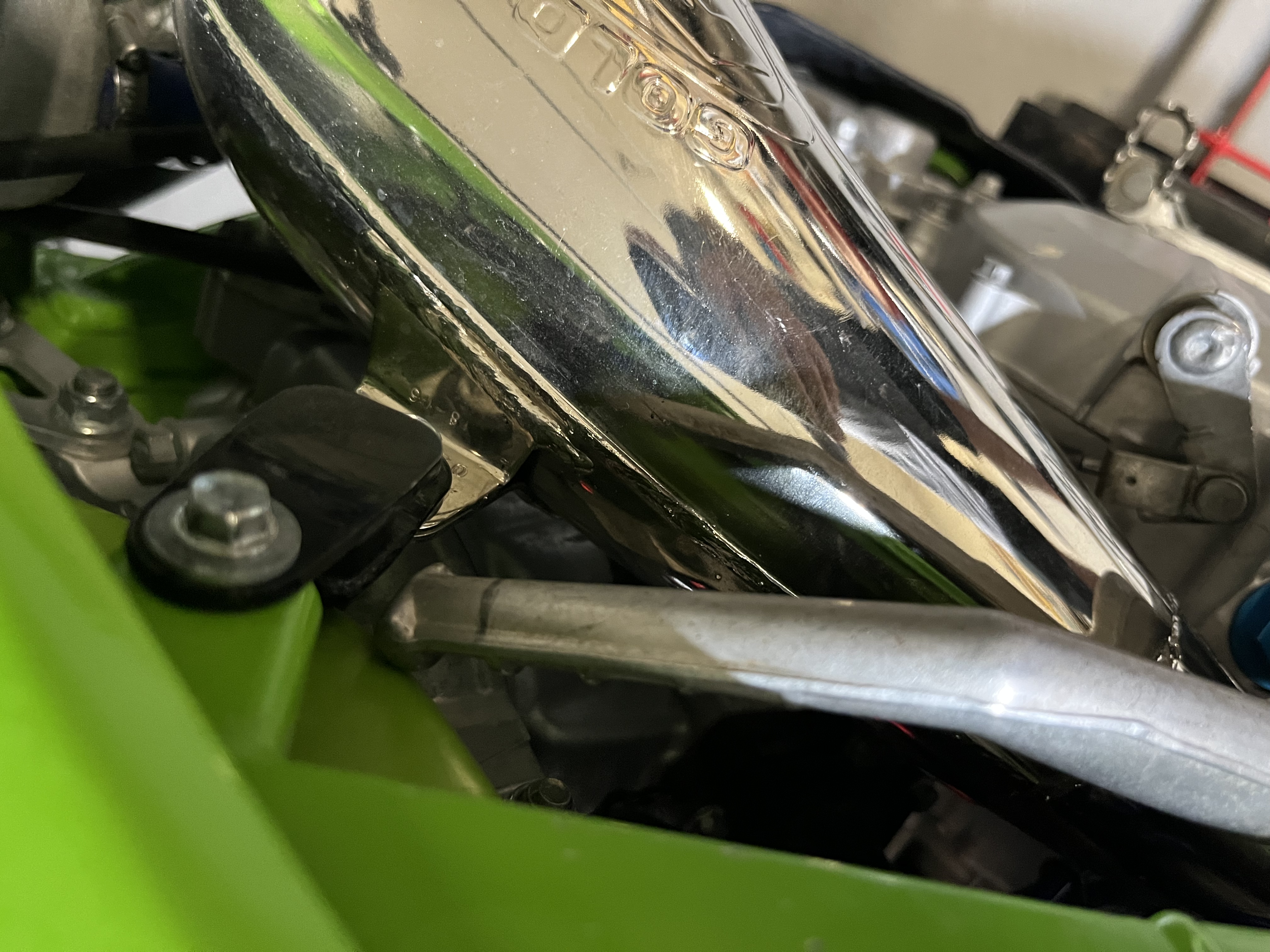

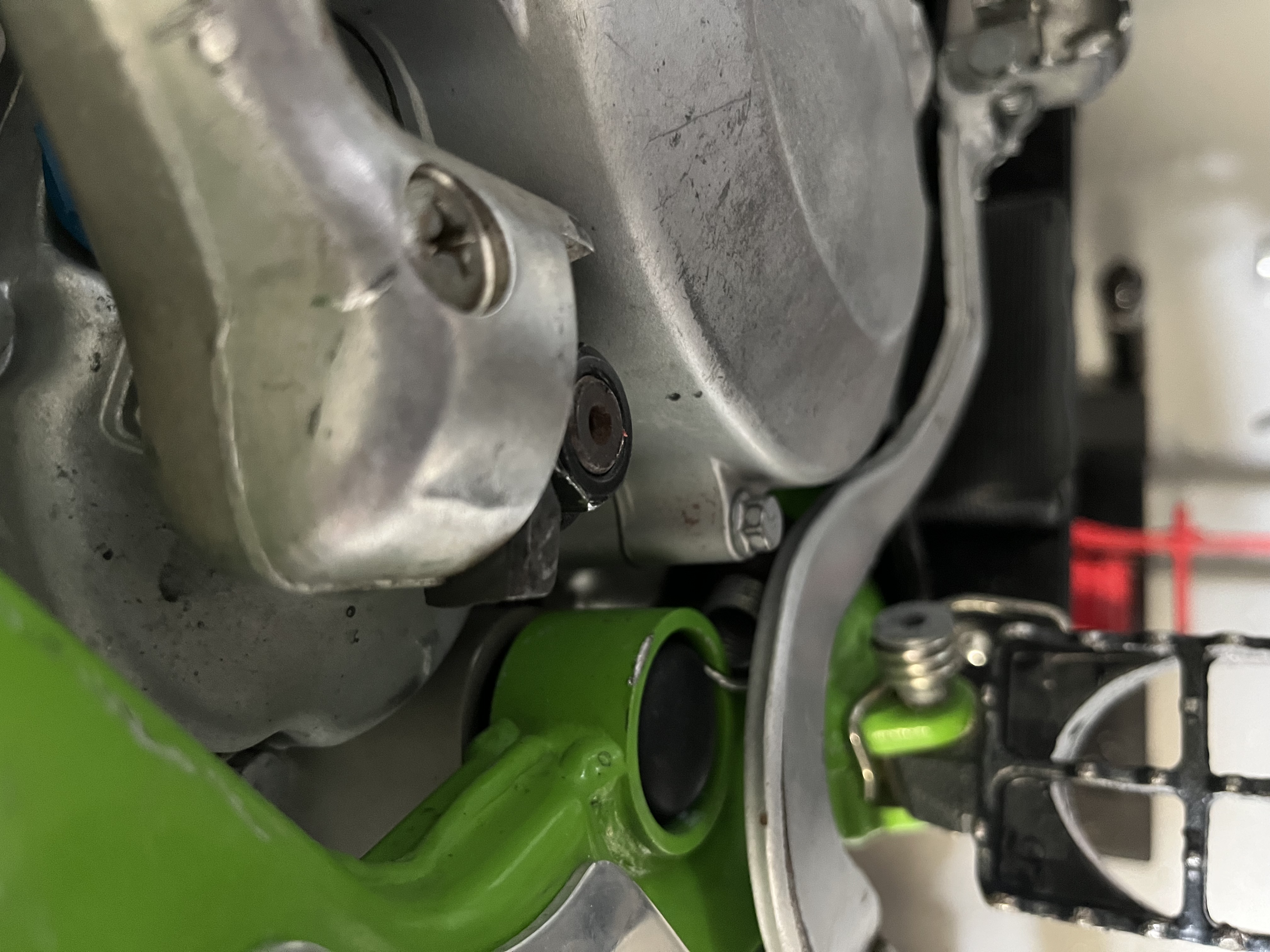

I got my kickstart and it mounted easily but there are a lot of issues so I don’t want to be quoted as saying I recommend it for an H series frame. I’m going to end up making this work but for now it’ll go in a drawer until I feel like messing around with it for an hour or more.
It’s a shame because the curves of it fit the curves of the frame almost perfectly
The biggest problem is that at the EXACT time when it makes it click sound it also hits the gas tank. Even while sliding it onto the splines it hits the tank early on.
When you see how the fat part of the kickstart is proud of the frame it makes you wonder whether a fall onto a rock or root would then put enough pressure to crack the tank
You see the pencil mark I put on it? It looks like if it cut it there it would have a chance of not hitting the tank but it’s harder to tell in person than in the pictures.

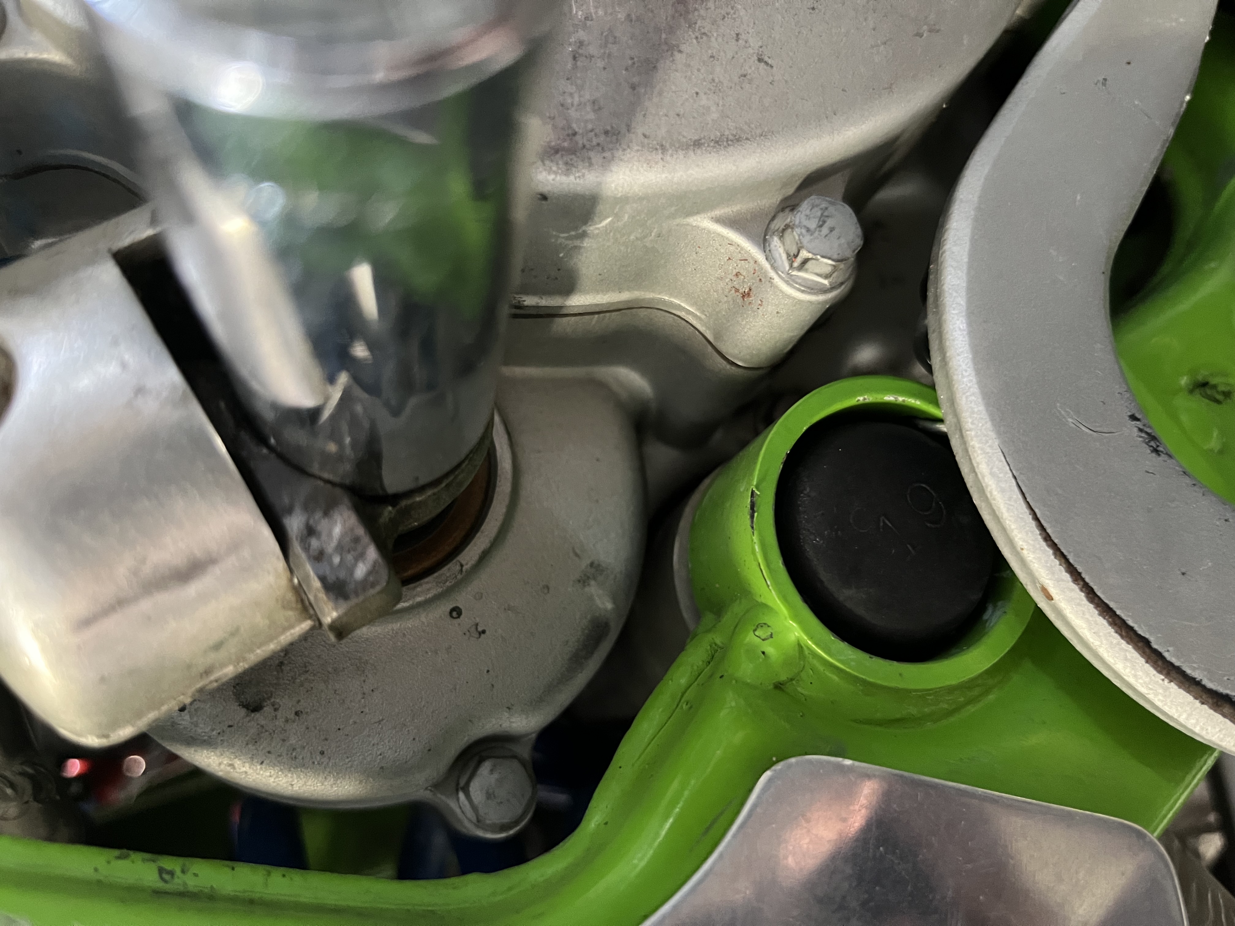

Then there are the issues that Tyler talked about. The first one being the nut. I have the factory 17mm. Even a thin walled socket gets jammed in there when you tighten it up. I had to wiggle the socket out with channel locks. It only hangs up on the upper right 11:00 position so I think I could take care of that by relieving a little of that material in the picture, or beveling a cheap socket a little. But it gets wedged really hard in there.
The next issue is that the kdx boss is 3mm thicker than the KXF boss so you have to add a washer or two on the backside. The problem with that is that the inner diameter and outer diameter have to be almost the same size (like a metal oring type washer) in order for the kicker to go into the closed position. The point of the lever in the 11:00 position is closer to us than the boss looking at this picture so the point has to clear the spacers.

Like a lot of things we mess with, it’s so close and yet so far from being considered a bolt on. Tyler mentioned a couple more things and it’s the same thing on the H frame. One is that lever skims the frame when going down about 3/4 of its travel. You can see in this picture the little scrape on the lever by the Phillips screw and the paint missing on the frame. It’s so slight that a couple of slow hand kicks almost scraped enough clearance. This is a quick 5 minute job to take care of with a little slice from a cut off wheel on the lever like Tyler did. PS the nut isn’t tight in this picture.
Then once it gets past that the a point on the lever hits the clutch cover before the lever hits the peg. This is also a quick job with a grinder.
It sticks out from the frame the same amount as the stocker when you go to kick it. About 8”. Like I mentioned early on I’m going to get this to work someday but I’m not excited about fiddling with it. I love the slight forward angle where you put your foot and this one is well used and there are no signs of damage on the lever or the boss where they press against each other. Everything is nice and tight. If this thing sat about 1/2” lower it would’ve snuck in right under the tank and I wouldn’t have much issue with the rest (other than finding the right 3mm spacer / washer / metal oring). Here are a few more pics.
I think if I keep 4 of the ridges for your boot to ride on the cut off the 5th one with the knob on the end it has a chance of clearing the gas tank. Hitting the tank is the one thing I can’t get accept with this set up. The last need you need is a crack in the tank right above the hot pipe.
