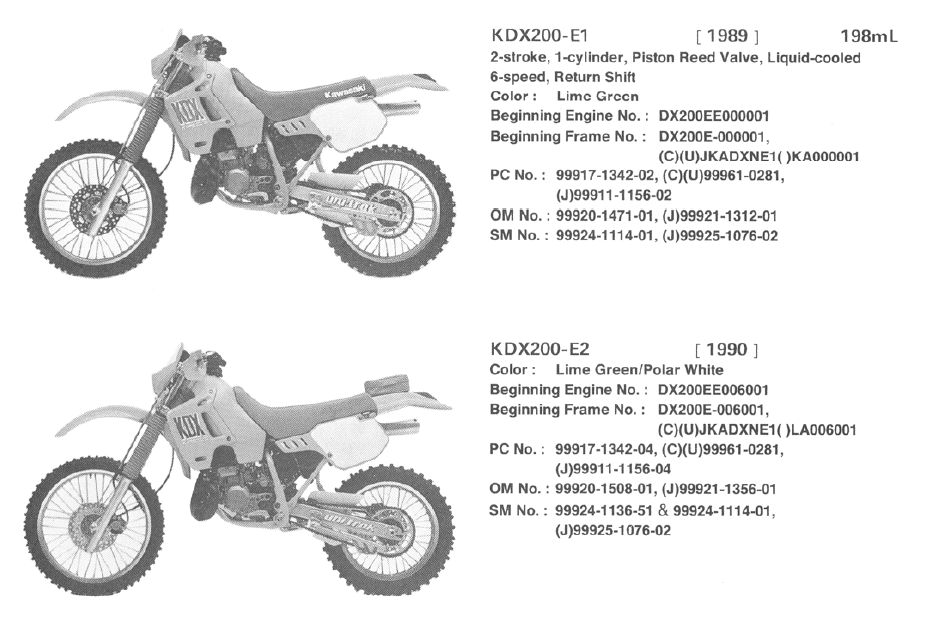

My numbers on my kdx 200 frame are DX200E-003574 and I was wondering if anyone could figure out the year from that got told it was a 1990 I'm just not to sure.
Re: Kdx 200 numbers
Posted: 11:48 pm Jun 12 2022
This is from the dealership manual Model Recognition Manual.
1989
Does it have a lime green shock spring?
