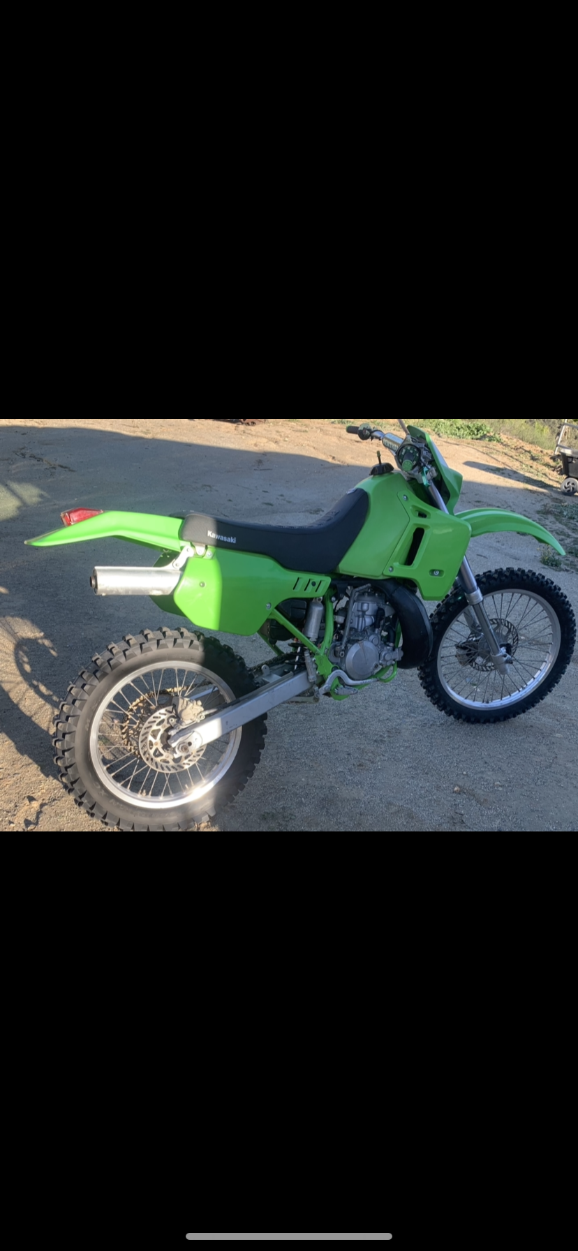

No longer a lurker, just picked up this KDX and I can’t wait to tear it down and prep it for a south of the border event. Anything I should be aware of as potential issues for they year? The big bonus is this bike is California plated. [album][/album]

Look through some old threads on how to check the KIPS power valve system. They break over time. The gear teeth get stripped off. It will keep it from having higher RPM power.
